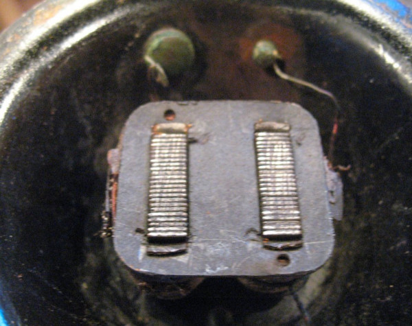

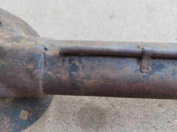

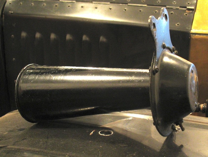

Got a question, is the battery horn's diaphragm the same diameter as the magneto horn and can it be used as a replacement? I know this seems like a stupid question, but I need to ascribe a part number to the diaphragm and the only one I can come up with is the one for the battery horn.

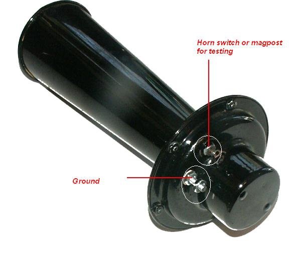

On and one more thing....on the magneto horn, this picture shows the ground post as having a fiber washer a nut and a jam nut on this post....the other post is labeled "Horn Switch or Magpost for Testing"? Is this correct? I would seem to me that if you're going to have an insulated post it should go to the high voltage (magneto) side of things rather than the bloody ground. Since I really don't know much about these types of horn, I thought I'd ask you guys....I need to know so I can get the drawing correct (the first time, which would be a novel experience, lol).

The magneto horn diaphragm has an adjusting nut and boss in the centre. The battery horn is a pain disc. They may be be the same diameter, but I doubt they can be substituted and operate properly.

IIRC, the magneto horn should NOT have an insulated washer, as it is grounded through the bracket. The only wire coming to the horn is the hot wire coming from the button.

Keith, that's why I think this photo is mislabeled when it comes to which side is the hot side....made absolutely no sense that the ground wire would've been an insulated post. This not my photo, somebody sent it to me to show how the mag horn was supposed to be wired thanks for the correction.
Allen, yes there is a nut in the center of diaphragm on a magneto horn, but there is nothing stopping somebody from using the batteries horn diaphragm either if it is the same diameter, because it certainly must be the same thickness. All you'd need to do is scribe out where the center of the diaphragm is and drill a hole in it and then install that adjusting nut that is sold from the parts vendors and you're done....certainly has enough hole along the outside to accommodate just just about any horn with the same size diaphragm, probably would even fit a Model A's Sparton too, they're about the same size as I recall.

I can't seem to find my copies of wiring diagrams, but I am 90% certain the early magneto horns required both post to be insulated, as the horn was wired "hot" with the steering column mounted horn button providing the ground. The wire tube on the early units was a small tube that held one wire. Later on this tube was replaced by a "U" stamped metal piece that could hold two wires, and also for a time, the headlight wires too. The early horn button was fastened to the top of the steering tube with two screws, one of which clamped down on the ground connection brass strip from the button contacts.

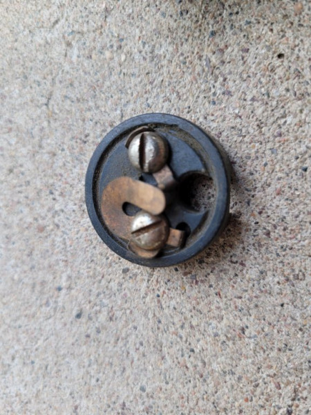

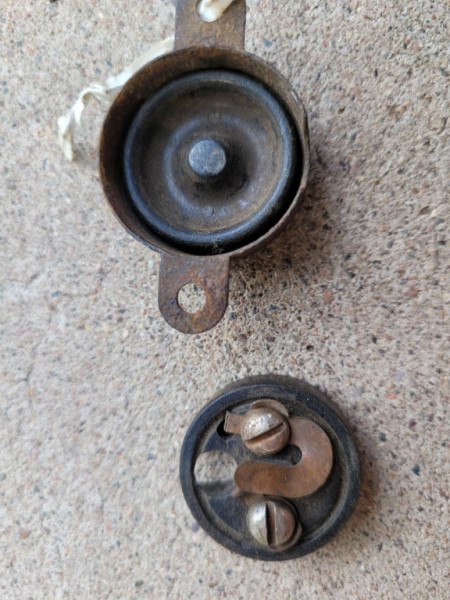

If the magneto horn only has one wire is the photo above wrong? Asking because I purchased a mag horn from a member on hear and should be at my home soon. I hope to install it in the next few days on my 1915 Touring.KWTownsend wrote: ↑Thu Sep 16, 2021 11:36 amIIRC, the magneto horn should NOT have an insulated washer, as it is grounded through the bracket. The only wire coming to the horn is the hot wire coming from the button.

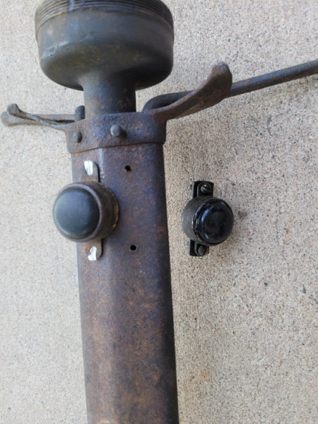

Ron, If your car has the column mounted button that is held on with two screws and is on a top side of the column, with only one wire going to the button, then YES, the photo is wrong! The horn button provides the ground circuit and the hot side comes from the magneto.

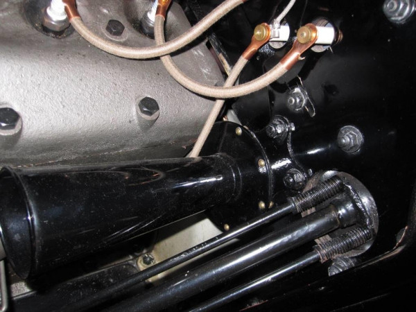

It is impossible to ground the horn through the bracket like somebody has said, because that bracket mounts to the firewall and the firewalls are all wood, were clear up through the middle of 22.
Now the single post magneto horn may be for the metal firewalls for those vehicles that were called the "Non-Electric", these vehicles were typically commercial, that's why I've got a drawing of the 26-27 switch with the ammeter
and without one.
These vehicles probably had the single pole like "Heco" brand horn (they have a sort of conical style back shell).
I don't know for sure, but it seems logical, since they are single pole which would indicate that ground is through the horns shell and the bracket or through the switch. The other photo shows one side of the leads soldered to a post and the other to the back itself.
and without one.

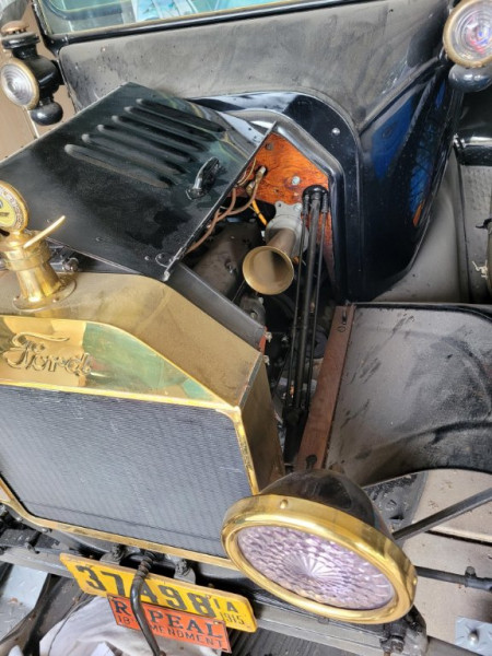

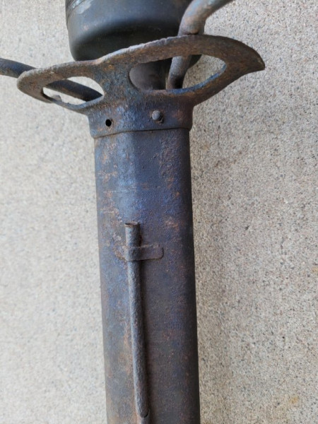

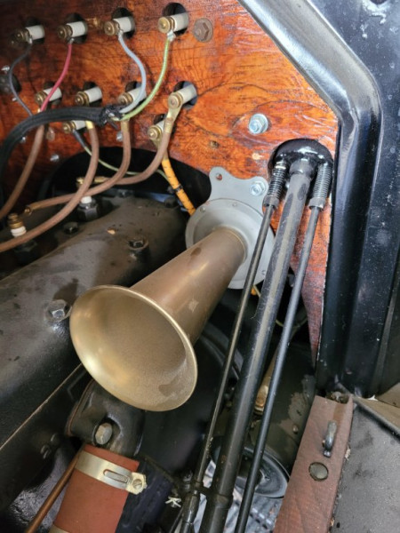

I dont think this is correct: "It is impossible to ground the horn through the bracket like somebody has said, because that bracket mounts to the firewall and the firewalls are all wood, were clear up through the middle of 22."
Instead I think the correct answer is that the 1915 mag horn is clearly and directly bolted to the steering column where the horn button is screwed down, and the column housing grounds the horn system all together.
There are 2 screws affixing the horn bracket in the engine compartment to the car, and admittedly one of them is screwed into the wood (firewall), but just for additional stability, but not as a ground. The other affixing bolt grounds the horn to the steering column to which the steel horn button housing makes contact and is screwed down on. So that may be where the confusion comes in as to where the ground is located.

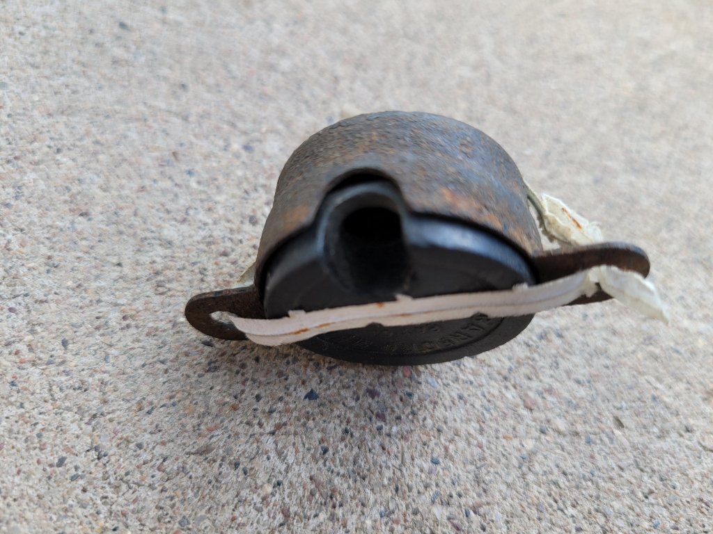

I have had a variety of 1915s over the many years, and the horn system on the about 10,000 brass bell mag horn cars they built is somewhat confusing, so some photos might help. There is just one horn wire out to the horn from the button. I think the brass bell mag horn cars were all built in Jan.1915, as I recall, but I can't quote you a source and I certainly could be wrong as I wasn't there. But that seems to be pretty consistent with the dates on the authentic mag horn cars or chassis I have seen. And it is fairly tough to find a real 1915 steering column. The wire tubes on the 1915 columns are designed differently a than the later year car horn tubes, so you really can't cheat and use the horn wire tube from a later column and put it on a 1915 column if you are a real authenticity bug, but I have actually done that to give the horn wire some protection going out to the horn. The 1915 tubes were really sort of experimental, and had more welds and parts tacking things together. Ford cleaned up the wiring covers in later year productions and made them with fewer parts, and the welds on the later ones were different from the 1915 horn tubes.
I will try to post some photos explaining this:

Allan, hmmm, interesting, I never could figure out where that damned bracket mounted....off the steering column would be a great place, although it looks like it makes getting to the wiring a bit more cumbersome though. I think I've already done the horn buttons though...hmmm, maybe I should link those drawings up to horn drawings, hmmm.....got to cogitate on it some.
Dan, thanks, John explained pretty good, myself I don't even have an electric horn on my car, I've got a hand klaxon, which doesn't care what voltage the car runs on and it much louder than those mag horns or the electric ones, plus it sounds like it means business, rather than that strangling a goose sound.
