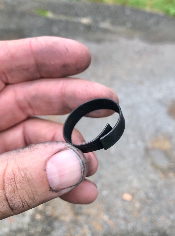

Mark discovered the cause of his mystery noise, but decided to post the answer in it’s own thread…
viewtopic.php?f=2&t=23715
The answer was an exhaust manifold gland ring that came loose and travelled down the exhaust pipe and ended up caught at the muffler.

Yes, an exhaust manifold gasket gland worked its way down the exhaust pipe. It was about 1” from the end where it meets the muffler.
