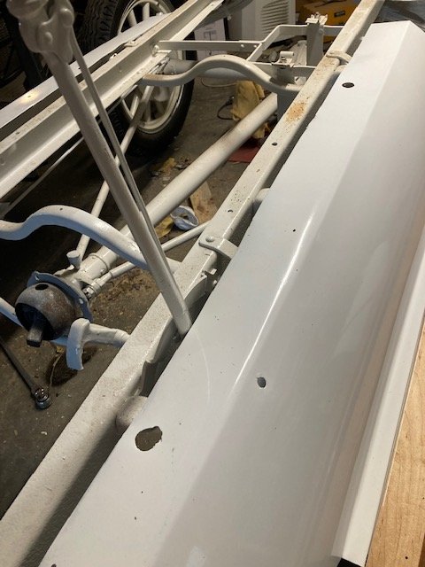

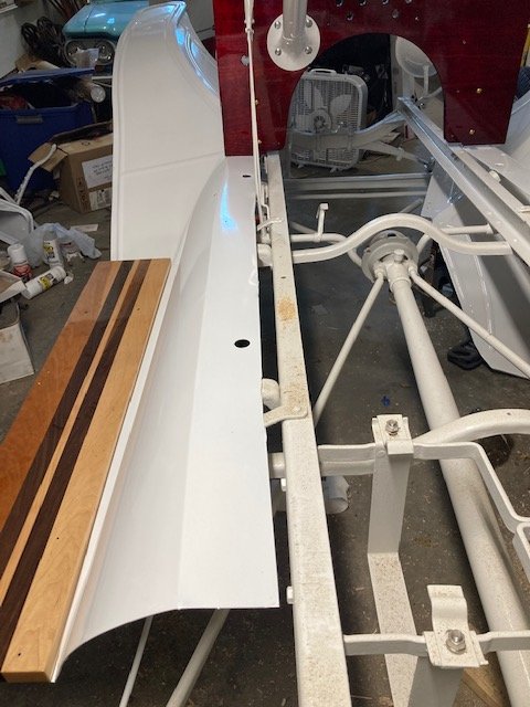

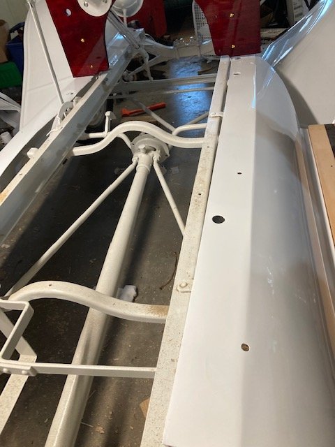

I am fitting the skirts for Hay wagon to Speedster project. It is a 26-27 frame, I do not know what year the skirts are. Do the skirts go to the edge of the frame or more than over the frame? If more over the frame than not, how much? I am going to have to cut out a notch for the brake quadrant right? Is the passenger side skirt supposed to be straight? It seems to deflect some. What size bolt and nut do the body hangers/mounts take?

Ignacio, If you had a pre 1926 frame the large round holes in your aprons would line up with the body mount brackets. On the running board side of the aprons the metal channel would go under the inside edge of the stock running board. Did you put a groove in your wood running boards for the apron or bend the apron channel down to use wood screws into your running boards ?
In any case you can mark a line threw the center of the large apron holes and then mark where the center of the 1926 body brackets cross that line, this should position your aprons ok to drill the body / apron mount holes.
Now you can place the wood running boards at the edge of the apron and if all looks ok you can mark the boards for the running board cross frame bracketl to running board mounting holes. Make sure to check the fore / aft fit of the running boards and aprons with the fenders. You will have to do some fitting and adjusting to get it all to come together the way you want.

The edge of the splash panel is usually in line with the outside edge of the frame. Is that the finish coat on the paintwork? It seems a shame to cut and drill them to make them fit now. The holes at the body/frame mountings are oversized as shown, to allow the panels to fit in position as they want to sit rather than putting them under tension with neat holes. This also helps greatly when assembly time comes around.

Kevin the aprons came to me with a flat tongue where it goes under the wood which is pretty much exactly what is needed so I didn't have to do anything to them on that score. You answered my next question as to if/how to attach them to the wood using wood screws. I was wondering what to do about that.
Great idea to just draw a line on the existing big holes and why those holes exist. It is finally coming together!
