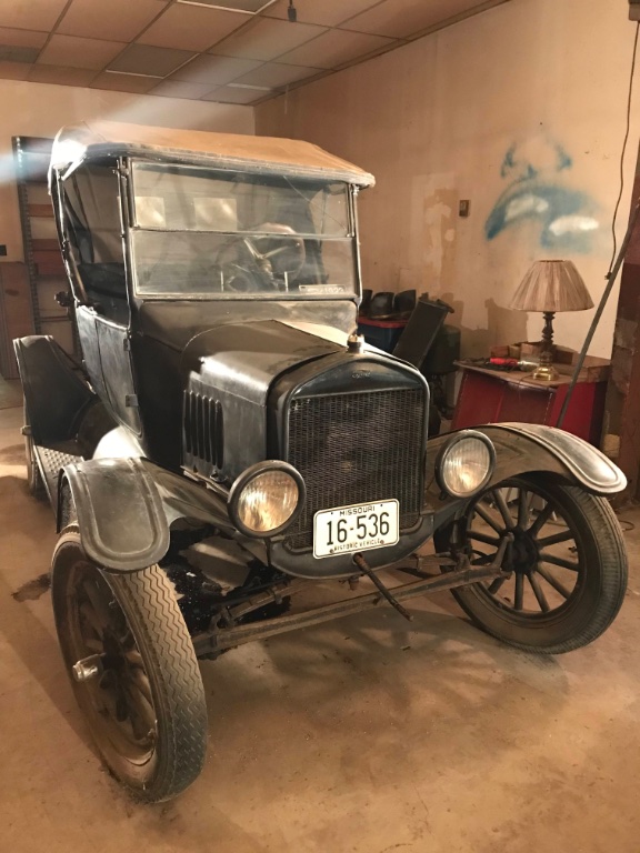

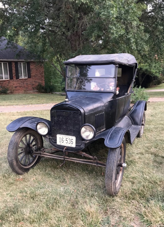

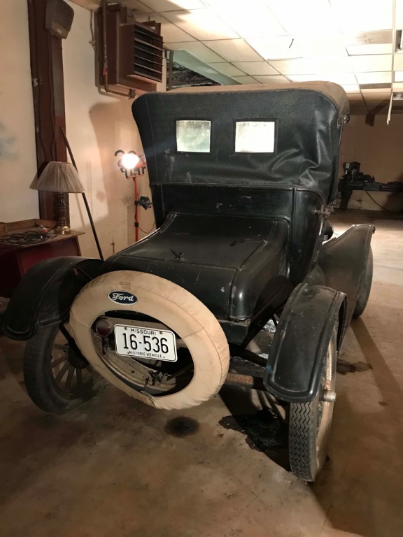

My dad found this car being sold from an estate and we hope to have some fun with it. It was a runner when parked so far as we know, but has sat for at least five years. A complete spare chassis was included that appears to be in fairly good shape, so we have plenty to mess with.
The engine serial dates to December 1923. Curious as to what we have here, and how much is original. First step is getting some tubes that hold air for a couple tires; what's a good source for 21" x 4.4 tubes? Next step is going through the usual deferred maintenance.

Welcome! Looks pretty original, I would say a 1925 roadster. If you can provide the engine number I can give you the date the engine was assembled. That engine number should be the VIN that matches the title (if you have one).
In the meantime, here is some light reading:
http://dauntlessgeezer.com/DG52.html

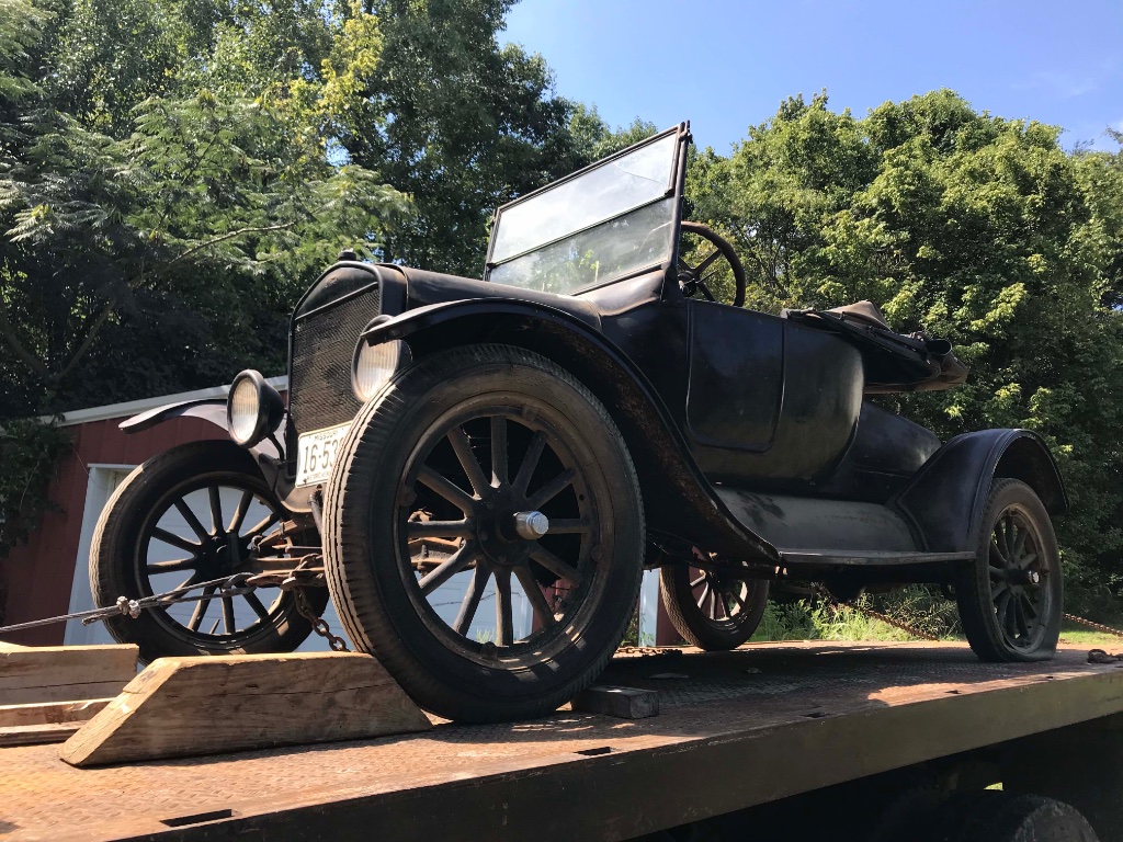

Welcome to the Model T world.
It looks like you have a nice car.
I noticed in your pictures that you have the car tied on to the trailer with a cable/ winch. If you tied it around the axle and not the frame please check to make sure you didn't pull the wishbone out of the ball socket on te oil pan.

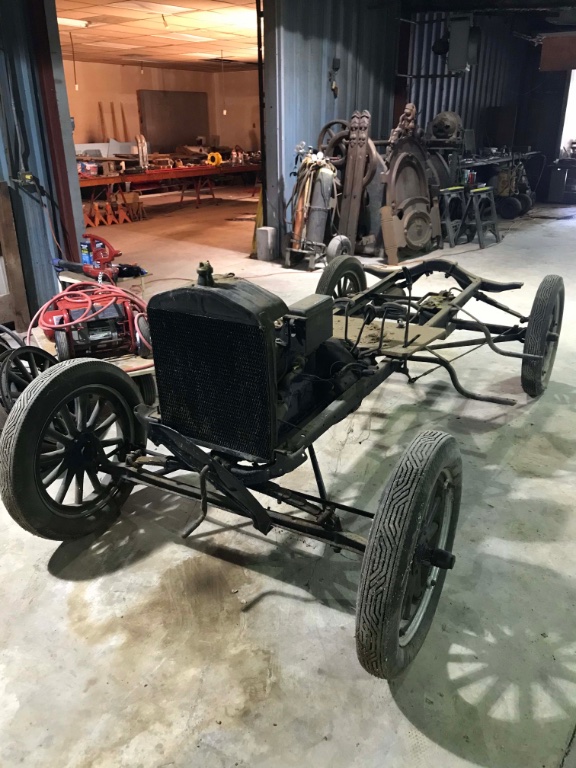

Welcome! I don't know how the fuel system would be on the car you bought. Two cars I have worked on for others which were parked here in California, had to have the fuel line replaced and one also the gas tank. The one I replaced the gas tank had been parked for 19 years. The gas became like epoxy and plugged up everything. I was able to get the carburetor cleaned up and running. Changed the oil and put in a new battery and it started right up. It had green anti freeze in the cooling system and believe it or not was up to the normal level and I did not even change it until I needed to replace the fan belt and noticed the crankcase pulley was very loose and worn out, so I removed the radiator and flushed it out and also flushed out the block. I am just putting the radiator back on today, so don't know how it runs right now, but it did have some "knocking" before I replaced the pulley and hope that fixes the problem. The owner had been on a tour and the car made a very loud noise so they parked it in a storage unit owned by a friend and at sat there from there on. He has since passed away and his wife wants me to get the car going again. I think I found out what made the "loud noise" because the exhaust pipe had come off the manifold. That was one of the first things I fixed.
Anyway, you need to find out why the car was parked, if you can, then maybe you can fix that problem and it will run fine again.
The left front tire on that chassis, looks like a INSA tire Hecho en Chili. If it is, you have one of the longest wearing tires ever made for a T. I have 4 of them on one of my T's and they have been on it for 30 years and the sidewalls have not even cracked. I have taken that car on quite a few week long tours.
Anyway, have fun with your car.

Yes, tires on the chassis are marked INSA, and there's a full set plus spare. I think we'll swap those over; they look unused and have been in a dark garage for years. The tires on the car are Allstate, and have a fair amount of cracking.Norman Kling wrote: ↑Tue Sep 21, 2021 4:22 pmThe left front tire on that chassis, looks like a INSA tire Hecho en Chili. If it is, you have one of the longest wearing tires ever made for a T. I have 4 of them on one of my T's and they have been on it for 30 years and the sidewalls have not even cracked. I have taken that car on quite a few week long tours.

Do not be overly hasty to spend $$ to replace your tires right away. A new set may very likely look like the old set in 18 months with "a fair amount of cracking".
Lots to learn.
Have fun.

According to the book "Model T Ford, the Car that Changed the World", engine number 8912386 was one of 8065 engines assembled on December 21, 1923. If it's the original engine to your car, that would make your car a 1924 model year.
1924 and 1925 cars look very similar. In 1925, 30 inch clincher tires were still standard, but 21" balloon tires were optional and the bodies had a little more metal in the understructure in place of wood.
Here is more info on 1924 model year cars: https://www.mtfca.com/model_t_encyclopedia/1924/

Looks like a late 24 or 25 Roadster in pretty good shape. The lips on the front fenders just under the headlights make it a 24-25. Looks like it was repainted years ago and that’s OK. It’s close enough to be a 25 just giving it a general going over by your pics. The larger 21” tires came out in Late 24 to give a T a little smoother ride. I have a late 24 Coupe that has them and it does make the car ride a little smoother.
If the engine number is in the 23 range I wouldn’t worry about. Lots of T’s have earlier or later T engines in them that were replaced down through the years. Reason being is that they pretty much all interchange in that part of the T era. Good luck with you ‘new’ T!
I would get it to going like it is after checking the oil, water and brakes and see how it drives.

Micah, Welcome to the affliction, I hope you have as much fun with yours as I have with mine. It looks to me that your spare chassis is an Improved car meaning 1926-27 it has the coil box on the engine and the wide pedals for the clutch and brake plus the wider rear crossmember. Good start for a speedster! Jim

I second checking the ball joint on the wishbone. It needs to be fairly tight and the cap needs to be secured to the oil pan with studs and castellated nuts which must be safety-wired together. Do not use cotter pins. If you are going to winch the car I would recommend attaching the strap to the front frame crossmember and not the axle. As to the coils - If they buzz when the key is turned to Battery, they will probably provide enough spark for the engine to run. Be aware that the coils only buzz in certain crankshaft (timer) positions, so if at first they don't buzz, turn the crankshaft a bit with either the starter or the hand crank. Since the car has been sitting for a long time, at some point in the future I would recommend having the coils gone over. There are several businesses that do this that advertise in the MTFCA magazine. Welcome to the affliction!
