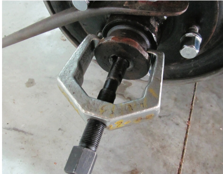

If you are using a Ford hub puller that screws on the hub cap threads and has a bolt that screws thru the end, it is a combination of tightening the bolt and hitting the bolt with a hammer many times, tighten more, hit more, repeat until the wheel comes loose. If you are just trying to remove the wheel by turning the bolt it isnt going to work. If you are using a cheater to apply more force to the bolt STOP or you will ruin the puller and or the hub cap threads. The jarring from pounding is needed more than the force of the bolt pulling. The wheel needs to be jacked up off the ground so as to not dampen the shock of the hammer blows and place any additional forces on the hub to axle connection. Get that wheel and axle vibrating and it is going to come loose. OK, so what to do if the hub cap threads and or puller are too damaged to continue you ask, use a wheel knocker. A wheel knocker is a large steel nut about 2 inches long that screws over the axle threads and seats on the end of the axle. Pounding it repeatedly with a large hammer not much bigger than a common claw hammer, will vibrate the hub off. If you need one PM me with your address and I will loan you mine. Do not use an axle nut as a knocker, it is too small and will ruin the axle threads.

Here is a picture of a Ford wheel puller and a wheel knocker. Both work about equally well but take time and a lot of pounding. Everyone should have a wheel knocker in their on-the-road tool box.

Post by DanTreace » Tue Nov 30, 2021 8:38 am
d 100 ft/lbs and have been tapping around the nose of the hub with a small hand sledge hammer a couple of times a day for almost a week. No movement yet. Is there anything else to try? or should I just let time take its course…
Made this puller same way, after you turn the screw tight against the axle stub, then sharp fast whacks with a 3 1/2 lbs. 9” handle mallet works. Sometimes re-tighten the screw, but hit hard the end of the screw with a good fast swing, no taps, whack it! The hub will make a loud “Pop” sound and be loose then.
Tire iron is jammed on floor to resist hub turning as you tighten that screw against the axle stub.

Yep, I’ve used knockers on my wood wheeled Ts with great success. And I know that the trick is to have the wheel that you’re loosening on the ground and the far wheel in the air.
Given that it seems like the process for using a knocker with a wire wheel goes like this. Loosen the lug nuts on the side that you want to remove. Jack up the near side. Remove the wire wheel. Remove the cotter and axle nut. Remove the hubcap from the wire wheel. Install the knocker on the axle threads. Reinstall the wire wheel and lower the jack. Jack up the far side and position a jack stand for safety. Beat on the knocker until the hub comes loose. Loosen the near side lug nuts. Jack up the near side and position second jack stand for safety. Remove the wire wheel and reinstall the hubcap on the wheel. Remove the knocker. Slide the hub off the axle. This side is done!
Does that sound right? Or did I leave something out?
In the meantime, I’ve got the puller as shown in Dan’s photo already in play. I’ll consider using a knocker on the other side if it also puts up a fight… ;)
Eric
