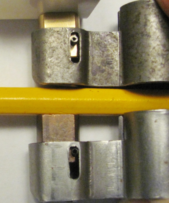

There have been some old discussions on a certain New Timer model designated with an S"S" in the 12 o'clock position http://www.mtfca.com/discus/messages/41 ... 1392132115 Having read some additional discussion and looking at the components I wonder if the culprit is the brush more than the timer case. The brush is the moving component, if it doesn't ride true across the inside face its bound to cause excessive wear.
http://www.mtfca.com/discus/messages/70 ... 1501892976
By Dan Treace, North FL on Friday, August 04, 2017 - 05:28 pm:
Its the brush rotor that I like in this design, as the bronze brush fit in the steel housing has little 'slop or wiggle' when compressed into the rotor cylinder. If you grasp the compressed brush, (there is a spring behind the brush) you can't wiggle much. The other repops you can wiggle the brush too much IMO.
That can be a cause of failure to the earlier New Day repops.
This photo is showing the best I could of why it's important that the brush rides more firmly in the steel housing without undue wiggle or slop.
If you observe the upper rotor (Tip Top's new New Day rotor) you can see its compressed some as when in position for running, and the retaining pin is centered nicely in the steel housing.
Note the lower brush from other available repops, as these brushes aren't made to fit nice, there is lots of wiggle of the brush in the housing.
That allows the retaining pin to ride on the edge of the vertical slot that controls depth of the brush. By impinging on the edge of this slot while the brush is whirled around the housing under spring pressure, excess pressure is placed on that retaining pin, that leads to ultimate fracture of the bronze brush at the hole for the retaining pin.

I have seen some new day timers with a spring on the brush that is much too strong. I replace them with a spring out of a ball point pen.
- Posts: 3950
- First Name: Larry
- Last Name: Smith
Re: T Eats Timers
I don't believe either of the brushes posted above are authentic. Original bushes are not as wide.
