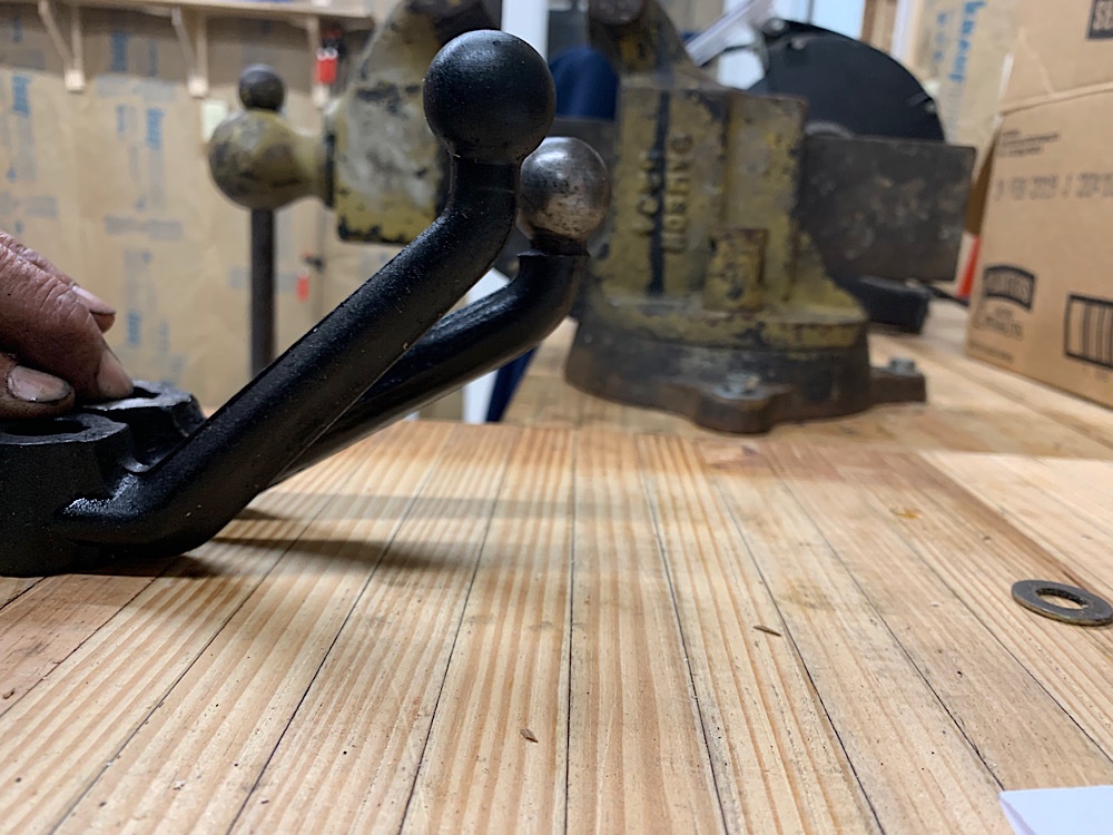

I was going to change out my original pitman arm with a repo to eliminate some slop. Placing side by side the new one is 1/2” closer to center of shaft and 1/2” out further to front of car. Ordered one for my year 1920 should I use?

Re: Pitman Arm Ok?
I think the new one you got is correct. The one you took off looks like maybe for a 26-27 because the steering column is on a different year on the lower bodies, the pitman arm would be shorter and on a different angle.

Re: Pitman Arm Ok?
Norman, The new one is actually at a steeper angle and shorter.
I installed new one to see if there were any issues and it seems like it ok. Guess I will with new one. Thanks
- Posts: 4658
Re: Pitman Arm Ok?
In your picture, the one closest to the camera looks like the correct one. The other one to me looks like there is wear on the ball joint, so I thought it was the old one.

Re: Pitman Arm Ok?
Yes the old one is in the rear with wear on ball.
I did a test run with new pitman arm. It’s tighter but to me the steering seems more touchy or sensitive to wheel. I am going to check wheel alignment. Geez how many different pitman arm style were made!

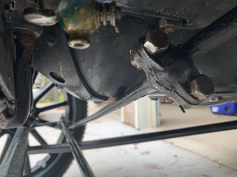

Thank You all for great advice. Well, I ended up putting my old pitman arm back on the car. The car steered fine with the new pitman however had to realign to get toe in to 1/4”(May not had anything to do with new pitman). I discovered when I cranked the steering wheel to the left or right the pitman went over center or over 180 degree total travel until it hit the stops in the gear head of the steering column. When I turned hard right the tie rod was hitting the nose of the engine pan. For my steering the pitman is a No Go.
Allan, I have used refurbished steering balls on my A and have been very pleased. Perhaps I will do this pitman, it’s around .010” under so not that bad. John
Photo shows the new pitman allows tie rod to hit engine.
