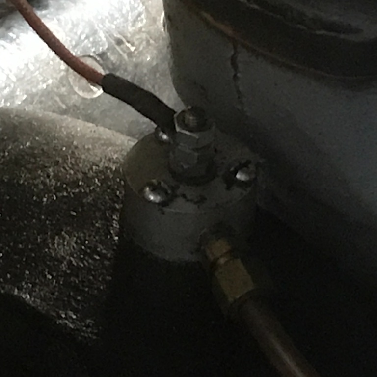

I’m helping a buddy with the ‘22 he bought. He’s been able to drive it about 200 miles, dealing with problems as they appear. It used to run good on mag, now the mag appears inoperative. It has an oil line attached at the mag post. Anybody have any experience with what the problem might be or suggestions as to how to proceed?

Are the three screws that hold the mag post threaded into the hogshead? We’re afraid to loosen them for fear of dropping a nut or something into the tranny.

Not a problem removing the mag post. The hogshead is threaded for the screws and there is no way you could drop anything into the post hole once you remove the post.

Loosen the three machine screws and lift up that mag post. You may have to loosen and/or remove the oil line to the fitting.
These have an internal spring, like a ball point pen spring, inside that pushes out the needle for contact to the coil ring solder blob. Check to be sure that contact is working.
Most times its crud causing ground and lost of AC power.

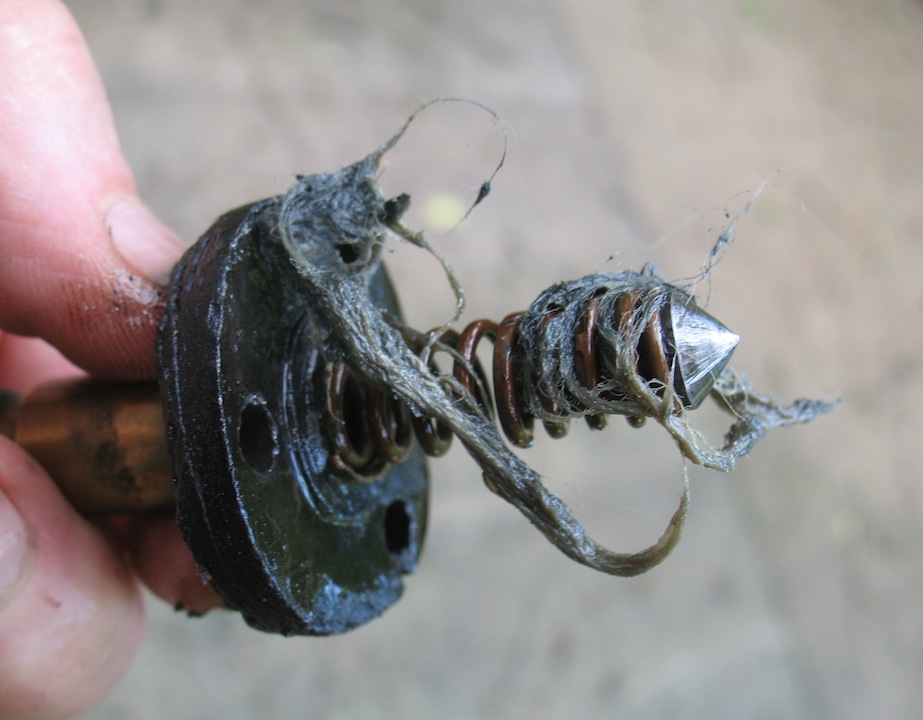

Here is one with Kevlar fuzz, excessive since the drums were filled with pits and sharp edges, that shredded the linings.

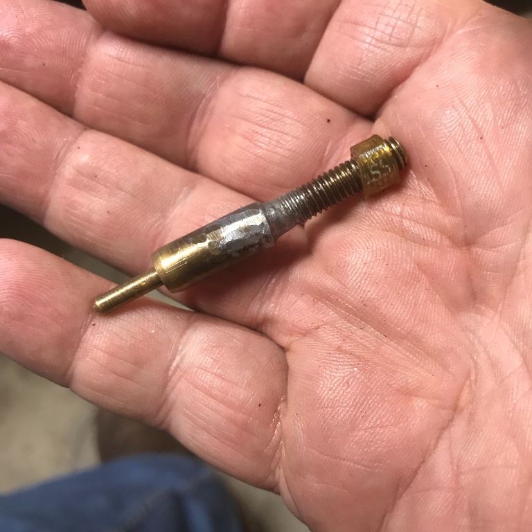

We removed the post and got a bit of a surprise. No fuzz.
First, the brass spring-loaded post was off center and when removed appeared to have been repaired. It also has a little bend to it. It was insulated from the collar by what appeared to be a piece of plastic hose and two nylon washers...the inner one of which was half missing.

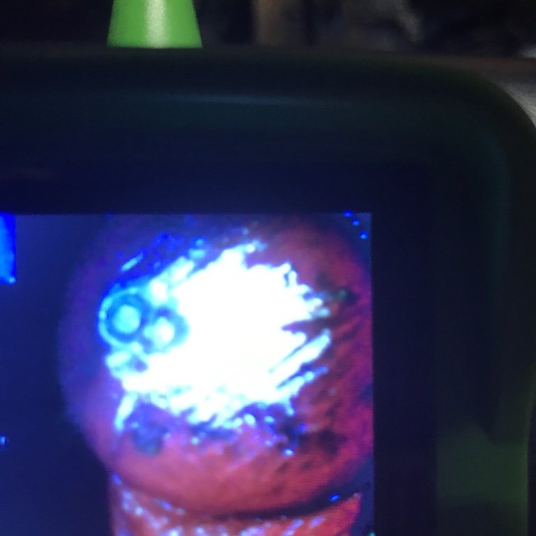

Looking into the hole with my cheapie borescope we saw two dimples in the contact surface. We think the post should be replaced regardless....should we worry about the contact surface?[attachment

The dimples in the contact button surface should cause no trouble. Just make sure it's reasonabley clean.

The dimpled contact surface usually means you have a older original mag ring that’s still working. The rebuilt ones I’ve used will usually have a newly soldered button. I think you’ve found your issue. Buy a new mag post with oiler connection and install it. One thing to remember with a new mag post with the oiler connection is to make sure the new fitting will install with your old oil line or replace the entire oil line oiler assembly on your car.
The repos don’t always interchange well with each other. Especially if the repo you might have is one of the older ones. Just a heads up!
The little bend on the contact spring may indicate the lead button is off center with the cover hole. That’s exactly what’s wrong on my 1919 Roadster. It works Ok but I have to make sure about the angle when I remove and reinstall it. Don’t ask me how I know! Good luck with your car.

My friend Gene and I want to thank all of you for the information. Model T's are certainly a learning experience. Gene is going to order a new mag post tomorrow so fingers crossed that it solves the problem. The one he removed had poor insulation - just a piece of plastic tube between the brass post and the aluminum collar and a couple of nylon washers. The post sold by Langs looks to be much better constructed.

Update. My friend Gene ordered a new mag post from Langs. With it installed, the magneto works fine. We're not entirely sure what caused the failure of the original but we have some ideas...at this point we're just glad it's working. Thanks again for the info and advice.
