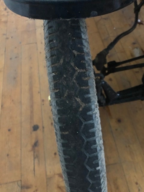

I currently have Universal T Driver tires on my 1924. The tread pattern is nearly gone on a couple of them, but I don't see any patches of cord yet. How far down can I run them? I don't drive in the rain.

One thing I've found over the years is, the cords are pretty tough. I've literally had to use a sawsall once to remove old stiff tires and was shocked how hard it even was for the saw. Problem is possible skidding due to no tread.
- Posts: 8510
Re: How Far Down do you Run Your Tires?
In Texas, the law requires at least 1/16" of tread all the way across the tread area and all the way around. How far a tire can go without failure is difficult to say. Age can affect the strength of the tire, as well as type of use, loading, weather, carcass material, and more. Worn out tires could become a liability issue in case of accident. Old tires can blow out with considerable force. I've had them blow out on vehicles that are parked and sitting. I'd hate to have one blow out while airing it up. Worn down tires are more prone to flats, and worn down tread on the front wheels can cause road walking and hard steering. Old, hard rubber does not grip as well as live rubber.

I'd order new ones now and hope you get them by next driving season (if you are in the northern US). By then, you'll perhaps have the wear on them that you'll feel good replacing them. Given the current global shipping issues, if you wait until you need them... you'll likely be waiting...

Thanks everyone for the replies! I don't think I'd have the nerve to run tires with exposed, floppy cords. :O
I do have a new set of tires mounted on new rims and ready to swap on when needed. I like the idea of holding out until next spring to do the swap, I'll try that.
