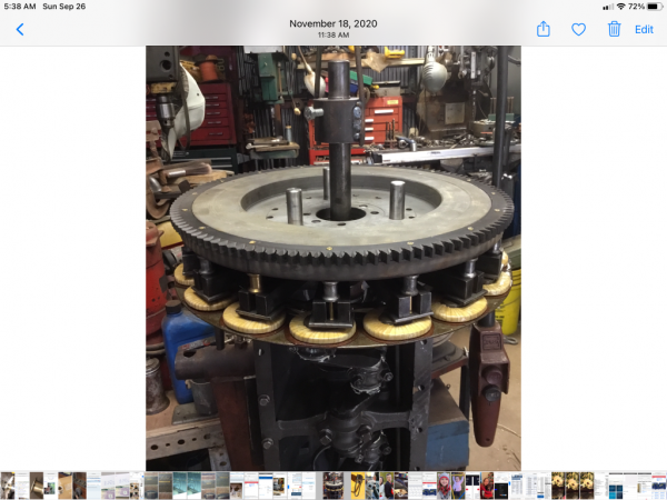

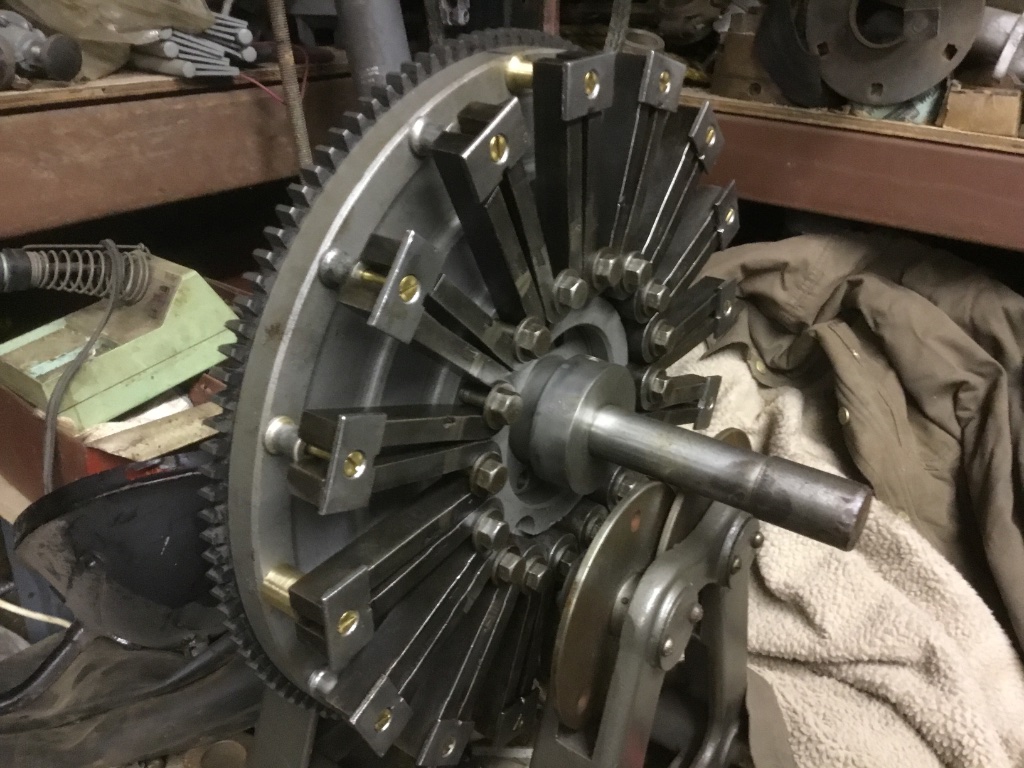

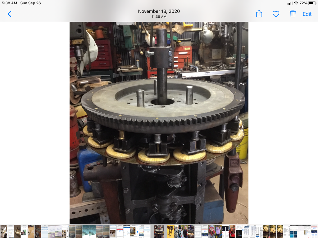

Andy Loso
- Posts: 86
- Joined: Sun Jan 06, 2019 12:58 pm
- First Name: Andy
- Last Name: Loso
- Location: St Joseph MN
Re: Flywheel Ring Gear Issues
I do these all the time, just did one on Sunday. Contact me via the messaging here or at alosoatq.com if you are interested or just want to pick my brain; won't take long.
