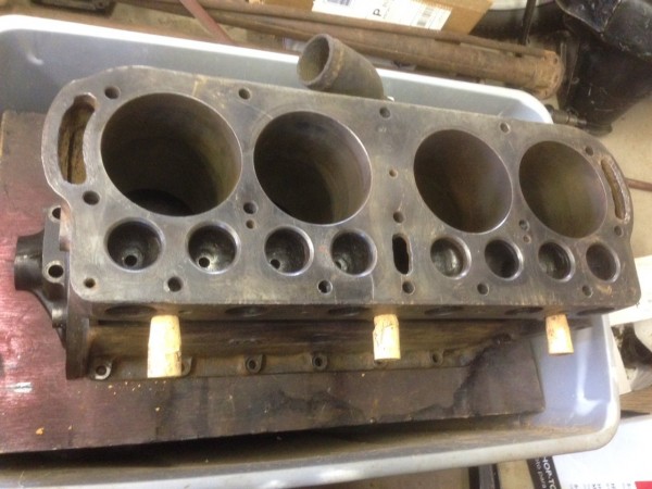

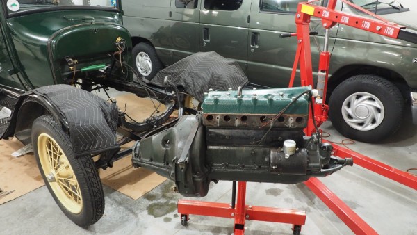

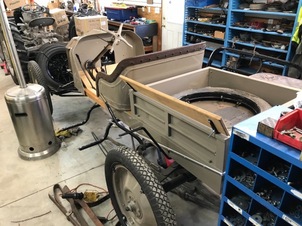

Took my engine to Mike Bender and we spent the day digging in to see what it needs beside a new crank and rods.
I'll be looking for a better main shaft and brake drum. The cam, valves, and lifters are OK.
I shot a picture of this clutch drum puller so I can make one. The original Ford tool sometimes doesn't survive a really stubborn drum.

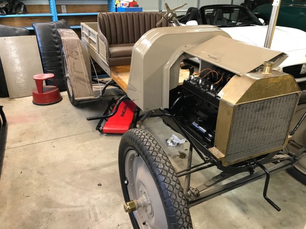

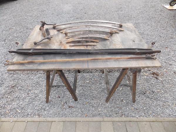

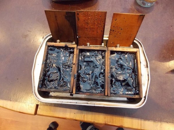

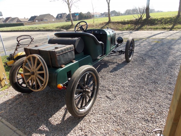

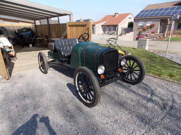

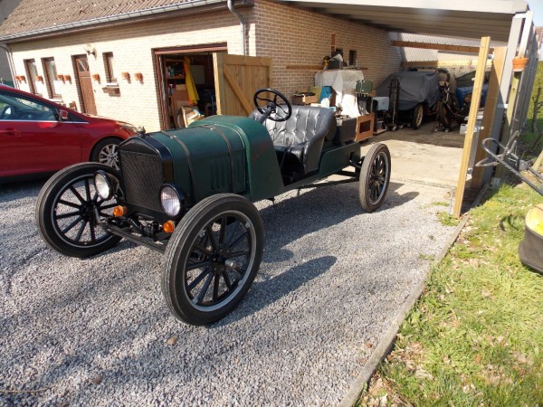

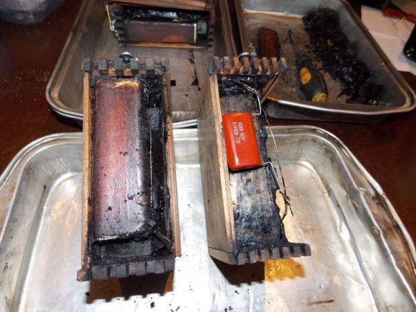

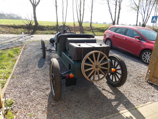

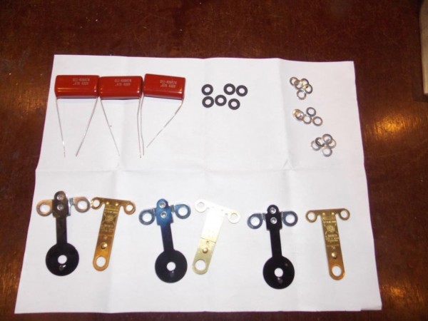

Rebuild a few parts for a model t car out of the Den Hartog auction last year.
The car didn't run, I hope I can put it back on the road soon.
Andre

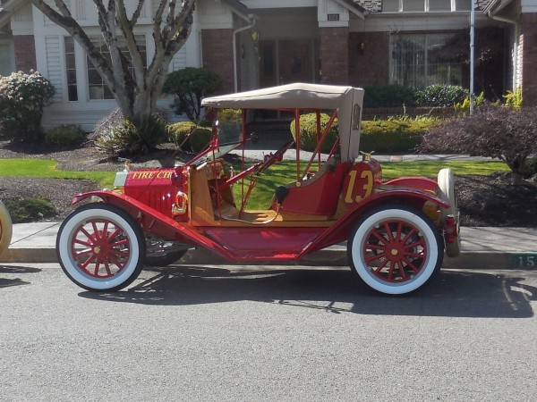

Post by Loftbed » Tue Mar 05, 2019 12:37 pm

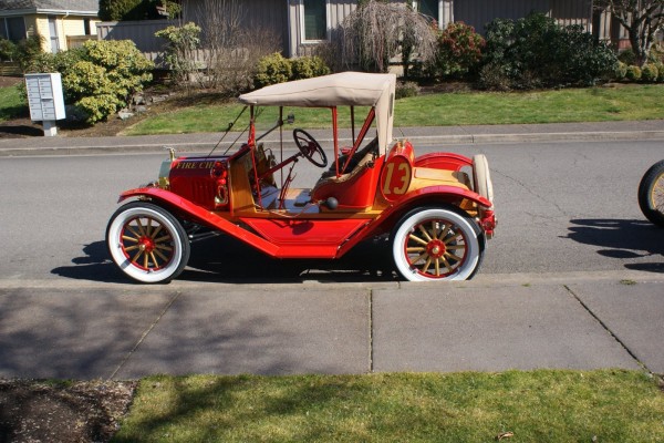

I've changed the 1915 headlights to the 1913's. still thinking about the side lights.
As you can see, I've also been converting it into a fire chiefs car more on that later.

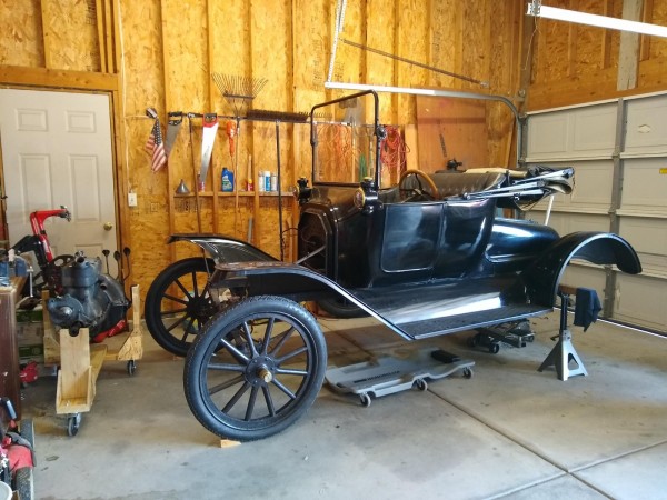

Getting Wilma ready for a valve job.

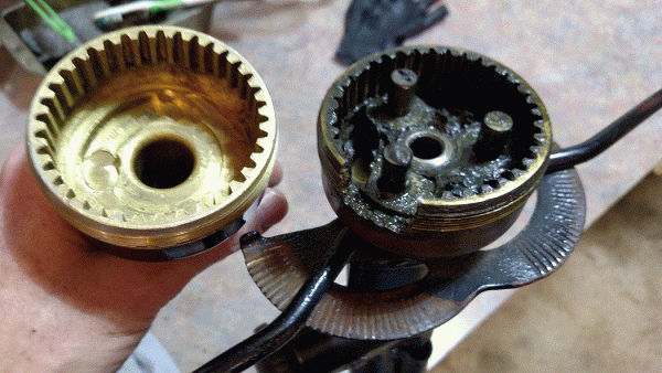

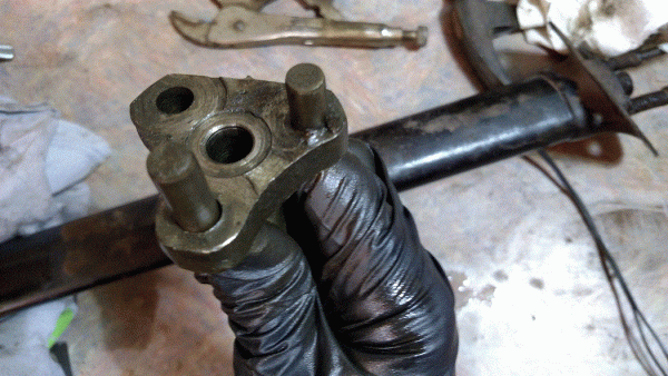

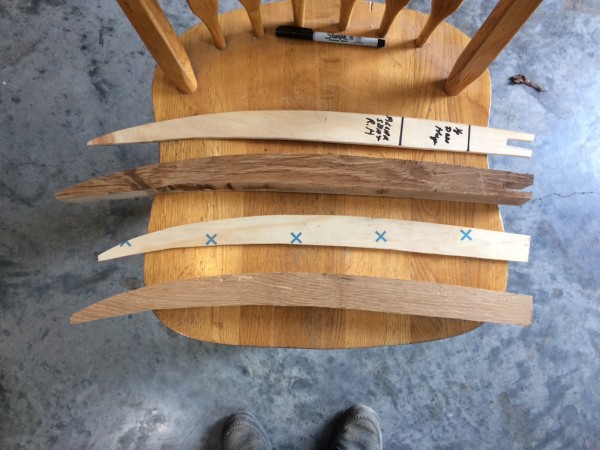

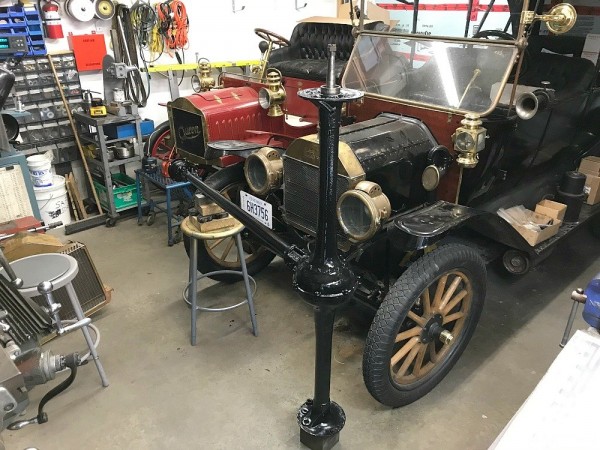

The other day I noticed that the steering wheel in my 1923 touring was kind of floppy, so today I hunted up a pinion and cover with a better fit. Yes, it's a 24-27 cover, but it will do until I find a better correct one. The steering wheel free play is ¾" to ⁷⁄₈", which I think is pretty good.

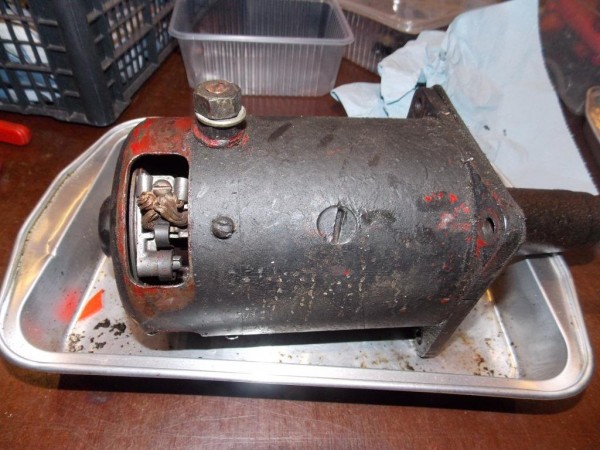

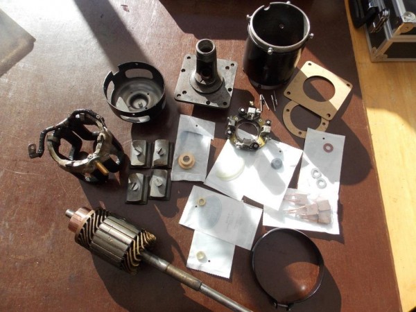

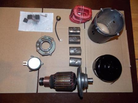

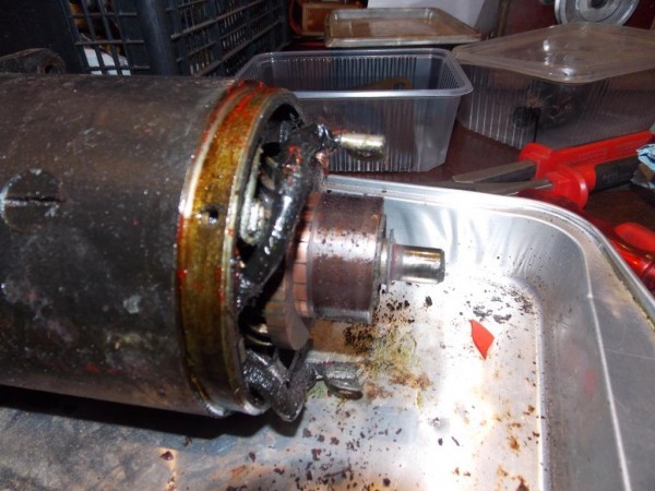

Start the rebuild of a generator this afternoon.
Will continu tomorrow.
Andre
Belgium
Posts: 2866
Last Name: House
Re: What have you done with your T in March?
Post by George House » Sat Mar 09, 2019 5:22 pm
Toured in the ‘19 centerdoor around rural Fayette County TX with 7-8 other Model Ts and visited a few local museums too. Nice 82 degree weather, beautiful sunshine and very sparsely travelled paved roads.
AndreFordT
Posts: 519
Joined: Sun Jan 06, 2019 12:25 pm
First Name: Andre
Last Name: Valkenaers
* REQUIRED* Type and Year of Model Ts owned: 1926 ; 1922 ; 1915.
Location: Scherpenheuvel

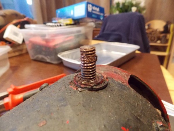

Post by AndreFordT » Sun Mar 10, 2019 1:03 pm

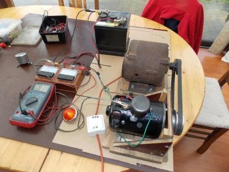

Stormy weather today.

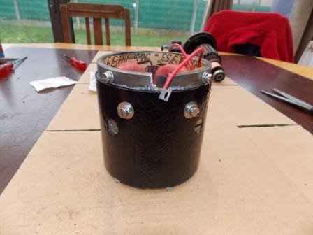

Good time to finish the generator.

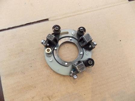

First I set the armature on the growler. It passed all the tests.
Build a diode in the cutout.
Than, piece by piece , it came together again to make a good generator.

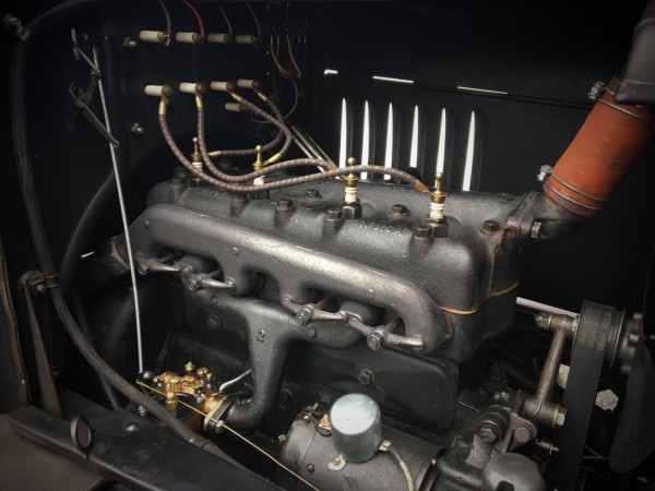

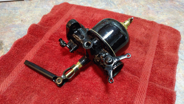

Got the OF carburetor adjusted for the high end speed and installed the Air / Gas mixer up on the horn button. The cable goes under the dash and through the firewall down to the air horn valve ... the same disc as the choke but the mixer allows different fixed settings when starting and warming up on a cold day.
HaroldRJr
Posts: 169
Joined: Mon Jan 07, 2019 10:13 am
First Name: Harold
Last Name: Schwendeman
Location: Sumner, WA
Post by HaroldRJr » Sun Mar 10, 2019 4:05 pm
Hmmm,.....I thought that one of the advantages of an "OF" was that you didn't have any "adjustments" to fool with,....???
Mark Osterman
Posts: 1014
Last Name: Osterman
Location: Rochester, NY
Post by Mark Osterman » Sun Mar 10, 2019 4:31 pm
The original instructions and parts illustration shows this. There is a choke wire that runs to the front of the car as usual. If you’re sitting in the drivers seat of a starter motor era T .. this is how you are suppoosed to choke the carburetor. In cold weather the carb runs better initialy with a slightly more rich mixture. This carb doesn’t have a needle valve .... so slightly closing the choke with this lever does the job until the engine warms up a little.

Thanks for the explanation Mark. So,....if you bought a brand new Stromberg "OF" accessory carburetor back in the day, did you also get the brass Air/Gas Mixer control & cable with the new carburetor?

Yes, the “set up” came with the carburetor, a throttle rod to replace the Ford rod, a special carburetor pre heater stove for the intake and the choke control. The choke control I used is actually from a Shebler carburetor, but it’s nicer looking and more substantial than the Stromberg control. The pre heater is not necessary with modern fuels.

Thanx again Mark,....guess there's more to know about the "OF" carburetor that what we normally hear about, huh? Wonder what "Unca' Stan" considers the complete and ideal set-up for the "OF"? I always thought it was just a simple matter of removal of your present carb and just bolt on the "OF", hook up the gas line & throttle linkage and you're "in business". And as good as that seems to be, you've apparently shown how to go a step further and make it better!

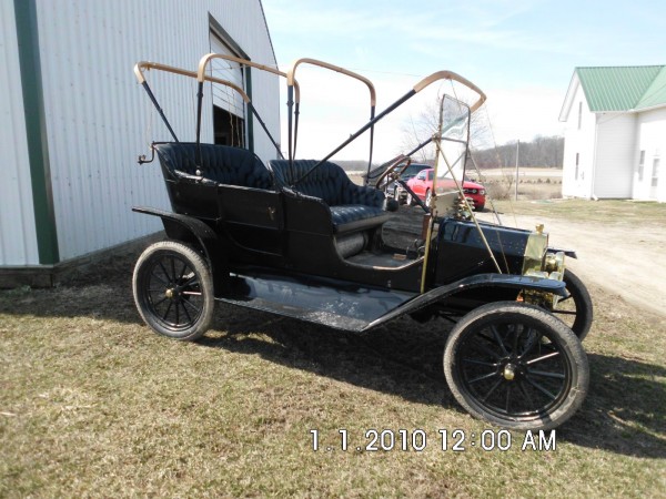

I got this old speedster project back out that I started about 10 years ago. I installed the engine last week and now need to make time to get the rest of it done.

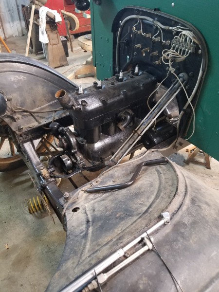

I pulled the motor out of my sedan yesterday. I will remove the transmission tommorow. I made it in Florida just fine with the broken tooth. I have to work outside but finally had a day to work on the T. I can put the motor inside, so the weather won't stop me know. You all have a good week. Will drive to Chickasha Thursday to shop.

This week my son and I started the re-restoration of a 1915 runabout that I picked up last November. It is a very old restoration that looks good from about 20 feet, but is pretty rough up close.
We got the engine and rear axle removed today, and the next step is to bring them down to Mike Bender for rebuilding. Pulling the engine and rear axle went pretty smoothly. The 1915/1916 brass T engines are a bit of a pain to remove because the engine ears are trapped by the body. None of the old books or manuals describe this issue, but the tips that I've gotten from the MTFCA forum site and Steve Jelf in particular on dealing with this sure helped. Fortunately we have a 1921 touring to enjoy while we work on the runabout!

In October 2017 it started with the rebuild of an engine. In February 2018 I was asked to set the engine in the car, it seems to be a speedster.
Today I did the last corrections and made the first really test run.
André Belgium

This block came out of a TT truck that looked like it was cobbled together at some time in the past, based on the mix of major pieces. My plan is to make a test stand using this engine to test carburetors, starters, and generators. It’s an Oct 1925 engine, in others words an early 1926 block. It looks nicer than most on the outside, but the water jacket is pitted and full of rust scale. I’ve tried running a splayed cable through the water openings and shot air through the passageways to get as much of the loose rust flakes out as I can. Now I’m trying to chemically convert the remaining rust using Rustoleum Rust Dissolver and will see how it does in a day or two.
Notice the sacrifice I had to make in order to plug the core holes. One slowly leaked for 30 minutes or so, but then expanded enough to seal the port. Perhaps the next time I’ll need to buy Chianti Classico Riserva instead of the lower Classico designation. ;) The upside-down water inlet made for an excellent pour spout and allowed filling the water jacket almost to the brim.
Rich C.

Building a front axle right now.
Last weekend change the transmission bands of a 1912 runabout.
Andre

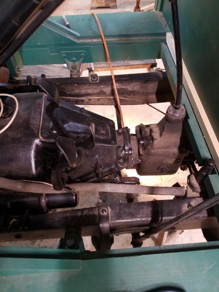

Boy, March has been a busy month for everyone! I got my '13 rear end rebuilt and installed. Works like new, and safe! Went for a test ride today.
