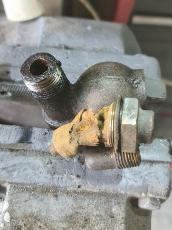

I have pulled the fuel tank and its full of tar. I have read por15 is the stuff to use. Is there anything else or is that still the best to use?
I started pulling apart the tap and the filter is stuffed. Can I buy a replacement?

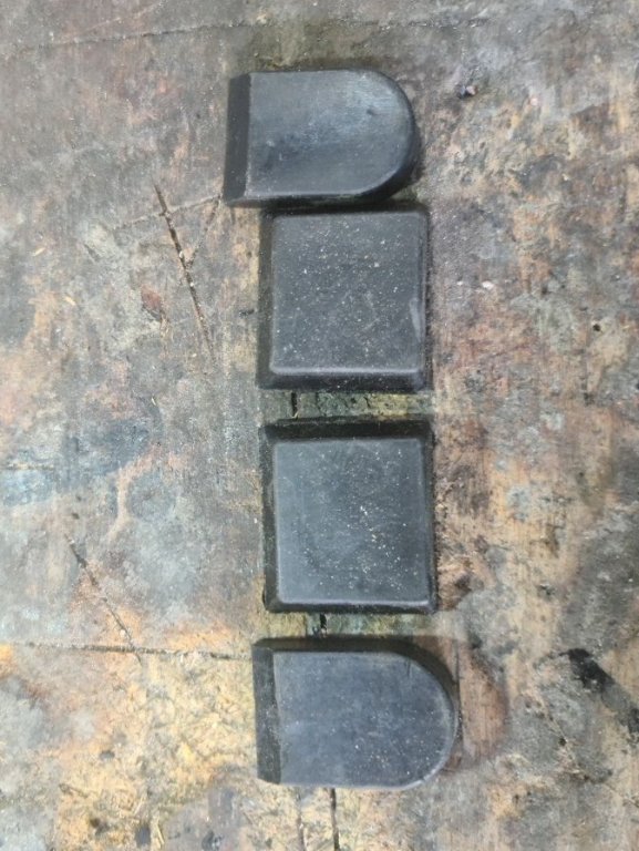

I was also installing the rubbers on the door jam. Where do the square ones go?

Ring Henry's T & A parts in Swan Hill, Keith should have a filter, or any of the USA vendors have them listed.

Many of the Model T suppliers have replacement parts for the sediment bulb.
