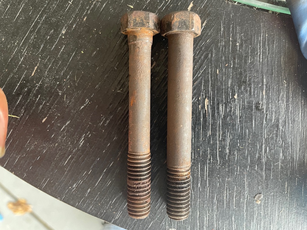

Which of these head bolts are correct for a 1925 engine? Also, is this a high or low head?

How pure you want to be?
I can get dimensions and add them as a postscript but a 25 would be a high head…
And the bolt on the left is the more accurate!
Can I have some fun? Anyone care to comment why?

Don’t need to be all that pure, just want them to work. 13 of the the ones on the left, and two of the ones on the right came off of my engine. I figured the ones on the left with the longer threads were correct but just wanted to make sure.

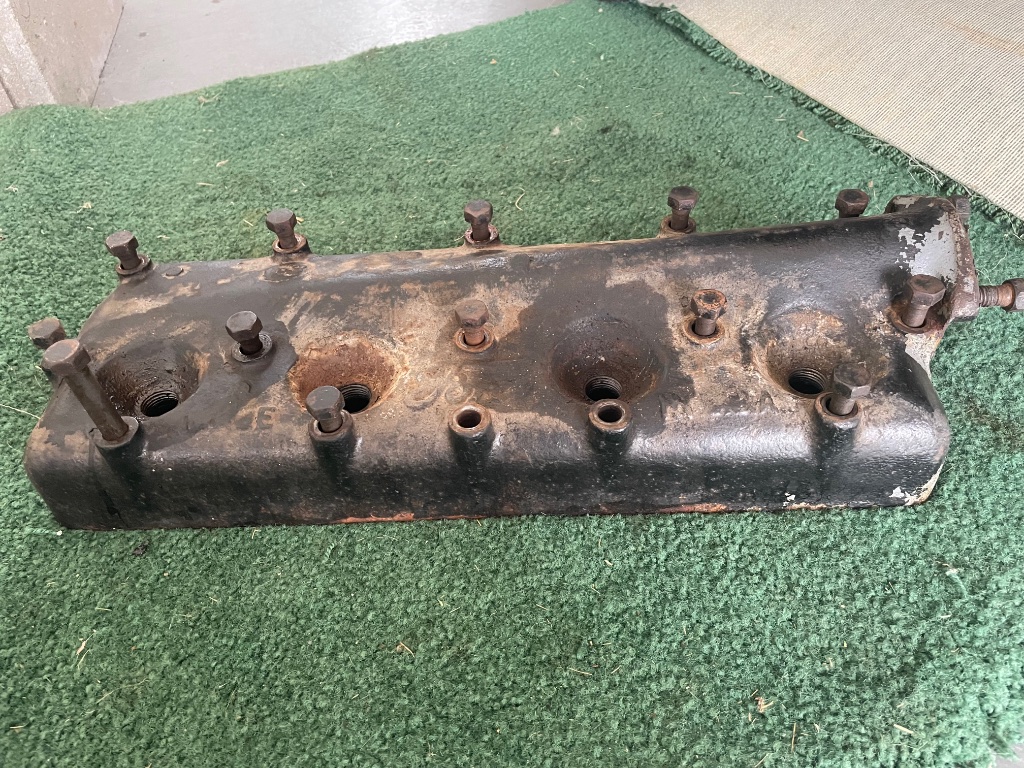

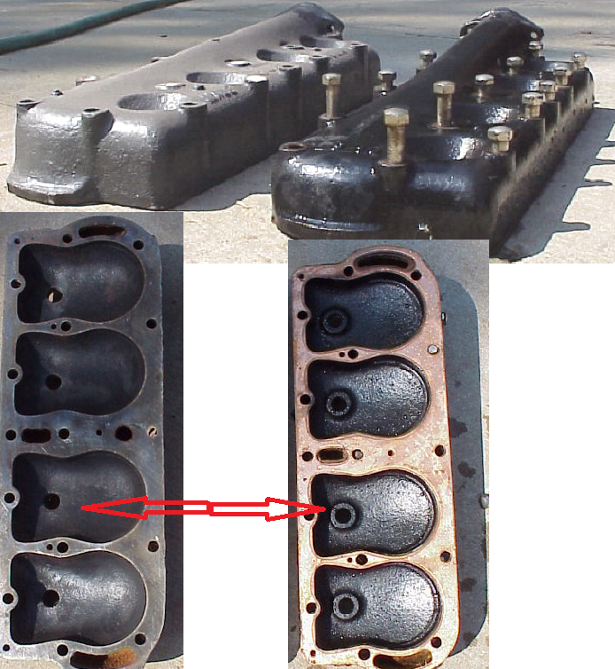

Post a picture from the side of head to tell if high or low. You

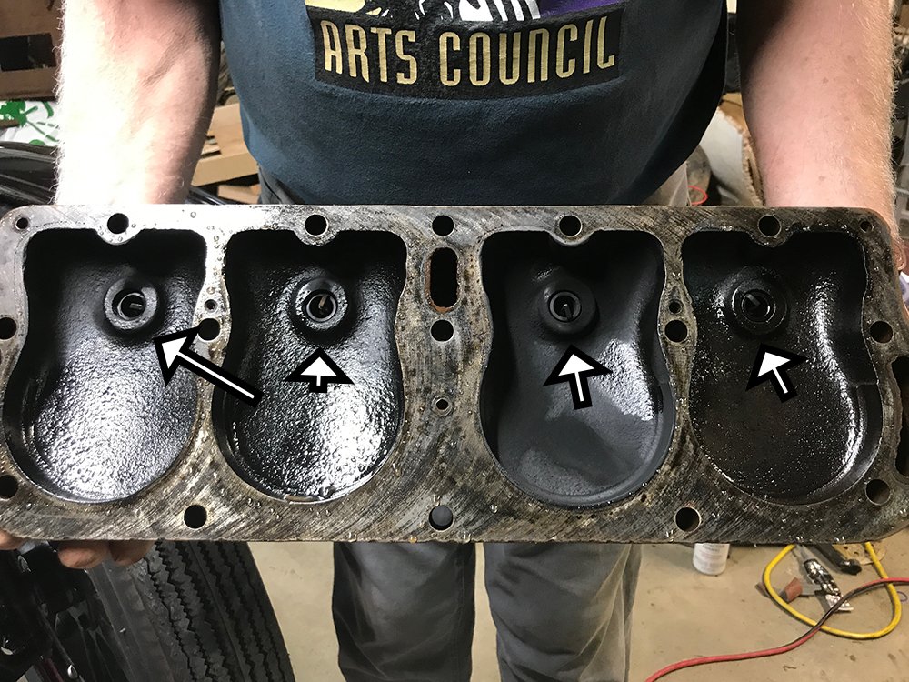

Miles, how about a photo of the underside of the head? Low heads have a raised area around the spark plug hole.

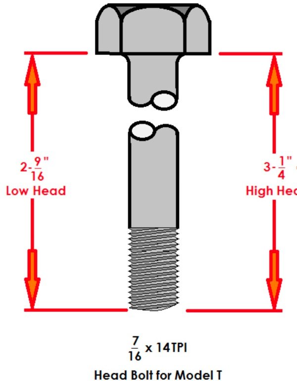

Attached is a graphic from Model T Guru Dan Treace showing correct bolt length. Again, be sure they don't bottom out.
Follow the correct re-torque sequence and torque to between 45-50 ft-lbs. Too much torque risks stripping the threads.

George, I'd say the bolt on the right looks to be a domed head for the improved car which could still be possible on a late 25. Do I win. Jim

I have always felt that new headbolts from a vendor is a wise move, if your head has the raised area around the sparkplugs as shown by Tim's photo that is a low head & would use the shorter bolt. A bottoming tap should be carefully run in each hole & debris cleaned (vacuumed as indicated), a bottoming tap can be made from a spare/common tap by grinding down to bottom threads, also chase the threads with a regular tap first. When taping or chasing a thread if turning the tap yields resistance or snag, stop & remove tap clean the hole lube the tap & reinsert. At the bottom do not, force a hole can be created into the water jacket if you try hard enough. In a "high" head that use the longer bolts the domed bolts came out for the later engines '26-7 as a dress update George

The bolt on the right is an earlier one. It does not have the reduced diameter shank like the one on the left. The domed ones used on the improved cars have a pronounced dome which is hard to miss if seen more directly from the side rather than from below.

Ding - ding - ding -ding...we have a winner!
Ford went to rolled thread head bolts in 1923.....the one on the right is a cut thread version.

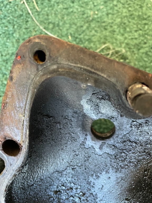

Thanks Tim. By your first two pictures, I do have a high head, as others have said is correct for 1925. My head does not have the internal bosses around the spark plug holes, and the length of the bolts are about 3-/1/4 from the bottom of the head to the end. Also, thanks for the tightening sequence; I now have it in two places, so I should be able to find it when the time comes. What is the source of that diagram? The Ford Service doesn’t specify it in the section on installing the head.

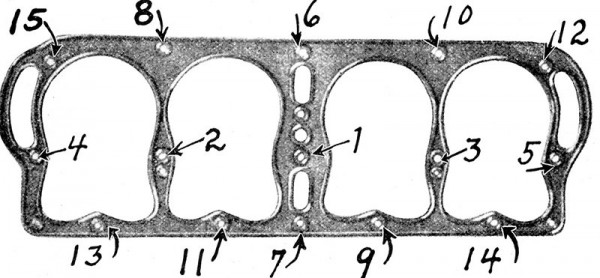

The tightening sequence is pretty much the same for any flat head engine or any automotive cylinder cylinder head.
Start from the center and work your way EVENLY out will do it every time. It’s a basic automotive procedure.

As to the tightening diagram, I got it from this forum. Here's a thread from ten years ago <http://www.mtfca.com/discus/messages/17 ... 1308589982> citing some of the original sources.

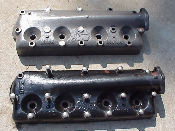

Just some pictures from old posts to show differences side by side

I agree. The way that I was taught back when the world had corners was to start with the center head bolt at 1/3 of the final torque and work your way outward in a clockwise (or if you prefer) counterclockwise direction until you have torqued them all. Do it again at 2/3 of the final torque, then end up with the final torque. If you are really anal then check them again in the same way at the final torque. I have used this procedure on every automotive cylinder head that I have ever installed - including the last one, my '27 T, in 2014. I have never had an issue with any cylinder head that I have installed. BTW: Use a known accurate torque wrench, a click type would be my preference.

I have heard of cut or rolled threads before but never understood the difference. How are they different? Can I use my tap & die set of both?

Paul, if you look at the two bolts in the photo, the shank on the bolt on the right is the same diameter as the thread. That thread is made by the die cutting metal away. On the left bolt you will see a necking down under the bolt head to make a slightly undersized shank. That thread is a rolled thread, formed by a different type of die displacing metal rather than cutting it away. This raises the diameter of the thread somewhat, thereby making the undersized shank necessary. Rolled threads are stronger.
Each has its advantages. In model T's the rolled thread head bolts are less likely to rust up solidly in the cylinder head due to the lesser diameter on the shank. Cut threads on the six hub bolts, with their full diameter, are better in wooden wheels because they fill the holes drilled in the spokes.

Thanks Allan, you did a pretty good nutshell explanation of the difference. I should be able to look at the threads for an expansion & understand which is which.
