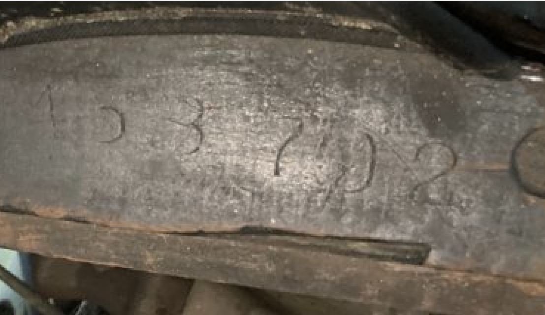

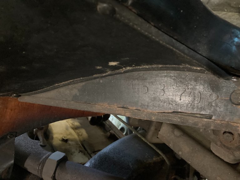

For all you experts out there, thoughts on this body number? Found on the floor riser. Car is suposedly a 1917. Could be 1918. 458792 or 468792

It looks like there might be some very faint numbers before the ones you list. Typically those show the year of production.

How many numbers should there be?

There is a space between the 8 and 7. The leading 4 may be just marks in the wood or could be the letter L, all tbough I see why you say it is a 4. Bodies were numbered by the body builder and generally had the month and last number of the year then a space and a production number for the month. Thus it could be a number from June 1918 and in this case a early number from that month. If that is a leading letter it would be a letter for the body factory, Ford was still buying bodies from outside companies in 1918.

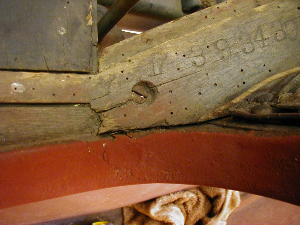

I used to have a guess of the body maker on the likely Milwaukee assembled 18 Runabout here.
Body numbers can also look like this on the riser.
7 17 393430 I supposed 7 of '17, body number 393430. I could be wrong still. Seems to suit on this one tho.
I caught the number but use light at different angles to really catch numbers.

For Duane -- Yes, I'm 99% sure that your 7 17 393430 represents a Jul 1917 393430 body number.
For Ryan -- Zooming in I agree that the first visible number is a 4 (see below). Some of the other numbers are hard to know for sure -- but not critical -- as so far none of them appear to be the date code for the body.
