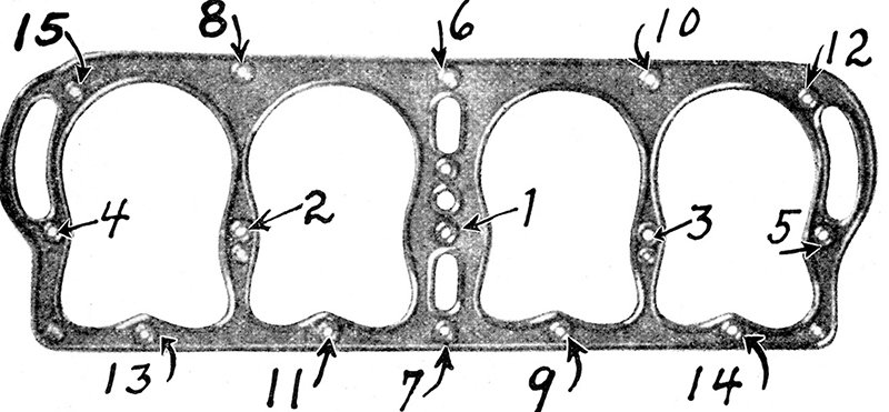

A couple more things to consider - A high head has a little more coolant capacity but has slightly lower compression than a low head. Since you have the head off, you might want to consider whether to replace your head with a high compression head from either Z (Michigan) or Prus (Ohio) to give you a little HP boost. My T has a Z and shows 25 HP on the dyno at 1600 rpm. From the outside it looks identical to a high head although it is aluminum, not iron.
As to the tightening diagram, I got it from this forum. Here's a thread from ten years ago <http://www.mtfca.com/discus/messages/17 ... 1308589982> citing some of the original sources.

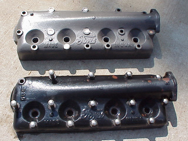

Just some pictures from old posts to show differences side by side
