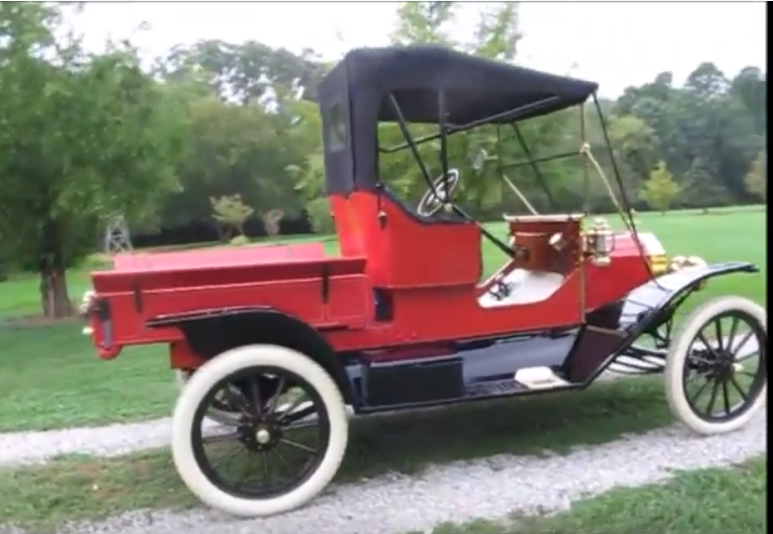

I did a search to get some pictures of what the configuration might look like. Some are not of a Torpedo body but I would expect driver position etc to be relatively the same. The corresponding link is above the picture
https://journal.classiccars.com/2020/07 ... e-day-tom/
http://classiccardb.com/ford/270532-ant ... ickup.html
https://topclassiccarsforsale.com/ford/ ... dster.html

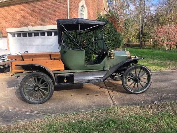

Here are some pictures of our ‘12 Pickup. Not really a torpedo though.
