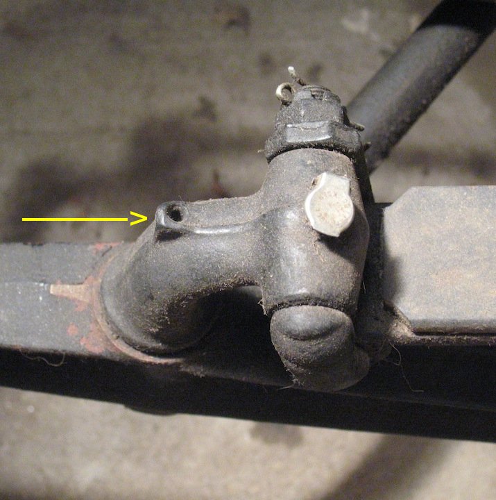

I'll take another whack at this dead horse. :)
The arrow points to the part that goes toward the rear of the car.
