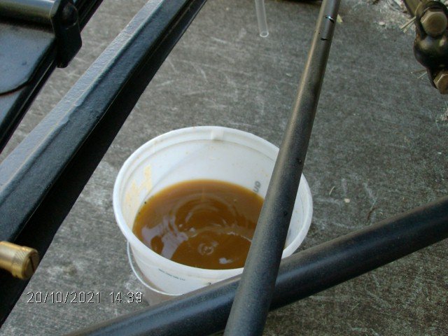

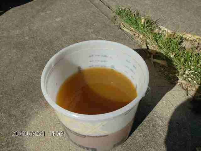

So I got the T running this summer. I put between 5 and 10 miles on it - easy driving up and down my street. While emptying the cooling system to put the car to bed for the winter, I see the coolant water (it was just water) is a reddish brown, the color of a fine holiday cider. It is so dirty I thought there might be oil in it. Then I thought maybe this is normal since it's a cast iron block and the motor has been sitting around a lot. By the way, I had a Motormeter on it for driving and there was no overheating, even the first day driving.
Do you think I have a problem with a cracked block or does this seem normal for start up operations after an overhaul? I think the Miller crew paint the inside of the block too.
What is the capacity of the cooling system? I got about 7 quarts back even with the front wheels 2" lower than the back wheels during draining so seems like there's still a couple quarts left in the engine. Does that sound right to you?

The system is supposed to hold three gallons (12 quarts). Rusty water seems normal for sitting all summer. 5-10 miles is nothing !. Drive that T !! You'll be glad you did. (and you'll find out what all needs attention / correction

If it has been sitting since summer with water in it, and now the water is brown, I'd say that some of your block and head are now in that pail.
after 95 years of "just" water in them, many blocks are tissue-thin and will crumble and leak...those which have been blessed with coolant or soluble oil over the years are in much better shape and those are the ones which survive to be rebuilt.
Use coolant or soluble oil, and save the block and head from further decay/destruction.

I am working on one which had been parked for 20 years and the coolant was still green anti freeze. I drained and replaced it.
Your coolant looks like rust. You really need a rust inhibitor in it so that won't happen again and also if you have hard water in your area you need purified or distilled water so it doesn't leave lime and mineral deposits in the cooling system.
Your address indicated Kentucky, so you most likely have some days below freezing, so I would recommend the green anti freeze solution in solution recommended for your lowest predicted temperatures. That anti-freeze also has rust inhibitor in it.

“Coolant water....just water” is a radiatorman’s dream. Keeps him in business. Use 50/50 antifreeze and $1 @ gallon distilled water

I would suggest you flush your system BEFORE putting antifreeze solution in.
Good Info here: https://dauntlessgeezer.com/DG96.html
Once you're sure it's all clean, then antifreeze it for the winter.

I stuck my hand in the sample I drew yesterday and couldn't feel any oil on my skin so that's a load off. I'm surprised this happen just over the summer. I didn't expect that to happen in 3 or 4 months.

It didn't happen in 3 or 4 months this summer. That's existing rust that you flushed out. Go with the anti freeze suggestions. Not sure why so many responses have homemade recipes that were fine 70 years ago? If their recipe is better than the current coolant manufacturers I wouldn't be recommending it to model T guys, I'd be selling it to the biggest anti freeze company that would listen. Good luck with that! One must remember your original block T was cooled by whatever water was handy, be it from a well, creek, river or slough. We run straight water in our prairie tractors and drain when warm. We take them out once a year. Water is never red when draining. Sounds like a contradiction to my statement on anti freeze? My T doesn't leak. The prairie tractors pee on themselves constantly. We'd be a super fund hazmat site after the last 50 years! Have fun with your T!jesselashcraft wrote: ↑Thu Oct 21, 2021 6:09 pmThanks for the replies -
