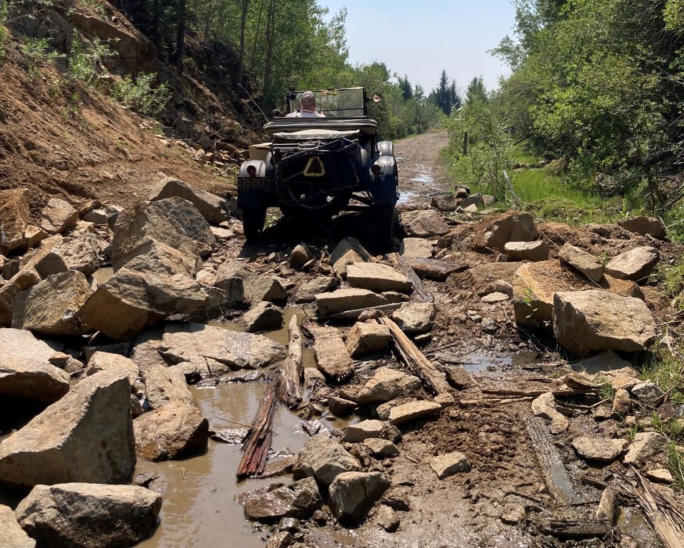

I have run 525/21s Firestones for years on my 26 roadster (have always called it Hobo Overdrive) it does give you about 20% more tread on the ground for increased braking, the 3% overdrive is noticeable and if you don't have a Ruckstell you will spend more time in low. The Firestones are a little taller than the other brands that I have put them against and they are 6ply rated, some of the places that I go that gives me peace of mind. People that know Model T's notice them right away, after a short time you get use to the difference in how they drive and how the look, they also last a lot longer than other tires, I get 35,000 to 40,000 miles out of a set before replacing and they still have some tread left. I love them.

I forgot to mention that I run 36 psi but I carry a pretty good load, I have also noticed at lower pressure you get a fair amount of sidewall flex that you can feel as you drive.
