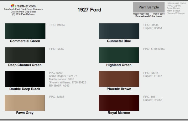

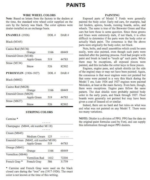

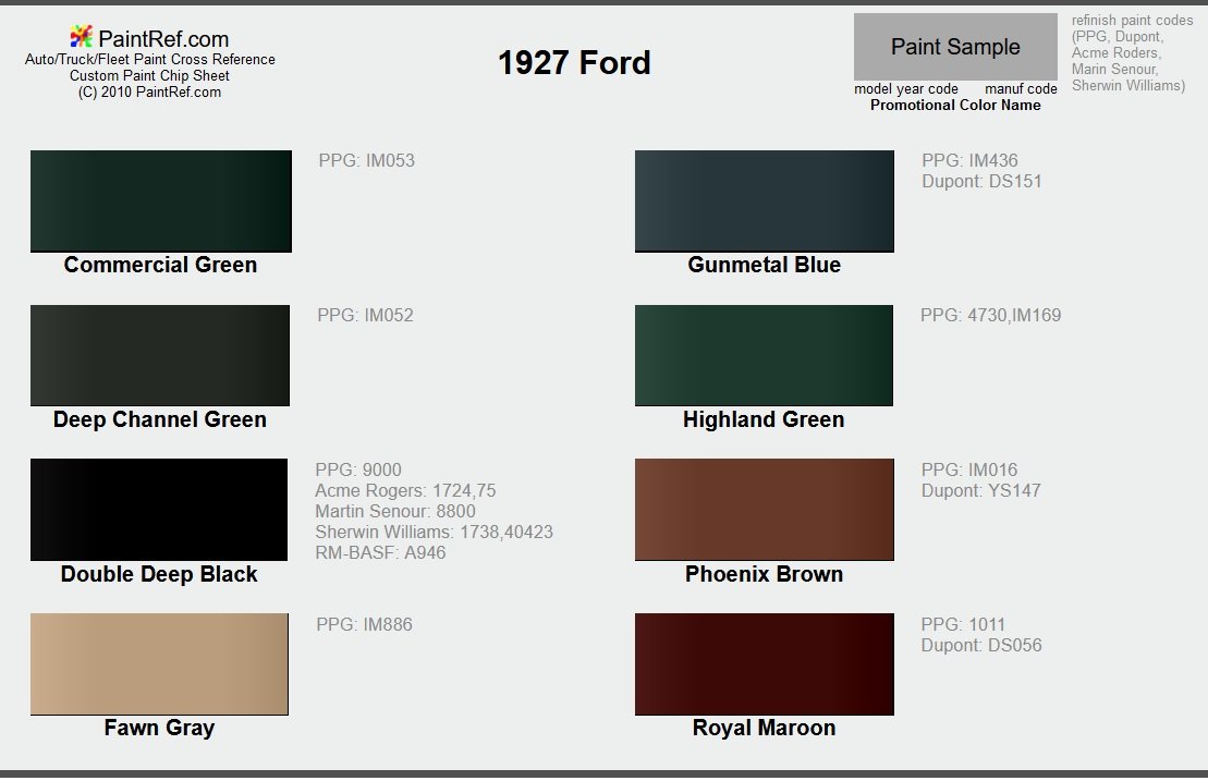

https://mtfca.com/encyclo/P-R.htm
Paint Number Charts follow Not all computer screens display the same, but the comparisons of some of these artist renderings to the color chart can give you an idea of the color. You can then get some actual color chips
http://paintref.com/cgi-bin/colorcodedi ... 730&scomm=

I have no business or any other connection to this company, but they are regulars at Hershey. I inquired about channel green for a '26 coupe and the guy mixed up a sample on the spot. Haven't tried it yet as I still have all body work remaining, but the fact he had that paint in his computer pallet was encouraging to me. jb http://thepaintguyz.com/
- Posts: 7393
Re: Body Paint
Names are inadequate to determine a color. One company's Lime Green is another company's Envy Green. Go by the numbers in the Encyclopedia. You can also have a color mixed to match a sample if you have one. Most paint stores now have the technology to read a sample and match it.

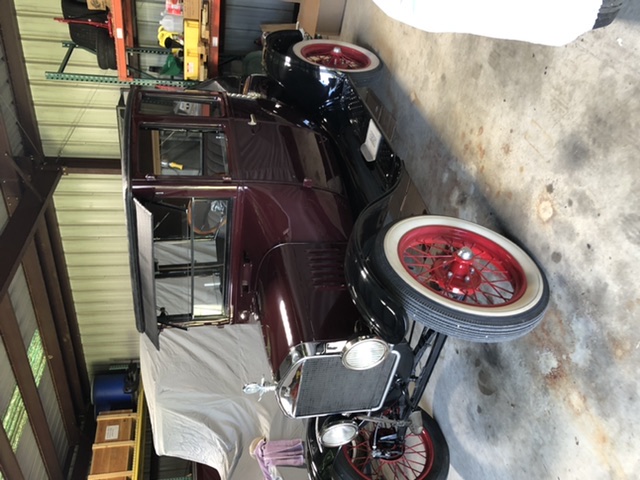

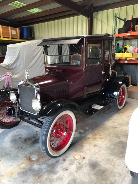

I see that they have used my '26 Touring as an example for Highland Green in the photo above.
That photo was taken for a magazine article highlighting the last years of the Model T. We used a house in the city of Downey as the backdrop. The photographer wasn't familiar with the area, so I drove to "Downtown" Downey, near the intersections of Firestone and Paramount Boulevards. This area was developed in the '20s and '30s. The house fit right in to the era complete with ribbon driveway. Only thing is, most likely the people that could afford a house like that when the house was a few years old probably would have owned a car a little more expensive than a T.

Here is another version of Mike’s picture. It looks better with the rubber side down. Beautiful T! Jim Patrick

Thanks Jim. I have never figured out why some of my photos show up here sideways!
- Posts: 7393
Re: Body Paint
Same here. But for me it only happens occasionally with pictures in a vertical format. When it shows up sideways in Preview I delete it. Then I rotate the original 90º left or right, rotate it back upright, and repost. I don't know why, but that cures the sideways malady.
