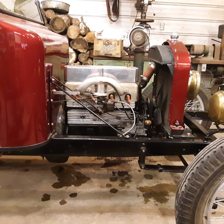

My ‘27 Runabout with a Rajo B, Winfield S-1-BB, and full pressure A crank came to me with a water pump of sufficient capacity with no pump belt, a Three-in-One front plate as seen on pg 132 in “Model T Ford in Speed and Sport”. I was told that the car had no cooling issues during long climbs like Pike’s Peak, and I have observed no cooling issues in my neighborhood of 8% grade hills either.
But for my next build, I plan on using a Matco cross drive under a Bosch ZR4 2 Spark Dual and that appears to conflict with the normal T water pump installations, or maybe not. I have been trying figure out whether or not I have to solve that conflict, and the practical advice given so far is that I should count on having a water pump in my build plans.

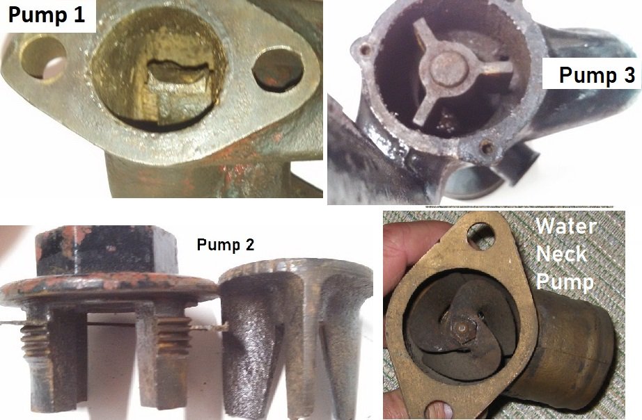

There are "water pumps" and then there a "Model T Water Pumps"
If you look at many of the Model T "water pump" their impeller designs do not incorporate centrifugal force to move fluids. Modern impellers have vanes that flow from the center to the outer edge of a circle. As the impeller rotates, it pulls liquid in at the center, or eye, of the impeller, and the spinning vanes create the centrifugal force that pushes the liquid to the outside of the pump casing, and ultimately out the discharge port.
Model T impellers have blades (like on an old paddle wheel river boat) intended to speed up the flow of the moving coolant. Does a paddle wheeler moving upstream cause the river to flow faster down stream -think not.
Picture a Model T water pump mounted horizontally near the water inlet: the available supply of coolant is whatever passed through the radiator. If there is something slowing down the flow of the coolant to the impeller, the"pump" could not cause the coolant to flow any faster than what is being supplied to it. Also it is doubtful if they have sufficient force to push the coolant into the water jacket, out through the water outlet, up through a hose and into the radiator any more than what is already being cause by thermosiponing.
Model T "water pumps" in the water outlet neck use propellers or impellers. The are being supplied by coolant that was already about to enter the radiator (worthless)

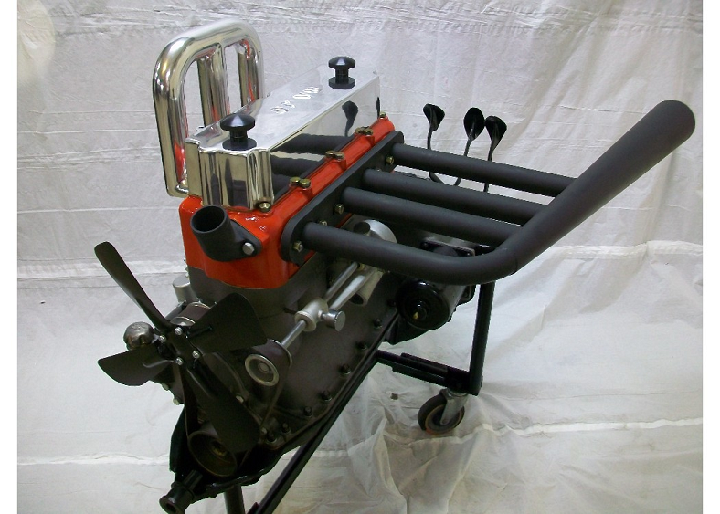

By Mark Chaffin on Monday, January 25, 2010 - 11:01 pm:
Robert,
Because most people we spoke to indicated a desire for a more refined finish on the aluminum accessories, we felt inclined to give them more value for money. ....
Keith,
The water pump is not necessary if the builder is running a new radiator such as those offered by Bergs or The Brassworks.To be honest, it just looks cool having one attached to the engine for visual effect. Most run water pumps to avoid spending the money on a new radiator. Unfortunately, in the end, they end up chucking the water pump and buying a new radiator after all. Do overheads in general require a water pump? No. They really don't if the engine and radiator are functioning properly (IMHO).

Post by ewdysar » Fri Oct 22, 2021 6:25 pm

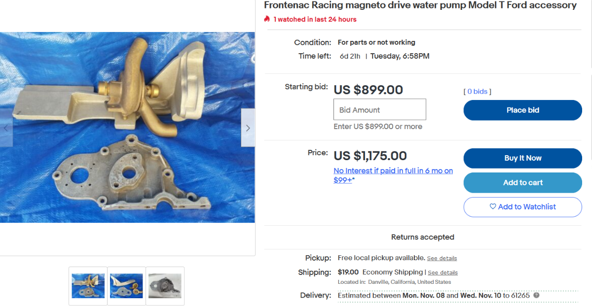

Interesting that Mark said that, and yet all of his promotional photos of complete engines with his Rajo Reproductions BB head that I have seen show mounted water pumps.
I agree that many of the water pumps made for Ts over the years are useless at best, and harmful at worst. But even in period, there were more effective versions available. The water pump portion of the “Three-in-One Oiling System” from the mid-1920s (like on my Runabout) is described as “a gear driven centrifugal water circulating pump, having a capacity of 8 to 10 gallons per minute, as an integral part of the equipment”. In the 1921 Laurel Motors Special Bulletin 19, they stated that their “Centrifugal water circulators will circulate 5 gallons of water every minute, increasing your present circulation from 7 to 10 times as rapid as gravity - gravity being the method of water circulation in a Ford.” If anywhere close to accurate, it would explain why period racing companies like Laurel Motors and Fronty-Ford recommended the Three-in-One, Tri-Unit, Green Triple front plate, water pump-HT magneto mounts, or other centrifugal water pumps in their “build your own race car” instructions. Each of these systems have the water pump closer to the radiator outlet than to the engine inlet.
In the 21st century, of the 2 common belt-driven T water pumps available from our regular vendors (Snyders, Langs, Chaffins) I believe that the traditional looking one is a centrifugal type, the newer “leakless” Texas T Parts pump appears to be an impeller design. I would believe that either of these pumps would be more effective than ones shown in your photos, but I do admit that I have no experience with either one.

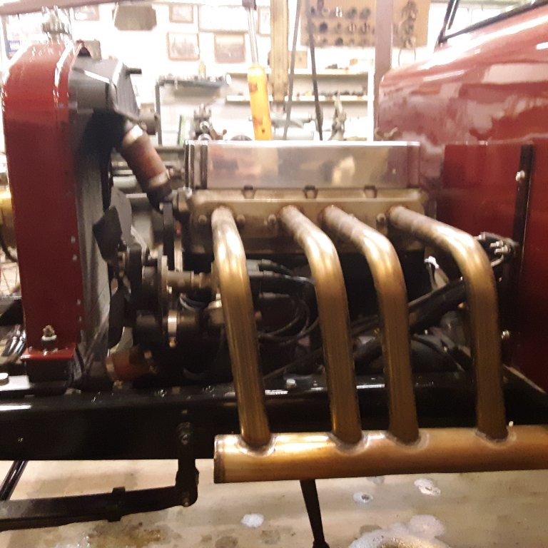

Kevin Pharis
Posts: 1654
First Name: Kevin
Last Name: Pharis
Location: Sacramento CA
Re: How much HP will the thermosiphon handle?
Post by Kevin Pharis » Fri Oct 22, 2021 7:28 pm
I have to agree with Mark’s statement... within limits. Most of the overheads we see in operation these days are commercial or production car oriented, rather than race. These heads were typically advertised with additional water capacity and were intended to be direct replacement with minimal peripheral impact to a stock motor. Sure, they can produce impressive results, but were arguably designed to be relatively low performance. Some of the more obscure, exotic, and performance heads have really crowded and indirect water passages, and no doubt would need water pumps regardless of performance level.
Posts: 8626
Post by TXGOAT2 » Fri Oct 22, 2021 8:41 pm

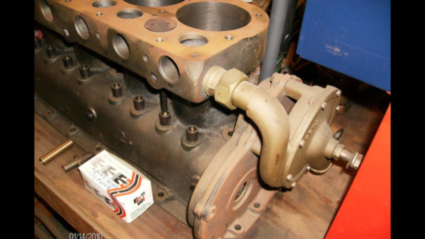

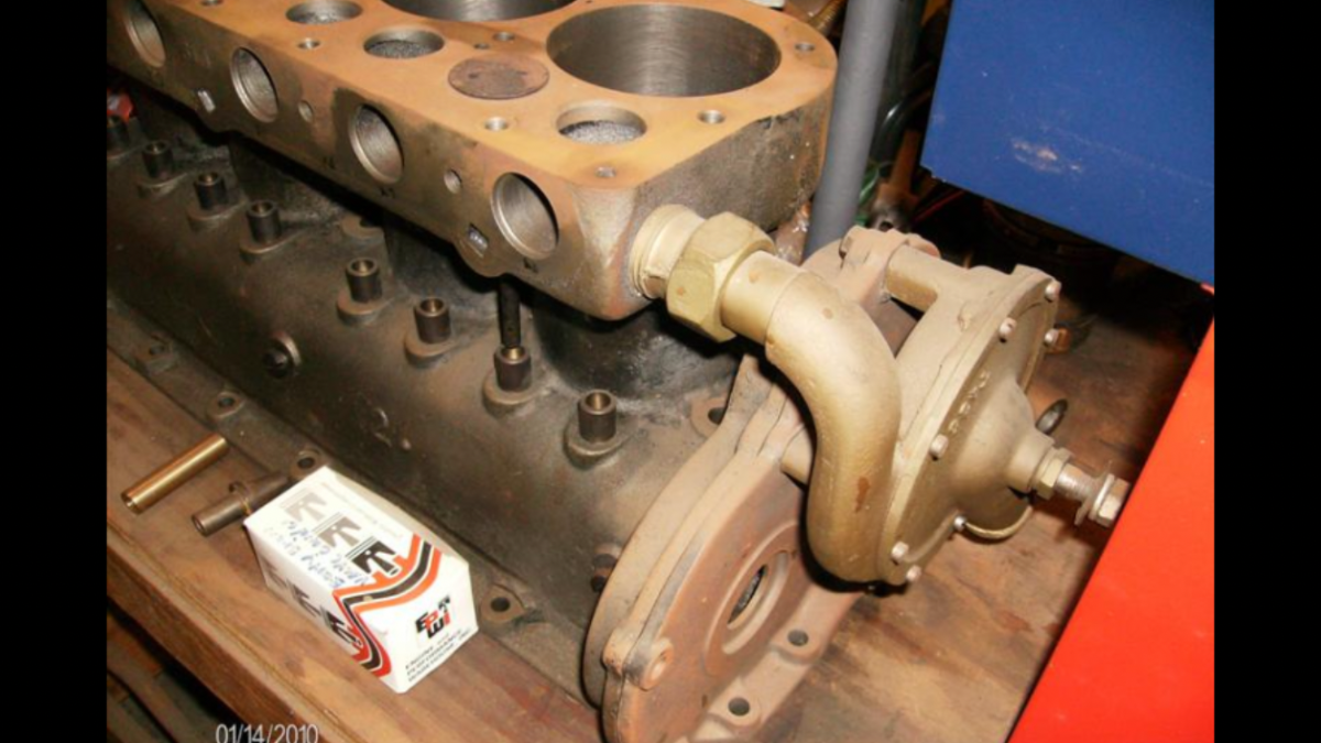

Ford didn't figure out where water pumps ought to be located until 1937. In a proper installation, the pump draws cool water from the radiator outlet and discharges it into the engine's water inlet port(s), which typically enter the lower part of the water jackets. There are good reasons for this.
Kevin Pharis
Posts: 1654
First Name: Kevin
Last Name: Pharis
Post by Kevin Pharis » Fri Oct 22, 2021 9:47 pm
You mean like this...?🤔
Posts: 8626
Post by TXGOAT2 » Fri Oct 22, 2021 10:07 pm
Yep. Compare the early 1930s Ford V8s water pump placement with the later Ford V8 engines with the water pumps located in the block, or the Model A system with most any automotive engine from the mid 1930s on. A stock Model T makes about .09 HP per cubic inch. The Model A makes about .25 HP per cubic inch. Ford added a (half-baked) water pump to the 1928 Model A. As output rose during the 1930s and 40s, from around .25 HP/cubic inch to around .45 HP/cubic inch by around 1950, water pumps, pressure caps, and thermostats became the norm. That suggests to me that the practical limit for specific output on a straight thermosyphon system in an automobile is somewhere around .2 HP per cubic inch for general use.

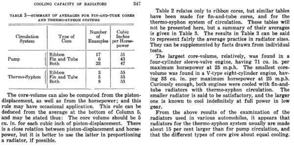

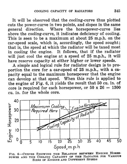

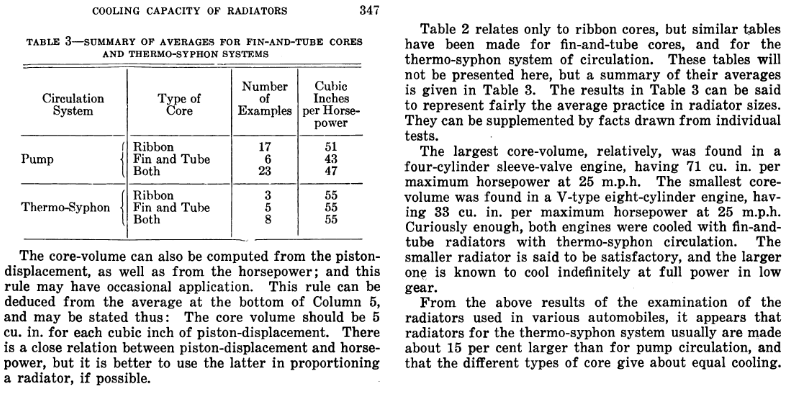

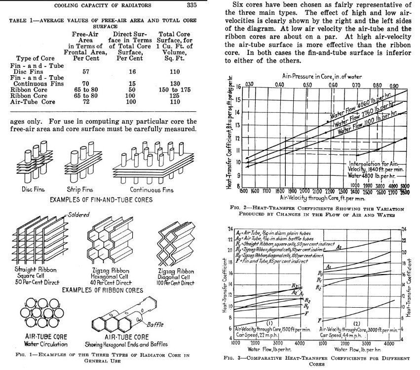

Interesting study performed by the Society of Automotive Engineers "COOLING CAPACITY OF AUTOMOBILE RADIATORS"
Author(s): E H Lockwood Source: SAE Transactions, 1923, https://www.jstor.org/stable/pdf/44723674.pdf
I think this is very applicable as it was performed on the technology of the time and period engines and radiators.

cooling capcity speed.jpg (83.36 KiB) Viewed 13220 times
Basically the study recommends a core value of 50cu.in. per each horsepower. Thermosiphoning radiators are usually 15% larger than pump units. Note no mention of a hybred pump/thermo system

TRDxB2 wrote:
Sun Oct 24, 2021 6:35 pm
Great find, Frank! Real world observations on T era engines. And a specific answer to the question that I started the thread with. And what I infer from table 3 is that the manufacturers of the time were comfortable with almost 30% more horsepower through a given fin and tube radiator core volume with a pump compared to straight thermosiphon.
Keep crankin’
Eric

ewdysar wrote:
Mon Oct 25, 2021 3:28 am
Keep crankin’
Eric
Just a caution. I don't consider period Model T "water pumps" as doing any pumping. Their location is about halfway even with the radiator core and their impeller designs do more to rotate a column of water than to push it through the head. If one was mounted lower at the bottom of the radiator core, then they may be of some use.

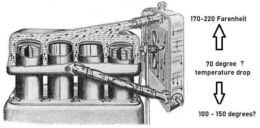

Really it isn’t the thermo siphon principle in question. Thermo siphon is physics, it’s gonna happen if you have sufficient capacity to cool the water in the radiator. So the real question is how much hp can the radiator handle. Like Hank said, in a high performance set up a water pump is used to maintain the temperature to eliminate that variable.
Andy

The thermosyphon system is limited as to the speed and turbulence of the coolant flow, regardless of the radiator size. That limits the RATE at which it can extract heat from an engine.

Thermosyphon systems also require that the top tank on the radiator be placed well above the cylinder head. The system needs vertical height to allow hot water to rise out of the engine water jacket. A system with the upper radiator tank level with the cylinder head will perform very poorly. A system with the upper tank below the level of the head won't work at all.
Posts: 6577
Post by TRDxB2 » Tue Oct 26, 2021 11:00 pm
The real deal!
And there are more of these - for a lot less :?
Posts: 8626
Post by TXGOAT2 » Wed Oct 27, 2021 10:47 am
ALL ORIGINAL SUPER RARE MODEL T HIT OR MISS WATER PUMP! 10 in stock buy it now for only 2999.99!!!

Post by got10carz » Wed Oct 27, 2021 1:34 pm
Here is my setup. Big cam, Chaffin head, Warford with 3.23 gear. Keeps up with modern traffic, no water pump. Only heard it gurgle twice. NEW LOW RADIATOR.

Re: "....no water pump. Only heard it gurgle twice. NEW LOW RADIATOR."
Your low radiator appears to be mounted a good 3" above the stock height.
Posts: 6786
Post by Scott_Conger » Thu Oct 28, 2021 7:01 pm

got10carz
Posts: 600
Joined: Sun Jan 06, 2019 6:37 pm
Last Name: Meixner
* REQUIRED* Type and Year of Model Ts owned: 1911,13,14,19,23,25,26,27
Location: Moorhead MN
Post by got10carz » Thu Oct 28, 2021 7:42 pm
Pat, engine is mounted on Essex frame. Raised for clearance.
Posts: 8626
Post by TXGOAT2 » Thu Oct 28, 2021 7:56 pm
Regardless, higher is better, within reason.
