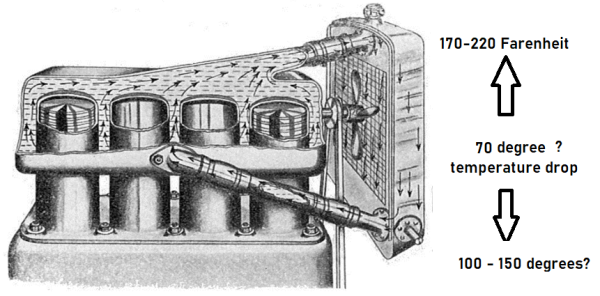

We all know that a well working Ford thermosiphon system will easily dissipate the heat from a stock 20hp T engine. Switching to a new flat tube radiator adds cooling capability that can handle most flathead upgrades like a performance cam, carb, and higher compression, which typically work out to be 30hp or less. Once you get to a overhead valve set-up and the engine can generate 40hp or more, at what point is a water pump or other significant cooling upgrades needed to keep up with the extra heat?
I believe that most Rajo, Fronty, and Gemsa equipped engines have/had waterpumps.
Eric
Eric

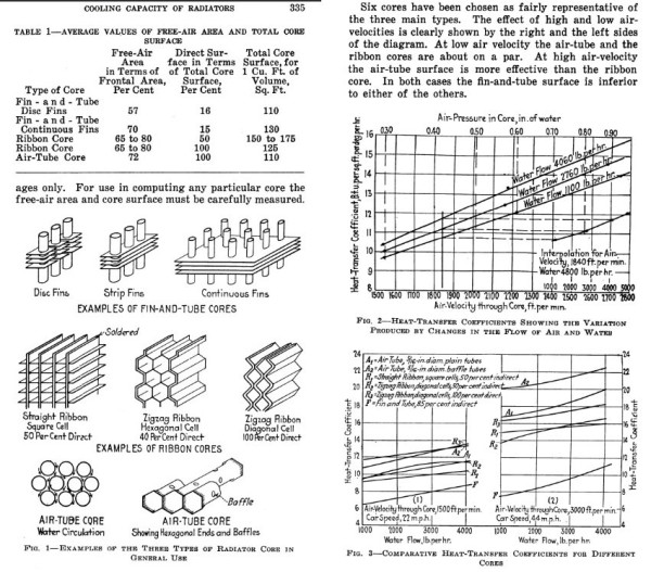

It really isn't a question of thermosyphon versus a water pump. The beauty of thermosyphon is that the more power from the engine? As long as the radiator can handle the heat dissipation, ambient temperatures etc, the faster the thermosyphon will move the water! The limiting factor really is the radiator. Brass era radiators are the smallest. 1917 through 1923 low radiators are better, but still a bit small. The 1924 through 1927 full thickness core radiators are the best for heat dissipation. And as you mentioned, the newer flat tube cores also help.
Honeycomb type radiators can be either better of worse depending upon specific designs and water capacity of the cells. Honeycomb radiators are also much more prone to passage blocking within the cell structures due to rust or hard water. They can be very difficult to clean out if they have been badly plugged.

To properly answer your question if would be helpful to know how much heat your modified engine would be generating in order to ensure that your cooling system (water & oil systems) would effectively maintain a proper operating engine temperature. Most documentation suggest a range between 180 -210 °F. To simplify the thermosiphoning in a Model T, think of maintaining a temperature differential for the system to work. Anti-freeze/coolants are used to keep the coolant from freezing and/or to raise the boiling point of the coolant, but don't have a direct effect on keeping the coolant in the proper operating range - that is the job of the water & oil cooling systems.
Several older discussions have noted that their water cooling system were working properly when there was between a 30-90 °F temperature difference between the coolant entering the radiator and that exiting https://mtfca.com/phpBB3/viewtopic.php?t=4644. The cooling capacity of a radiator is dependent one many factors - air flow through it being a major contributor. You might consider an electric fan...
So the answer to your question depends on how well your cooling system is designed to can keep engine temperatures in range. A water pump isn't always an answer either, if the system can't cool the fluid it would just be passing the hot coolant.
Note: To cold coolant into a hot engine isn't good either.

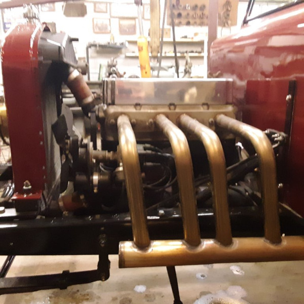

More specifically, in my planned build of a engine with a Chaffin Rajo head, Scat crank with full oil pressure, Bosch dual plug ZR4 mag, dual Zenith SB4F carbs, and a flat (not vee) radiator, should I plan for a water pump too?

Perhaps true, but not really what we’re discussing. Since this problem has been solved many times before and not wanting to re-invent the wheel, I’m looking for the voices of experience to share what has worked and what hasn’t.TXGOAT2 wrote: ↑Fri Oct 22, 2021 2:16 pmIdeally, a hot rod T would have a water pump that pushed water into the water jacket inlet, a thermostat with bypass, and a radiator of adequate capacity that could be run with a 13 lb pressure cap. A water pump of sufficient capacity would probably require a v-belt or modern type belt drive. About 1,000,000 variables would impact exactly what the ideal setup for any particular build would be.
My ‘27 Runabout with a Rajo B, Winfield S-1-BB, and full pressure A crank came to me with a water pump of sufficient capacity with no pump belt, a Three-in-One front plate as seen on pg 132 in “Model T Ford in Speed and Sport”. I was told that the car had no cooling issues during long climbs like Pike’s Peak, and I have observed no cooling issues in my neighborhood of 8% grade hills either.
But for my next build, I plan on using a Matco cross drive under a Bosch ZR4 2 Spark Dual and that appears to conflict with the normal T water pump installations, or maybe not. I have been trying figure out whether or not I have to solve that conflict, and the practical advice given so far is that I should count on having a water pump in my build plans.
Eric

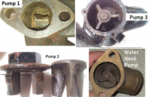

There are "water pumps" and then there a "Model T Water Pumps"
If you look at many of the Model T "water pump" their impeller designs do not incorporate centrifugal force to move fluids. Modern impellers have vanes that flow from the center to the outer edge of a circle. As the impeller rotates, it pulls liquid in at the center, or eye, of the impeller, and the spinning vanes create the centrifugal force that pushes the liquid to the outside of the pump casing, and ultimately out the discharge port.
Model T impellers have blades (like on an old paddle wheel river boat) intended to speed up the flow of the moving coolant. Does a paddle wheeler moving upstream cause the river to flow faster down stream -think not.
Picture a Model T water pump mounted horizontally near the water inlet: the available supply of coolant is whatever passed through the radiator. If there is something slowing down the flow of the coolant to the impeller, the"pump" could not cause the coolant to flow any faster than what is being supplied to it. Also it is doubtful if they have sufficient force to push the coolant into the water jacket, out through the water outlet, up through a hose and into the radiator any more than what is already being cause by thermosiponing.
Model T "water pumps" in the water outlet neck use propellers or impellers. The are being supplied by coolant that was already about to enter the radiator (worthless)
From a past discussion. http://www.mtfca.com/discus/messages/11 ... 1272732078
By Mark Chaffin on Monday, January 25, 2010 - 11:01 pm:
Robert,
Because most people we spoke to indicated a desire for a more refined finish on the aluminum accessories, we felt inclined to give them more value for money. ....
Keith,
The water pump is not necessary if the builder is running a new radiator such as those offered by Bergs or The Brassworks.To be honest, it just looks cool having one attached to the engine for visual effect. Most run water pumps to avoid spending the money on a new radiator. Unfortunately, in the end, they end up chucking the water pump and buying a new radiator after all. Do overheads in general require a water pump? No. They really don't if the engine and radiator are functioning properly (IMHO).
Robert,
Keith,

Interesting that Mark said that, and yet all of his promotional photos of complete engines with his Rajo Reproductions BB head that I have seen show mounted water pumps.
I agree that many of the water pumps made for Ts over the years are useless at best, and harmful at worst. But even in period, there were more effective versions available. The water pump portion of the “Three-in-One Oiling System” from the mid-1920s (like on my Runabout) is described as “a gear driven centrifugal water circulating pump, having a capacity of 8 to 10 gallons per minute, as an integral part of the equipment”. In the 1921 Laurel Motors Special Bulletin 19, they stated that their “Centrifugal water circulators will circulate 5 gallons of water every minute, increasing your present circulation from 7 to 10 times as rapid as gravity - gravity being the method of water circulation in a Ford.” If anywhere close to accurate, it would explain why period racing companies like Laurel Motors and Fronty-Ford recommended the Three-in-One, Tri-Unit, Green Triple front plate, water pump-HT magneto mounts, or other centrifugal water pumps in their “build your own race car” instructions. Each of these systems have the water pump closer to the radiator outlet than to the engine inlet.
In the 21st century, of the 2 common belt-driven T water pumps available from our regular vendors (Snyders, Langs, Chaffins) I believe that the traditional looking one is a centrifugal type, the newer “leakless” Texas T Parts pump appears to be an impeller design. I would believe that either of these pumps would be more effective than ones shown in your photos, but I do admit that I have no experience with either one.
Eric
Eric

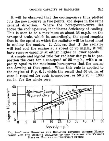

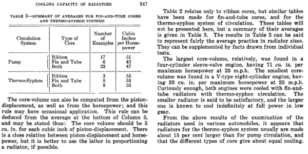

Interesting study performed by the Society of Automotive Engineers "COOLING CAPACITY OF AUTOMOBILE RADIATORS"
Author(s): E H Lockwood Source: SAE Transactions, 1923, https://www.jstor.org/stable/pdf/44723674.pdf
I think this is very applicable as it was performed on the technology of the time and period engines and radiators. Basically the study recommends a core value of 50cu.in. per each horsepower. Thermosiphoning radiators are usually 15% larger than pump units. Note no mention of a hybred pump/thermo system

Great find, Frank! Real world observations on T era engines. And a specific answer to the question that I started the thread with. And what I infer from table 3 is that the manufacturers of the time were comfortable with almost 30% more horsepower through a given fin and tube radiator core volume with a pump compared to straight thermosiphon.TRDxB2 wrote: ↑Sun Oct 24, 2021 6:35 pmInteresting study performed by the Society of Automotive Engineers "COOLING CAPACITY OF AUTOMOBILE RADIATORS"

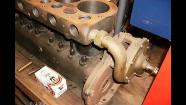

I run a large shaft "water circulator" on my BB RAJO Racer - water pump is a bit of a misnomer as the T's system in non-pressurized.

Just a caution. I don't consider period Model T "water pumps" as doing any pumping. Their location is about halfway even with the radiator core and their impeller designs do more to rotate a column of water than to push it through the head. If one was mounted lower at the bottom of the radiator core, then they may be of some use.ewdysar wrote: ↑Mon Oct 25, 2021 3:28 amGreat find, Frank! Real world observations on T era engines. And a specific answer to the question that I started the thread with. And what I infer from table 3 is that the manufacturers of the time were comfortable with almost 30% more horsepower through a given fin and tube radiator core volume with a pump compared to straight thermosiphon.TRDxB2 wrote: ↑Sun Oct 24, 2021 6:35 pmInteresting study performed by the Society of Automotive Engineers "COOLING CAPACITY OF AUTOMOBILE RADIATORS"

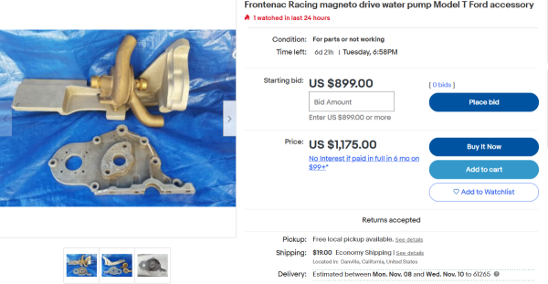

- Posts: 7391
Re: How much HP will the thermosiphon handle?
ALL ORIGINAL SUPER RARE MODEL T HIT OR MISS WATER PUMP! 10 in stock buy it now for only 2999.99!!!

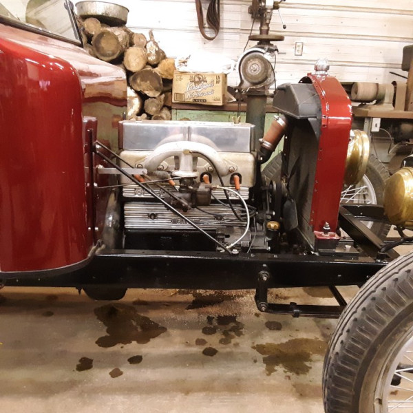

Here is my setup. Big cam, Chaffin head, Warford with 3.23 gear. Keeps up with modern traffic, no water pump. Only heard it gurgle twice. NEW LOW RADIATOR.

Re: "....no water pump. Only heard it gurgle twice. NEW LOW RADIATOR."
Your low radiator appears to be mounted a good 3" above the stock height.
- Posts: 6523
some sort of a custom body...
- Posts: 552
- Joined: Sun Jan 06, 2019 6:37 pm
- Last Name: Meixner
- * REQUIRED* Type and Year of Model Ts owned: 1911,13,14,19,23,25,26,27
- Location: Moorhead MN
Pat, engine is mounted on Essex frame. Raised for clearance.
- Posts: 7391
Regardless, higher is better, within reason.
