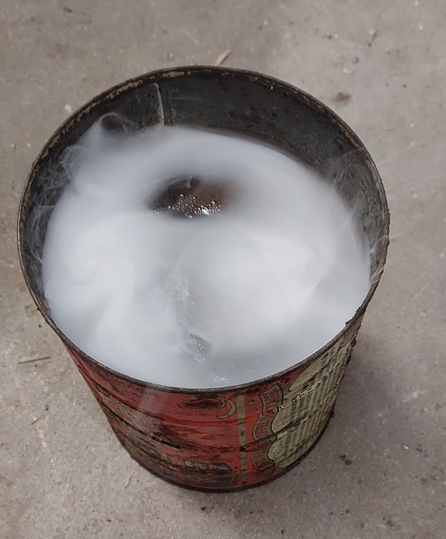

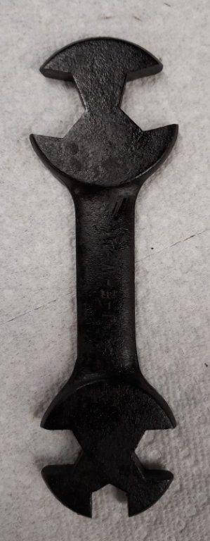

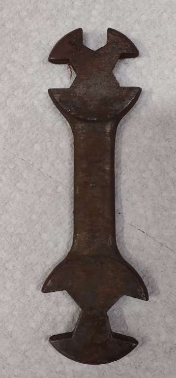

This was a fun experiment. I took a rusty wrench, lightly went after loose rust with a wire brush, heated it with a rosebud torch until it turned a dark red color, immersed it in engine oil, and success, rust gone and a nice black finish.

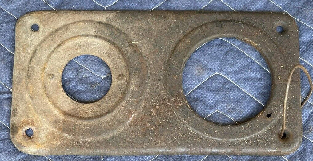

I usually soak parts of a 1/2hour or up to 24hrs depends on thickness of rust. Cleaning grease and old paint will prolong the use of the product. I use a variety of methods to de-rust (except sandblast). Evapo-Rust when I want to preserve paint, a dissolver, reformer or electrolysis tank . This is an example of using Krud Kutter Rust Remover soaked for 24 hrs (they also have a spray). Just before I pulled it out you could actually see an impression of the plate made by the rust scale floating on top, wish I took a picture. So it wasn't cleaned before, wouldn't come off. I did need to wire brush the soft black residue after I took it out to get what you see. I did that 3 days ago, picture was taken Today.
