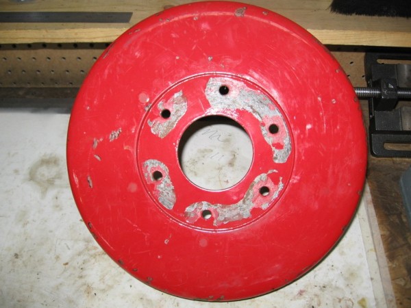

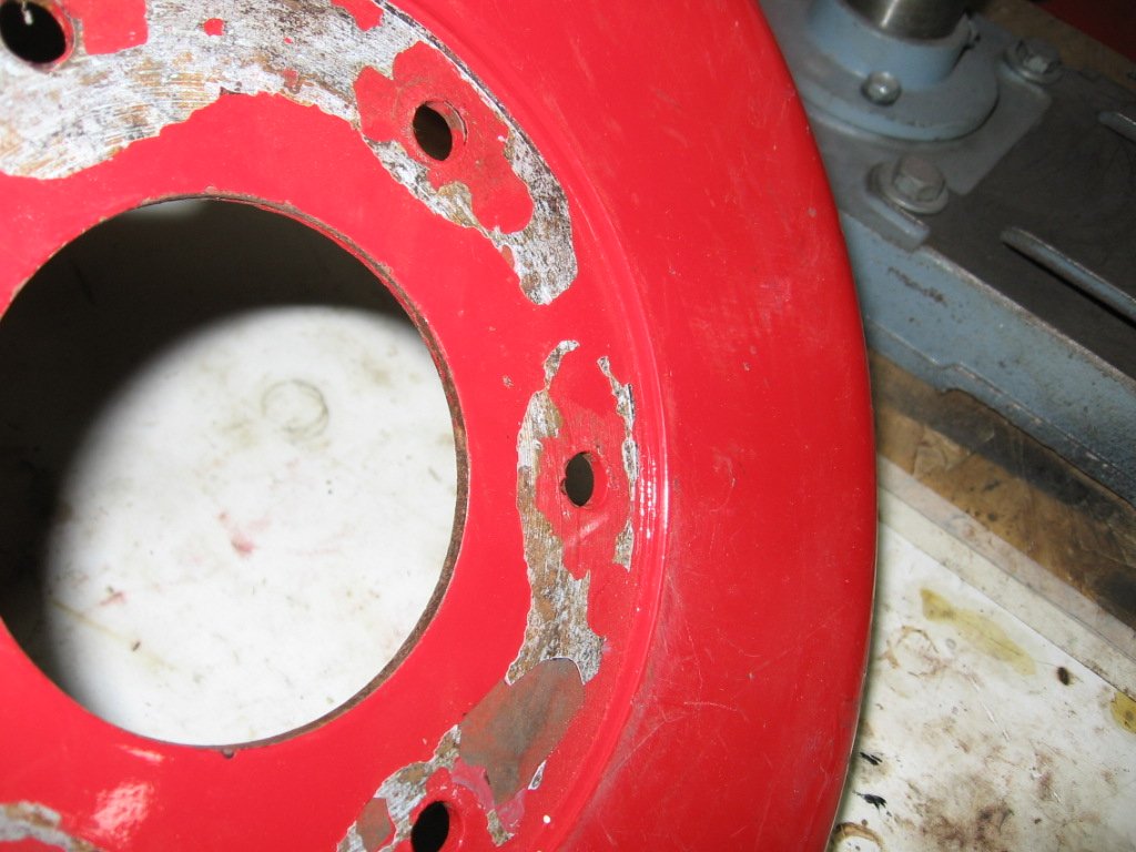

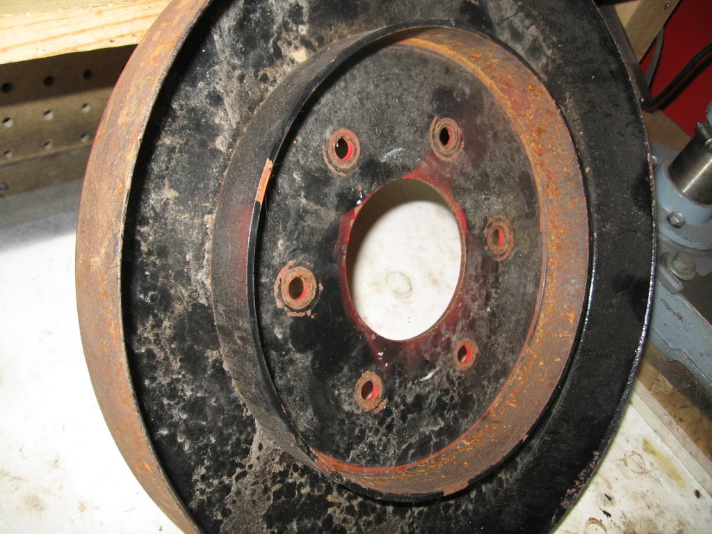

Here are some pictures of my RM drums, they are stamped and riveted like Larry described.
I have since removed the hideous red paint and painted them black. :)

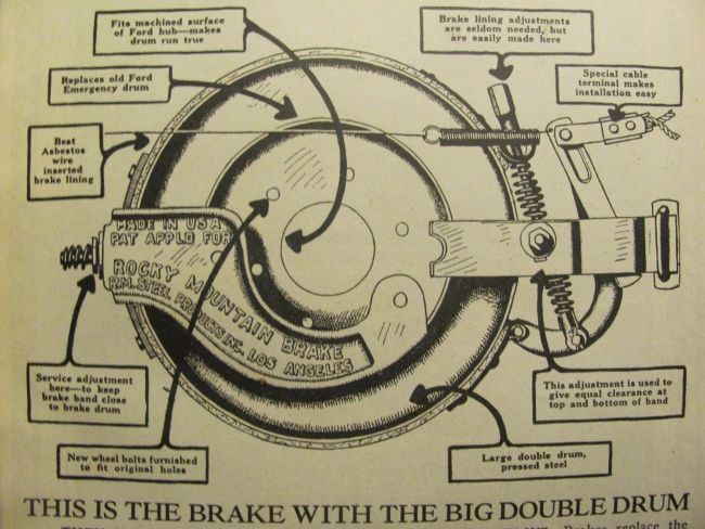

Original R-M adv. stating the large double drum is pressed steel.

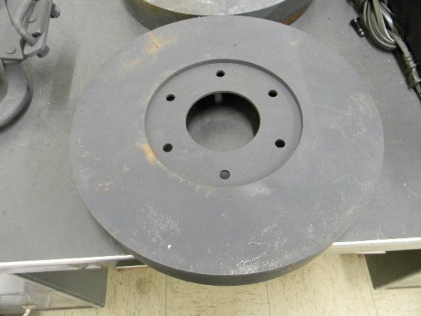

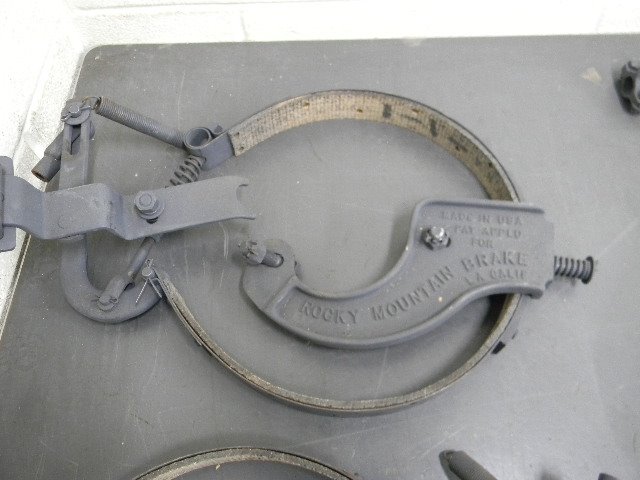

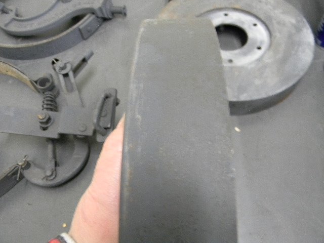

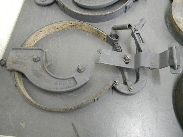

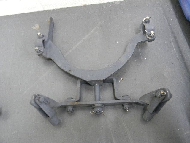

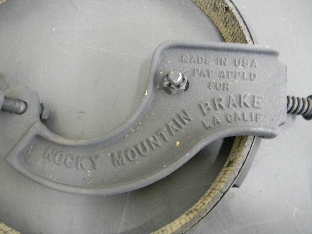

This is the set I just got in with the collection of cars
they might be new but wish they were original let you judge
drums are 1 pc cast
Bob

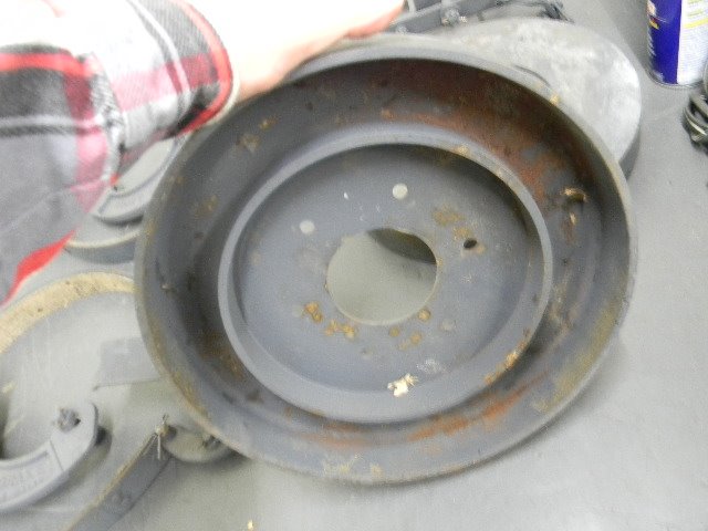

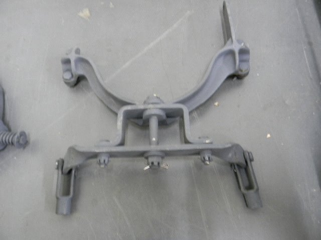

more pics
Posts: 4045
Re: Rocky mountain brake question
Post by DanTreace » Mon Mar 25, 2019 10:02 am
Bob
That set is the older reproduction of the Rocky Mountain, made in the 60's I think. Real nice repro.
If you read the detail caption on the right hand side of this instruction sheet that came with these reproduction, states the drum is machined from cast ductile iron. Those are a desirable set of rear brakes for the small drum T axle!

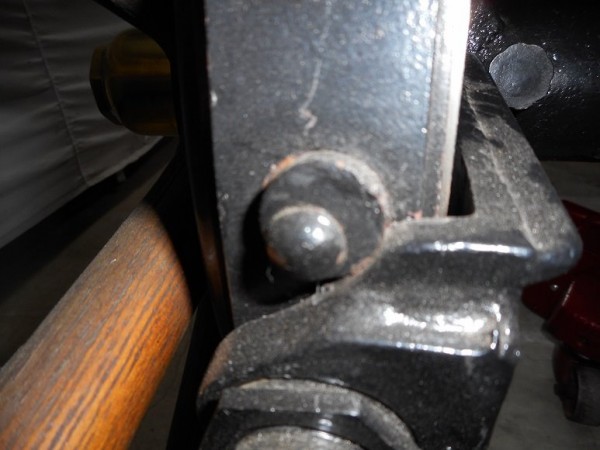

Here is the band adjusting cam used on real Rocky Mountain brakes, and is important for alignment.
Posts: 3909
Location: Lomita, California
Post by Original Smith » Mon Mar 25, 2019 10:20 am
Look closely at the photo Dan posted of an original ad. They say Rocky Mountain Steel Products, L.A. The first series reproductions don't say that. Each band has two cams riveted to the band. If someone was serious about installing them, they could be made. Everything from the rear end to the front is Bennett, and were not designed to work with a true Rocky Mountain brake.
