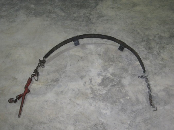

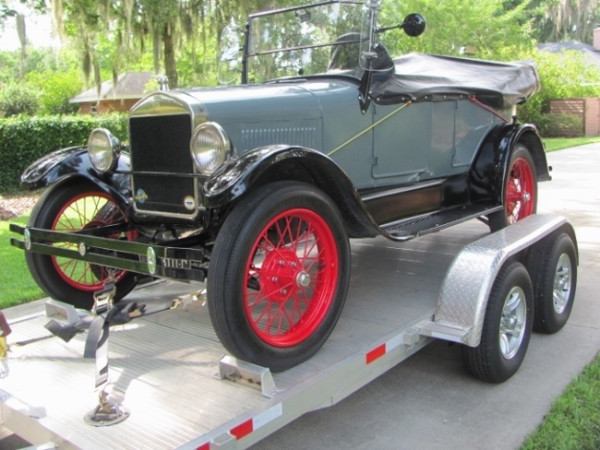

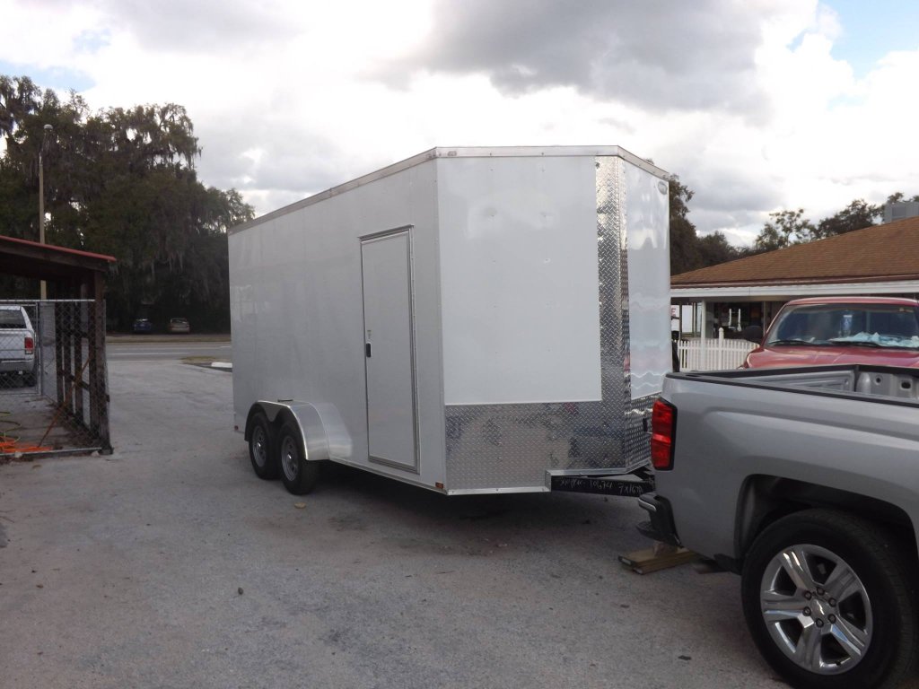

Like oil and electronic timers, you'll get many responses and ideas. Here's what works for me. I actually use 2 of the heavy yellow straps. This was old pictures when I lost one! Hauled cars like this thousands of miles with no problems. The rear axle I just use two straps straight back. Chock the wheels, set the brake, pull the key!
Posts: 3743
Last Name: Wrenn
Re: How Tiedown a Model T to Trailer
Post by TWrenn » Fri Oct 29, 2021 11:25 am
Sorry for double pics. Crazy phone!

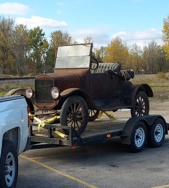

I once saw a nice 1912 with its windshield wrecked by being hauled on an open trailer at freeway speeds. There is no law requiring me to drive fast. So when hauling a T on my little trailer I observe a 55 mph speed limit. This makes wind damage very unlikely and keeps my gas hog Suburban's mileage from descending into single digits.

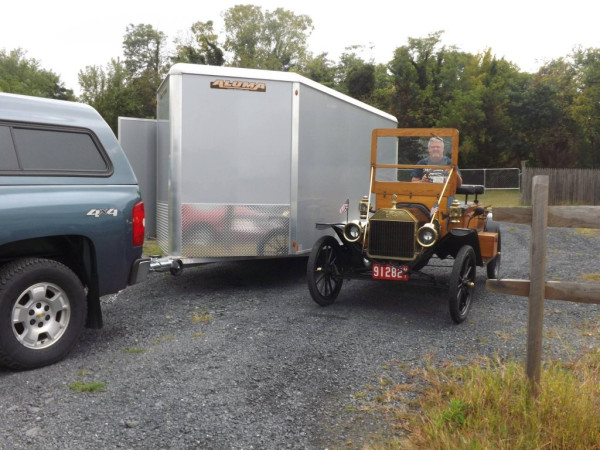

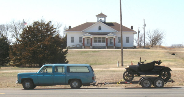

I am content to trailer with long straps used with short axle straps, I cross strap front to rear. My 2 enclosed cargo trailers have had floor pockets installed. By cross strapping front to back I am not pulling the front axle & wishbone out of the "socket" in the oil pan. Straps are tight, but not over tight so as to not pull extremely hard on the axles. This trailer is a 2016 Alumia 7x14 cargo extra height for clearance of the windshield of our open express. I have another enclosed trailer that goes from New York to Florida in the wintertime, that is a 7x16 Snapper extra height also, half the quality at half the price but it works. That being the white trailer & the Homemade pickup we cruise Florida with. I also have an open trailer that we have used to trailer with, have gone as far as Central NY to Virginia, less drag to tow with but a pain as everything that can get loose needs to be secured or removed & placed in the back of the truck, when needed we cross strap front to rear also. George

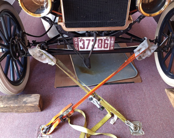

Haul on open trailer a lot. But had cover made to fit over the open car compartment, covering the top boot too. If your top is folded down, consider adding a top boot, or at min. several bungee cords to restrain that top cover from becoming a parachute behind you!
Same deal with straps, I cross them, on the axles, front and rear, for side control. Like to let the T's springs provide some cushion to the car along with the trailer's torsion axles. Anchors at front wheels, and brake on and key out!
