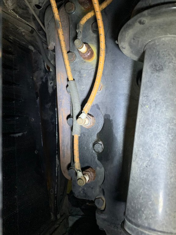

I have an unmarked High compression head, thought it was a late 26 head till I pulled the engine down and found the inside casting looks like Pruis's head inside? I did not notice at first there was no wells around the plugs, been running it for years and love it!
IRON HEAD?!?!?! :o Fantastic if so. Now I gotta turn over ever 27 looking head looking for a sleeper!

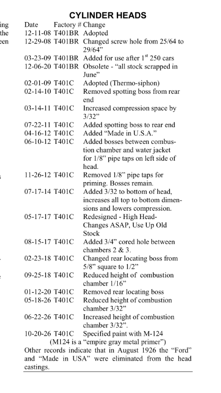

According to Bruce’s research, combustion area of Non-script high heads are the same as all the other script high heads made after 9/25/18, except for about 1 month (of script heads) in ‘26 when the compression was raised then lowered again. You have to cc a head to know for sure, but odds are fairly slim to run into one unless the production date of your car falls in that range and it still has its original head.
Here is the correct info:

Thanks Adam. Looks like the change only was in place for a few weeks. A very slight increase in compression, then back to same.

Interesting. 26 compression increase, then 1 month later a decrease? Confusion. Do I frantically search for this very limited head? Is it a corrected mistaken notation? Was I 1/2 right repeating a wives tale? Is this Joe's head? Why was there a need for the vaporizer without the added compression loss? Fantastic piece of documentation. Thanks for the clarification? :?

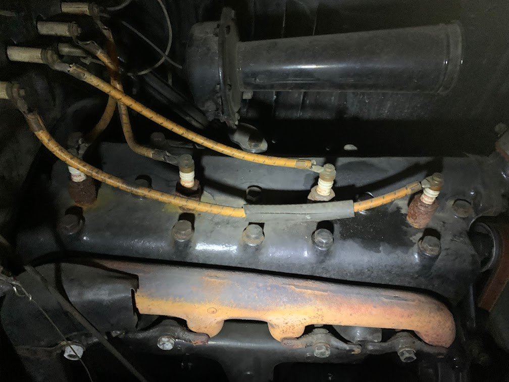

Here is a picture of the head that I have been running for years

Sooo. I have to look for the illusive hi compression head. AND, CC every non script head virgin head I can to confirm they are the same compression.as earlier heads to disprove the myth for myself. THANKS A LOT. Another Pandora's box!
Thanks for the pix Joe. Are you sure it is an uncut virgin? This new info has rocked my religion. :o

I had to mill it to clean it up and address for the bigger intake valves and 280 cam, valves touched side of head.
