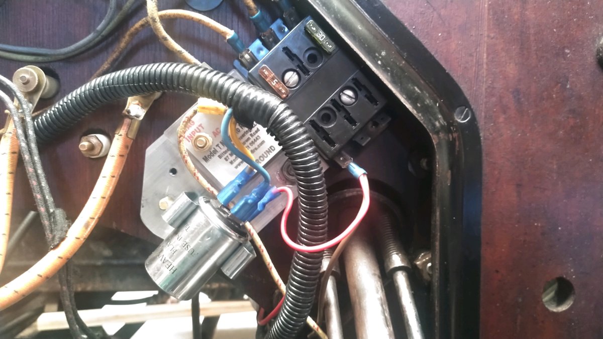

I'm using this on the 6 Volt '13
https://www.snydersantiqueauto.com/prod ... 82457&cat=
here is it installed in the Car..
The Car already had been converted with 6 Volt Turn Sig, but no Charging or fuses.. So I was able to add a few things I thought were necessary..
Tail lights..
https://www.ledlight.com/g18-s25-6-12v- ... arity.aspx
and somewhere in there is the Model T/A Led Headlights.. 6V..
Found them..
https://www.ledlight.com/1142-miniature ... 0-smd.aspx

Would it be practical to build a device that would rectify mag output and regulate it so as to be suitable for battery charging and operating 6 or 12 volt lights, etc? I have a wind turbine outfit that produces 3 phase AC current. The voltage, amperage, and frequency vary with the turbine speed from very low up to around 4300 watts at 340 volts. The raw output is first rectified to DC and then processed to single phase AC at a regulated 240 volts at 60 cycles. Only the current then varies with wind speed, from very low up to about 4200 watts. Voltage and frequency are held to spec. Each phase of the wind turbine has about the same general electrical characteristics as the Model T magneto, and the drive speed varies widely, just like the model T engine speed. The turbine alternator has a permanent magnet rotor, like a T magneto, and multiple poles/windings which I believe are in series.

Part # T-5165-6 | Model Year 09-27Cap wrote: ↑Sun Oct 31, 2021 10:27 amI'm using this on the 6 Volt '13
Tail lights..
Found them..
Cap
"Finally a way for you guys with early non-starter T's to be able to charge your hot-shot or accessory battery. Charges battery with current supplied from the magneto post. Not recommended for use with original style ignitions/coils. Limited supply of these 6-volt units available. U.S.A."
Interesting disclaimer. The perfect product not recommended with a stock ignition/coils.

Re: Magneto to charge battery
Interesting..I've missed that disclaimer..
I am running an E Timer on this car, so it's always on battery.. I reconfigured the wiring in the battery box to be battery on both sides of the switch..
I'd like to see the waveform out of the mag with the 'device' and without to see what might be the issue..
I understand the "hot Shot" charger does not have this limitation..
Cap

I did the same setup on a 15 motor in a 24, charging an 8V battery. Same numbers. This one has only a few miles so far.
I am a bit confused with this bulb numbers, so I googled for 1157 bulb. What I could find out is: This number only tells the bulb socket. 1156 bulb is one filament (one contact at bottom of bulb), 1157 is two filaments (two contacts at bottom of bulb). But it does not say anything about bulb wattage and voltage. This should be stamped into the metal socket right below the glass bulb.
Anyway, what I also googled was the approximate voltage generated by Magneto. What I found matches well what you measured. Somewhere between 29-35V at higher engine rpm.
So let's do a little math:
Magneto supplies 35V (worst case), the battery has 6V. Because the voltage of battery is almost stable (5.6V ... 6.7V). the voltage difference (mag - battery) is approx. 29V max. to be consumed by the bulb.
Using a two filament 12V bulb:
Of course, using a 12V bulb with only one filament will not work, it will immediately burn out. This also explains to my why bulbs with two filaments are used. If you connect only to the contacts at bottom side of bulb, you actually have both filaments connected in series to each other. This is no lucky choice because filaments are for different power 21W and 8W, therefore dividing the voltage in ratio 3:1 in this case. So the weaker filament will get a much higher voltage of approx. 20V, while the stronger one will get only 8V. So the 8W filament will be extremely overloaded (be shining extremely bright). I guess it only survives because nobody will run the engine very long at high rpm (so the voltage is less than 29V).
What I (will) do is:
Instead of using a normal 1157 car bulb for 12V with 21+8 Watts, I (will) use a 1156 bulb for trucks. This bulb is for 24V and has only one filament with 21W. At 24V it will draw approx. 0.9A, so it will be about 1A on 29V. So the result is better, I do not overload one filament (of two) so much. The bulb should live much longer.
I will keep you updated in how this 24V bulb will work.
