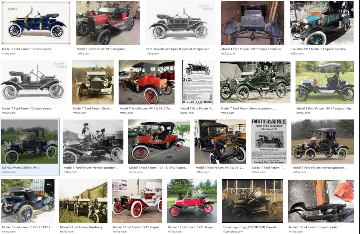

and there are Torpedo's https://www.google.com/search?q=torpedo ... zCQDjj-0nM
