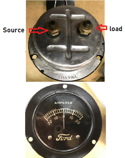

An ammeter typically measures the amount of current flow from the device being measured connected in series to a current load placed upon it. It is not a grounded device per se. For it to work properly the connections to it must be attached in the direction of current flow. Having said that, we normally associate current flow from negative to positive, however in the case of a Model T the ammeter is measuring the load from the positive output of the generator to the positive connection to the battery and the load placed upon that circuit. It can be assumed that the terminals in the back of the ammeter correspond to the direction of the current flow. So rather than refer to positive and negative think about the current source to the load when wiring and "assume" that the connections in the back correspond the the meter scale on the front. Remember the ammeters, vintage or repro, are "indicators" and not "scientific instruments" measuring current flow.
Even though there are different types of ammeters the basic connections and purpose are the same.

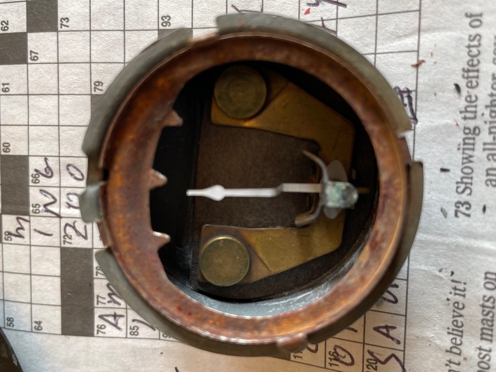

There is no electrical coil as such in my ammeter, just a flat u-shaped brass conductor between the terminals. There is a short football-shaped piece at the bottom of the indicator needle shaft that I assume is magnetized like a compass needle, which tends to align itself with the magnetic field around the brass conductor. There is a hair spring that returns the indicator to zero when there’s no current flowing.
Miles

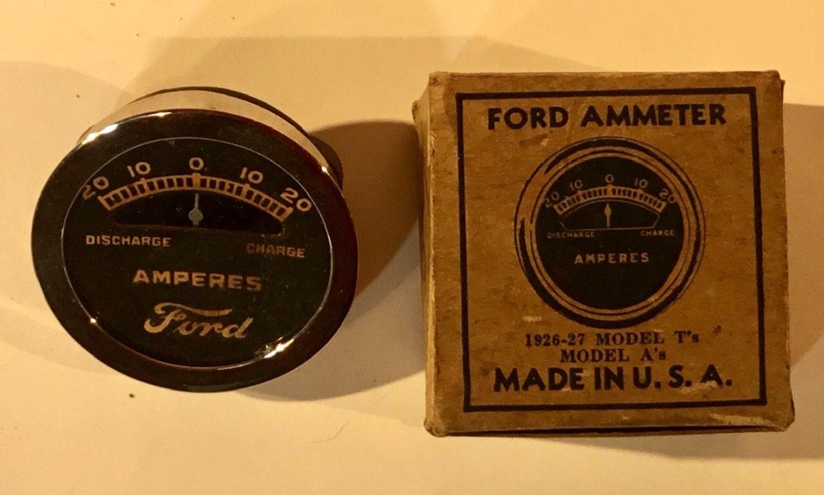

Here is an original 1926-‘27 Ford ammeter with the proper bright nickel plated escutcheon plate in the original box that I will be posting on EBay tonight for anyone who wants to try out an original Ford ammeter, or just put it on display. Jim Patrick

The last one I saw on Ebay similar to that one sold for $125.
T bezel was brass and not shiny like that one.
Hoyt made it.
I still have it in the box.
