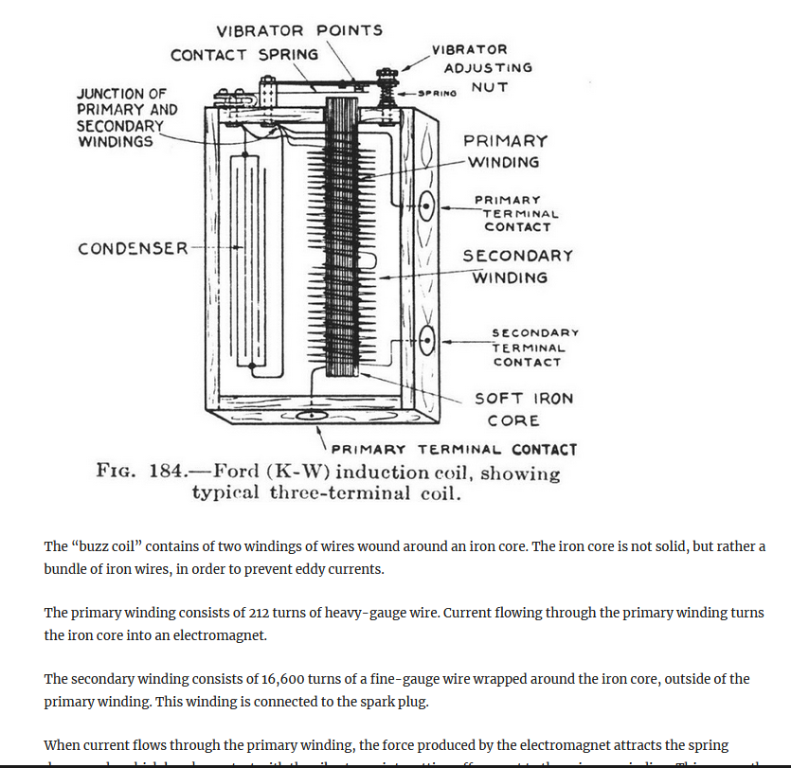

Here is some information more info here than picture https://commons.princeton.edu/josephhen ... and-break/

16,600 to 212. Excellent! I hadn't found that spec before. Appreciate the help. Has anyone measured the wire diameter of the "heavy-gauge wire" or the " fine-gauge wire"?

That article also indicates the frequency of the points oscillation is about 200 Hz. Also good info. Thanks!

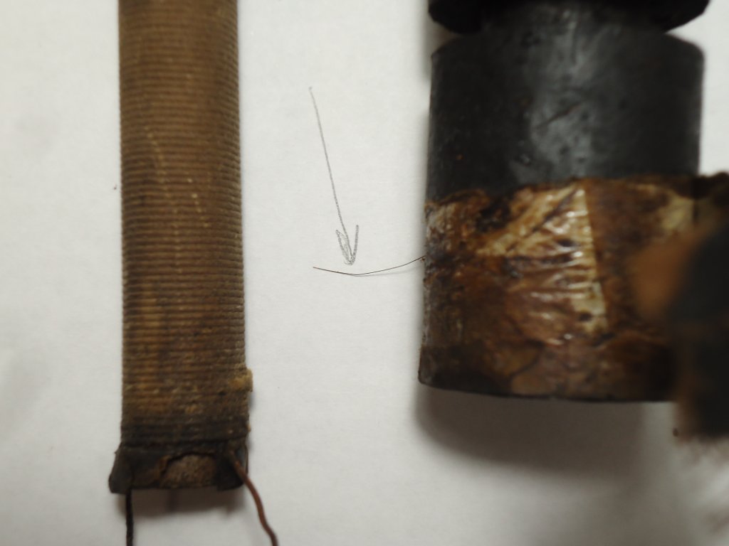

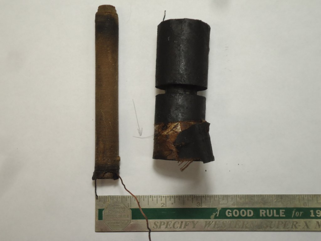

Took some measurements from some scrap coil pieces. The primary (heavy) wire is cotton covered the copper measures 0.034" dia. which is 20 AWG.
The secondary winding is enamel magnet wire which measures 0.002" dia. likely 44 AWG. (The arrow points to the end of the very fine secondary winding)
The iron core that the primary is wound around appears to be made of a bundle of 0.029" dia. iron wire. Overall the iron core is nominally 1/2" diameter and there is a layer of paper between the core and primary winding. As shown in the photo it is possible to remove the iron core and primary winding from the secondary coils.

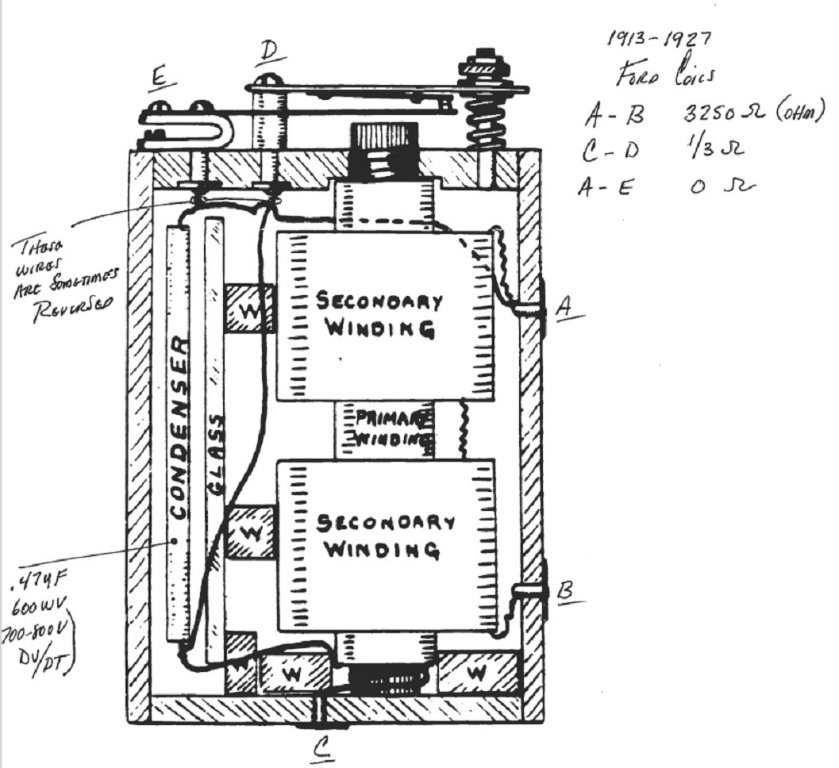

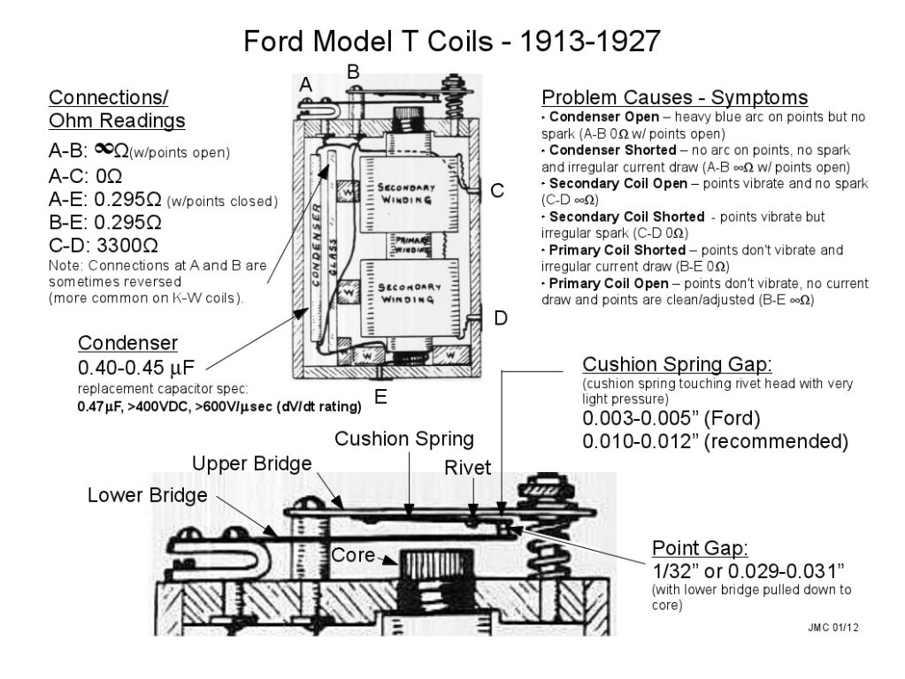

One other important dimension I notice missing in the diagrams posted here is the core height off the coil box wood deck. The top of the core should be 1/4 inch off the flat wood service. This core is commonly shifted. This is important for coil rebuilders who must adjust point geometry to obtain proper coil operation. If you look closely at the coils wood box construction and assembly process you will notice counter bores on the wood top and shims at the base of the Primary winding for ease of positioning internal coil components parts prior to potting the wood box.
