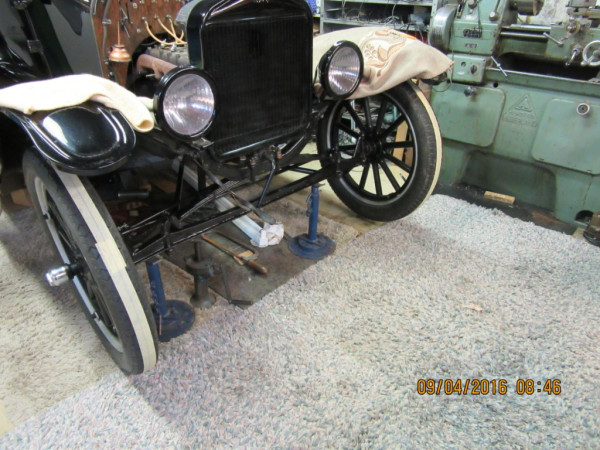

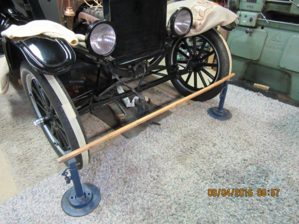

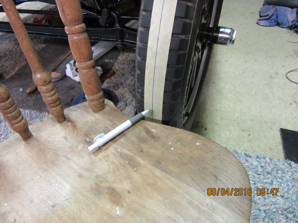

I do it a little differed
Toon

ABoer wrote:
Thu Nov 04, 2021 3:44 am
I believe your method or minor variations are the most accurate way to go.
Wheel center height front & back, mark tires.
I mark the tires front & roll back 1/2 revolution.

Toon, I like your way. What measurement we need to have?

I agree with Anthony's method. If front linkage is in good condition, I recommend 1/32 to 1/4 inch toe in. Keep in mind that one turn on the tie rod changes the toe in by about .22 inches.
