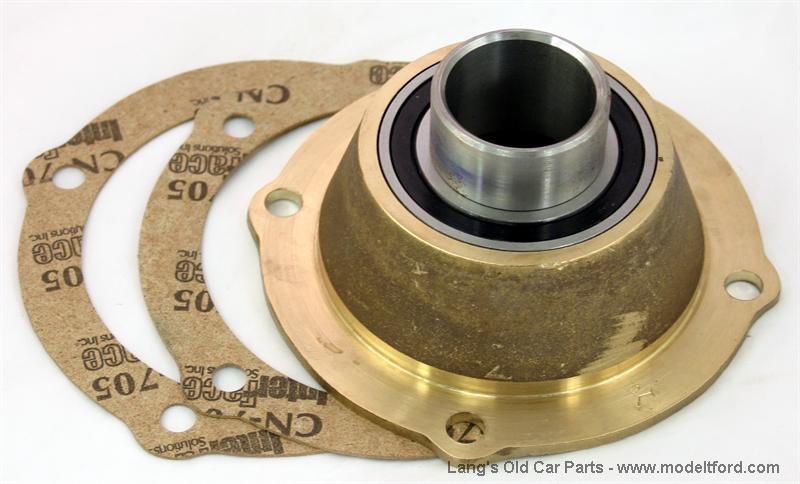

Hi,
Is anybody knowing how to get the Model T part "Ball Bearing Universal ball cap, no machining to the tail shaft required" ?
Usual Model T parts suppliers, Lang's (Part 3369BBD), Snyder's, Mac's, Texas T .... say that they have been without getting any during the last 12 months
Would somebody have one (or several) available ? Or would know what factory it comes from ? I was told it is manufactured/made in the US
Some of our French mate are looking for this device for a while and we look forward more information on this Part
Thanks for your knowledge and advices on this subject
Regards
Michel

You only need one gasket and it goes on the side facing the engine.

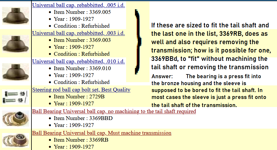

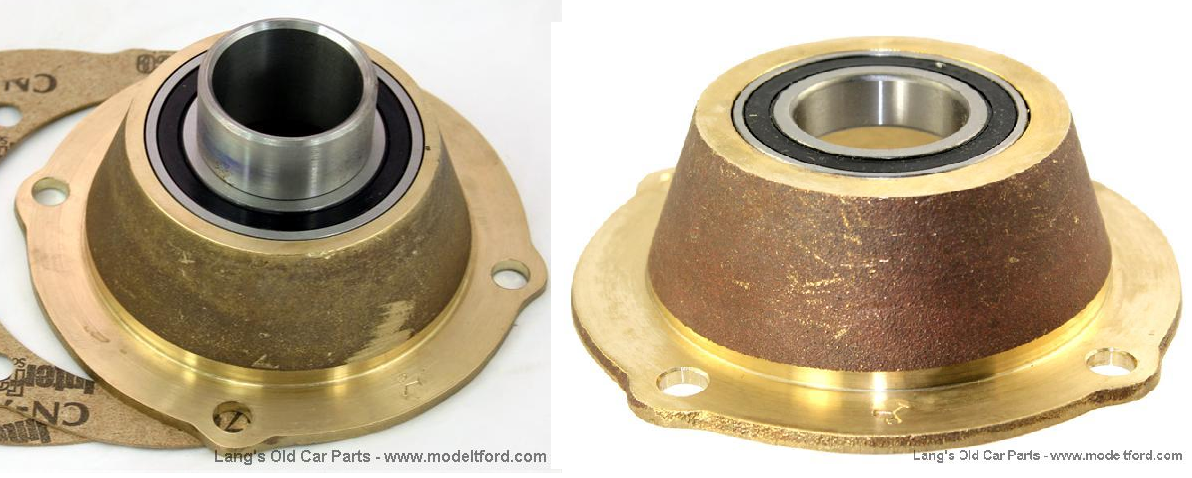

Original Smith wrote:
Mon Nov 08, 2021 10:33 am
If you wish to break a transmission main shaft, go ahead!
To be fair, you should explain what would cause that. I do see a difference in design of the two ball bearing units. One has a very short collar compared to an original or the other bearing model. That would concern me. In addition, how would one do a "press" fit of the ball cap bearing to the tail/main shaft such that flange of the ball cap would fit properly with just enough room for one gasket towards the engine? For these o work the shaft has to fit tightly on the bearing sleeve.
