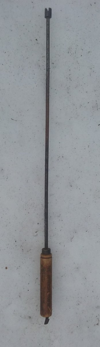

I've been using the oil checker rod similar to what Steve posted in all my cars. No brainer.

here is my oil level checker

Years ago I helped my Grandpa clean up a more unique sight glass and clearing out the estate was able to recover it and keep for my collection. unlike regular sight glasses it is big, approximately 1.5" in diameter. The more unique bit is that it is mounted with a wire to ground out the magneto and stop your engine should you run low on oil or anything happen. I'm sure the size makes it easy to read as well. I will most likely put it on my car when I'm done.

I have four Ts and two have dip sticks, one a sight gauge and one the original petcocks. The easiest to use is the dipstick but I’m always concerned about the accuracy. Every so often during an oil change I try to I check that it remains accurate. One of them use to have a sight gauge but it broke during an accident and I lost a lot of oil. Fortunately the motor can run with oil only up to the lower petcock so no serious damage. The fact I replaced the sight gauge with a dipstick shows my real preference. Of course the 09 has the original petcocks and that not likely to change.
Tony Bowker

I prefer the original set up. I use a tool similar to those above that can be made or purchased from any vendor. And I do not get on the ground to use it. I put my left knee on the running board and then bend over enough to look under the fender. I can use the tool with my right hand in that position. It's not nearly so hard for me to get up from that position as it is from the ground.
