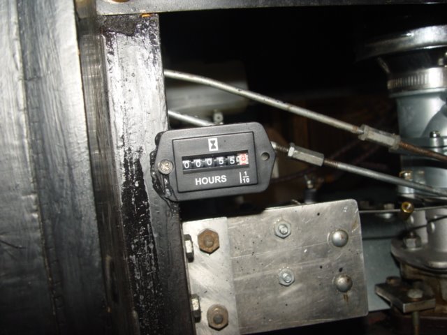

Then I started messing with hour meters. My experience, don't mess with the $15 - $30 electronic meters from Ebay or Amazon. They don't last. This one is from NAPA and has done well for 50 hours.
My question is, after how many hours on the meter should I do an oil change? I have been doing 10 hours equals 500 miles, but I don't usually drive 50 mph for long stretches.

Great idea on your hour meter, use one on the boat to monitor engine time between changes too.
