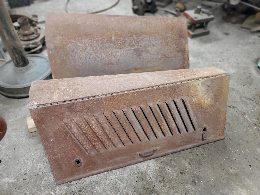

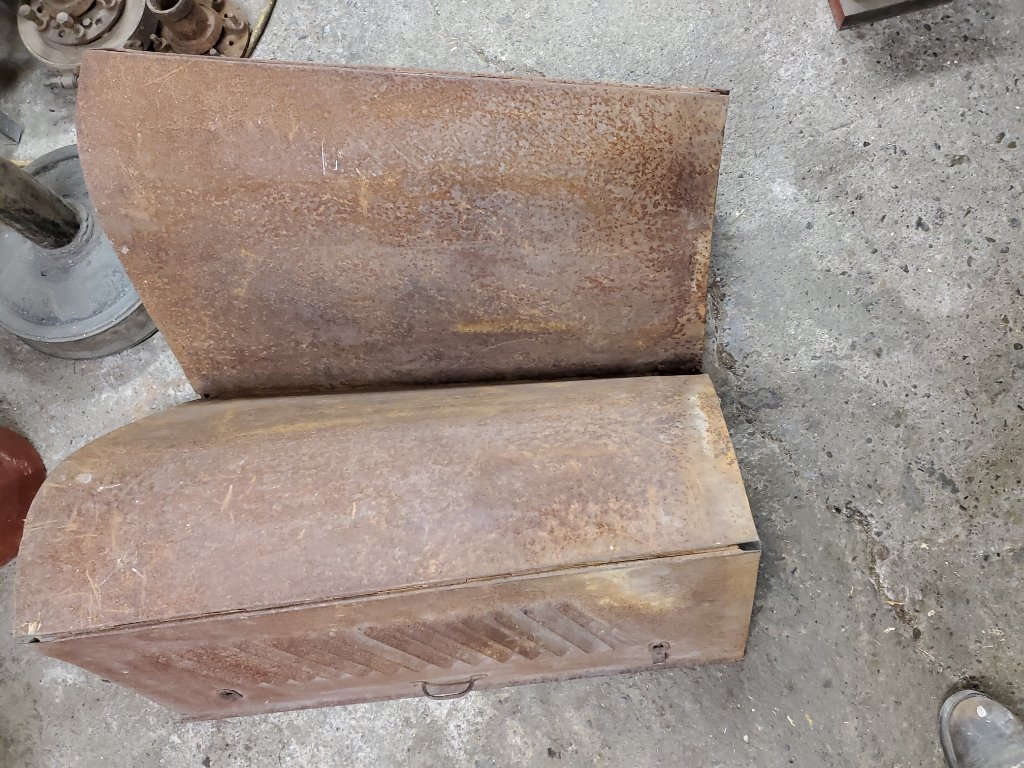

OK, I will play. Thanks Bryant for Round #1 on 11/11! This hood is destined for the speedster under construction. Side panels measure about 34" long, and 14" tall. The hood is wide, something like 26 or 28" at the radiator end, and is heavier metal than a Model T hood. Looks like it came from a much larger car than a "T". 14 angled louvers on each side. Does anyone recognize what it came from? Thx / Tim

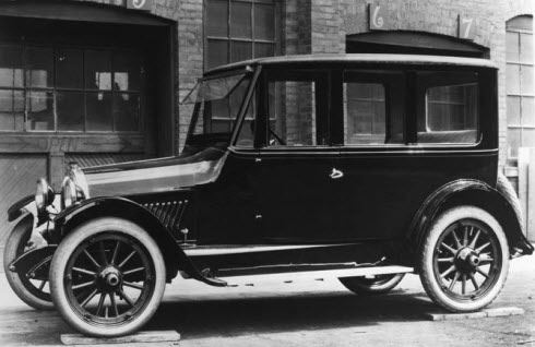

maybe this thing? 20s Haynes sedan. Just a guess. Has slanted louvers 😁

how about this one? Has 14 “visible” louvers. The center hinge is exposed upward. Hood latch looks close. Came up under a Haynes search but honestly I don’t know what it is 🤔. Iam having fun looking thou! What a great game we are playing

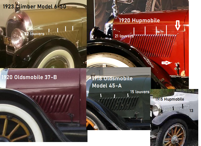

I think the Oldsmobile photos look pretty close too, and Frank's close-ups help. His photo of a Model 45 has 15 louvers, which will not not match my 14 louvers no matter HOW hard I try. How many other Oldsmobile years and models were there that might have had 14?
None of the Hupmobile photos look particularly close to my hood, but again there may be other models. / Tim

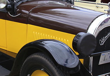

Post by Speedsterguy2 » Wed Nov 24, 2021 9:05 pm

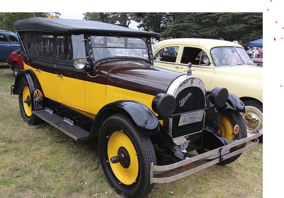

Well, I have continued to research online and have come up with just ONE contender that I cannot fault: 1923 Oldsmobile Model 30 Deluxe. It may be called a Model 30-A, and the hood may continue to a 1924 Olds Model 30-B. The problem seems to be that Oldsmobile at that time was producing several models, some that were continued year after year nearly unchanged, and some that changed rather quickly. The 1923 Model 30-A appears to change by year: 1924 30-B, 1925 30-C, 1926 30-D, 1927 30-E.
Only the earliest of the Model 30-A seems to have had the rounded, horseshoe shaped radiator shell. Virtually overlapping in production seems to be a more square-shouldered radiator shell that used a different hood, but also sometimes labeled (now) as Model 30. The photos showing the early version of the horseshoe radiator for 1923 are all Touring Car bodies, though there is an early advertising photo (shown on Alamy, copyrighted) shows a Coupe that appears to have the early radiator and hood. There is a white Touring Car on Catawiki (licensed, online) that appears to have the early radiator and hood. This car also shows up on Youtube and on ERClassics.com. There is a Salmon colored Touring Car on Flickr (licensed, online) attributed to Richard Spiegelman that is identified as a 1924 Model 30-B that has the early radiator and hood.
The best showing is attached below. Identified as a 1923 Olds Model 30 Deluxe, 6 cylinder, this photo is on Wikimedia.commons, Creative Commons 2.0, attributed to "Sicnag", with photo reproduction allowed for non-commercial use. The hood close-up clearly shows the 14 hood louvers (not the 10, 12, 13, or 15 louvers found on other Oldsmobile models!) I believe that THIS is the hood I have for my speedster project. / Tim
1923 Olds Model 30 Dlx. Hood Only.png (212.64 KiB) Viewed 2680 times
