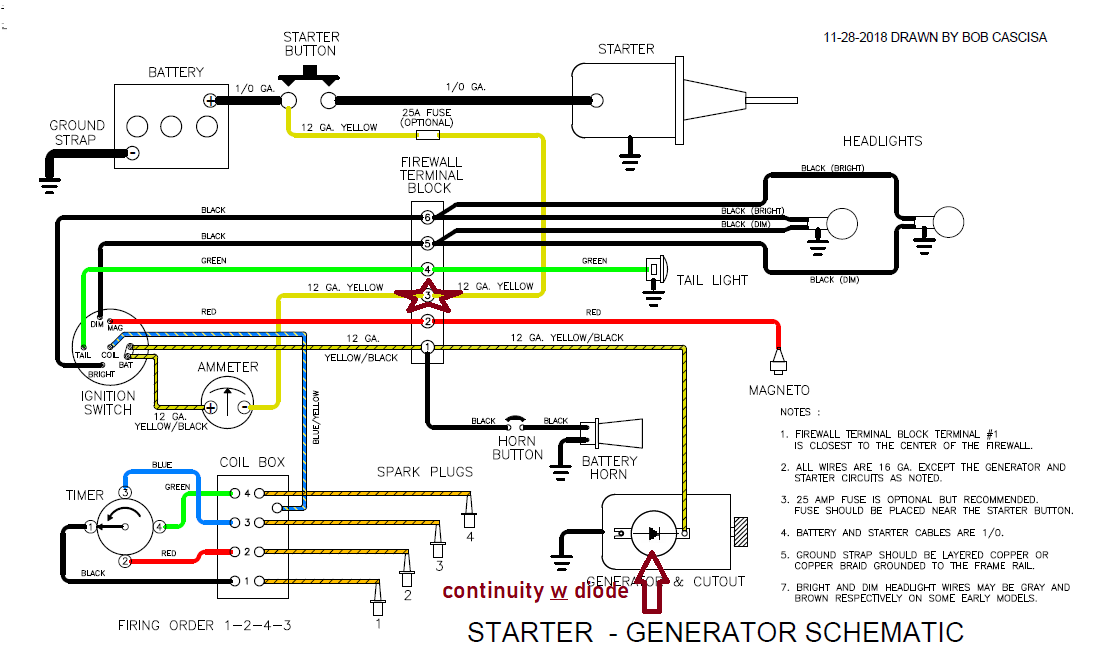

Re: Battery Running Down
To start with - it sounds like you were having battery issues before you changed the cut-out to a diode, so maybe the solenoid cut-out sticking wasn't the issue. Hard to tell.dunoon wrote: ↑Sun Nov 14, 2021 10:08 am.....I was having problems with the cutout sticking so I changed it to a diode one. Yesterday after a 3 mile run, I tried to check out what's running the battery down. What I did was remove the hot(battery) wire from the terminal block and using a multi-meter on 200MA I checked for a current draw between the hot wire and all the screws on the terminal block, nothing. I checked the cutout it's OK. Question is was I checking it properly or should I be looking for something else. Thanks, any suggestions would be greatly appreciated.
Some instructions on how to test a diode https://www.electronicshub.org/test-a-diode/
Something to be aware of: It is natural for continuity to exist between the generator post and ground (that's why there is a cut-out). Now here is a subtle difference between the solenoid & diode cutouts with respect to continuity. When the engine is not running and the solenoid is not sticking there will be no continuity across it. However, since the diode is a voltage blocker there will be continuity from the generator post to the battery post but not in the reverse direction when you switch the probes (if it is working properly). So I would expect you to have continuity (but no current draw) from the hot wire to screw #3. With the switch off and all wires connected, there isn't much chance for a short. Where did you get the diode/cutout?
