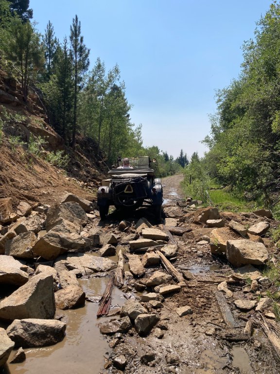

A friend went with the Lucus 525/21 tires and they are about 1/2 in shorter than the Firestones and he didn't get very good wear out of them. I average about 35,000 to 40,000 miles out of a set of Firestones and there is still some tread left and I tend to torture my tires more than most.

Do you run 20 PSI on the road with the lighter car?

Post by Dennis Prince » Tue Nov 16, 2021 1:05 pm
Pat, I do run 20 psi sometimes if I know that it will be rough like when I take it to the Bonneville Salt Flats for Speed Week however on the pavement I run up to 30psi, I get less side wall roll and the rolling resistance is much less, seems to drive better with a little more air.
