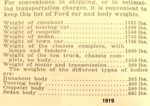

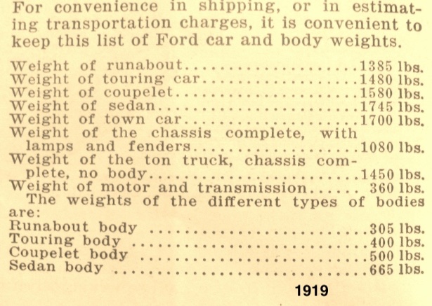

Here are Ford car weights, 1919.

Wow I didn’t miss the Runabout body weight by much! It was a guess. I remember it wasn’t as heavy as I thought when I was maneuvering it around when I was setting it set on the frame. Thinking back I didn’t have the turtle deck when I did it and it came later.

I was surprised by the quoted engine/transmission weight of 360 pounds. I guess that’s the number without a starter and generator which probably add 65 pounds.
I always thought it was closer to 500 pounds, wrong again.
At least I know I can use my engine hoist, which is rated at 500 pounds, with a clear conscience.

Dan thanks for find the information on the weight of the roadster body.

I assume the couplet body weight of 500 lbs. includes the fenders, running boards, splash panels, truck lid, lights, hood, top material, glass, maybe the seat, and package tray?
Any estimates/guesses on what the body weight would be on a 1927 coupe without those items?
