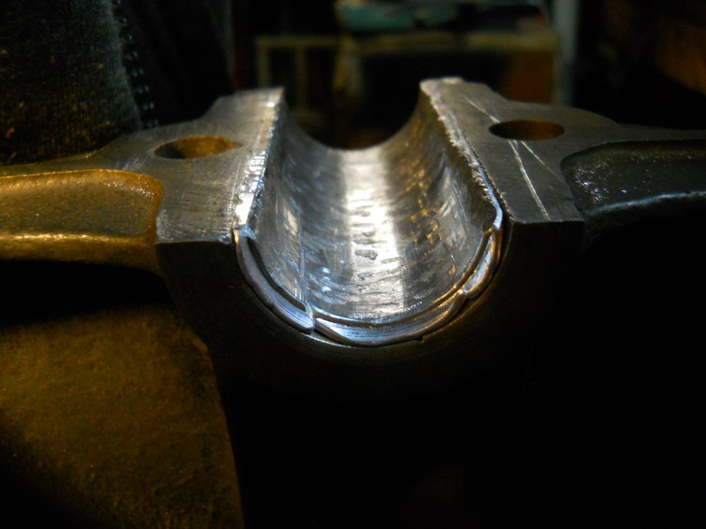

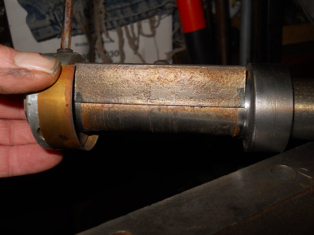

Using KR Wilson pouring bar. The areas where the Babbitt is poured has been turned down about .030. Shims added under the spacer block that fits on top.
My first attempt, forgot a plug in the oil hole, most of the Babbitt went on the floor.
2ed try, did not get all the moisture off the pouring bar. Luckily, only a small splatter hit me in the face, most went on the floor or all over the block. Lesson learned; face shield and welding gloves from now on.

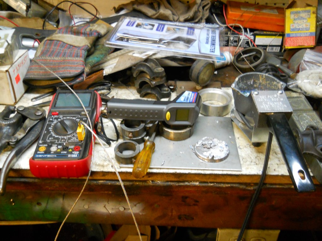

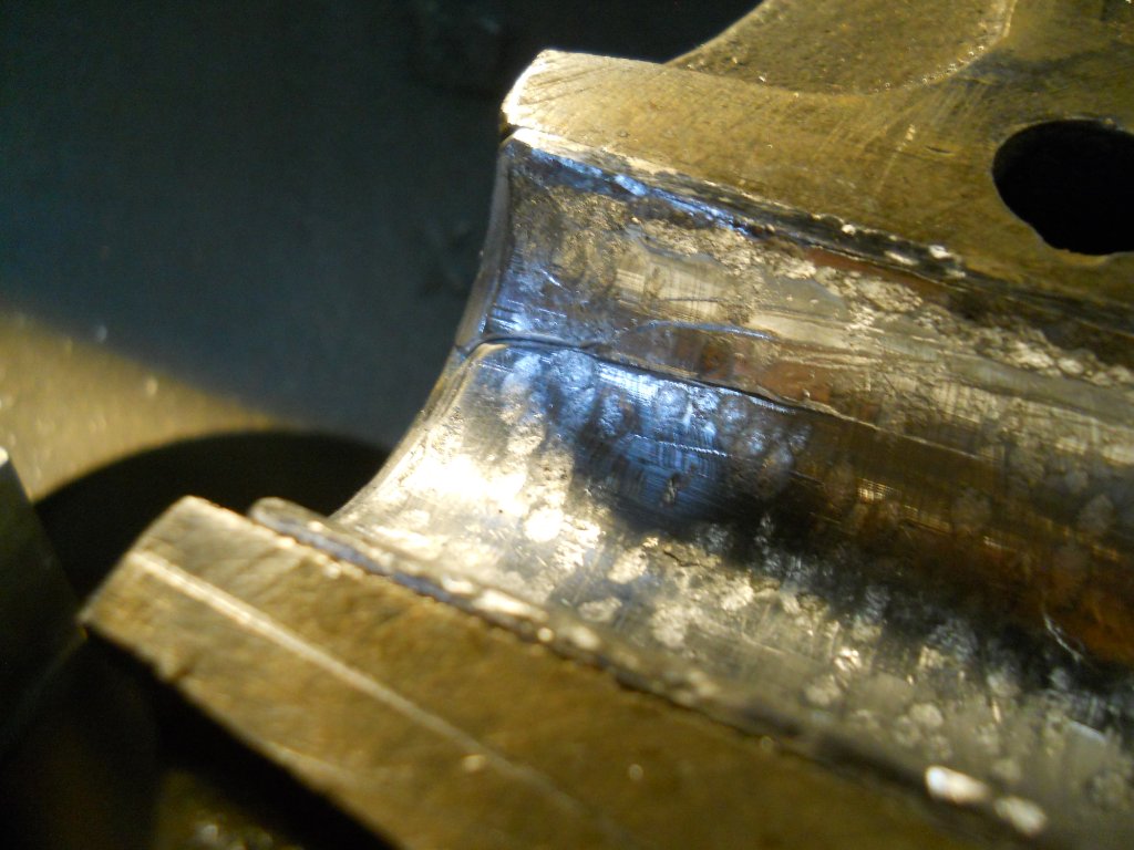

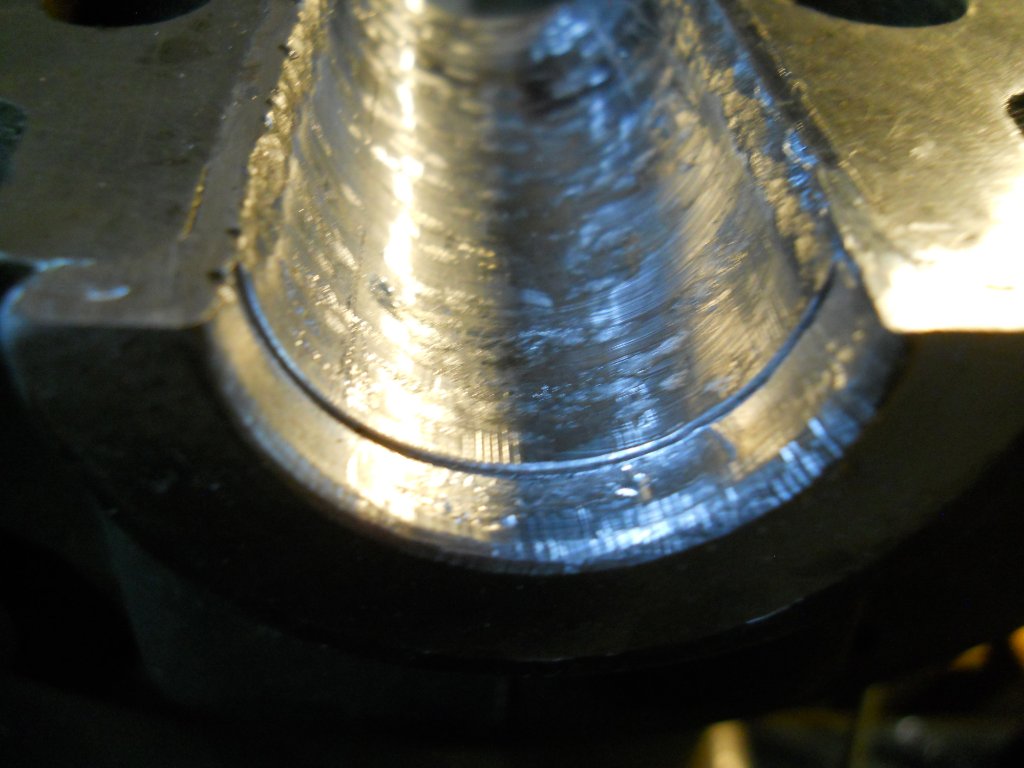

My 3rd try (the photos), Babbitt at around 800 degrees with Palmer Hot Pot, block about 400. I think the pour would have been better if I had not stopped because the side I was pouring from was overflowing, also may turn the KTW collar around and just use the flat side on all the saddles. The KRW collars have a built-in radius, except for the front one. Next time I am going to barrow a set of the pouring dams.
I did get the thrust on the back side a bit thicker than is really needed, will close the gap up some. I had to use an 1.25" ID collar that I had on hand, shimmed to fill the gap on the ID, and with a piece of brass shim stock clamped on the outside to make the mold, the KRW collars have too small of OD. Using the collar I had on hand with larger OD seemed to work just fine, just clamping the shim stock on the outside, but could have a larger OD. Will get some 6061 aluminum round stock and try a different approach at some point.
I am only adding thrust to the rear of the block, so only that part was cut back on the saddle. For the caps, I will be using Gene French's mold. At this point, just I am using reclaimed Babbitt to practice with.

Babbitt should be at least 950.
Remember that KRW boring jig is made for Standard cranks. You should under cut the bar to be sure you have enough material for undersized cranks.
Also you will need to peen the battitt before to cools.

Dan as usual is right on, you need to be above 900 degrees on your babbitt when pouring. Be sure to remove the dross & stir the babbitt right before the pour. You should consider milling the 3rd main on the block so you have a full thrust on the flange side of the block when you pour it too. I use to use a period Taft Pierce set up. It worked well but Gene French’s set up is a better system for me because like Dan stated your not dealing with standard size cranks. So we’ve got 2 jigs and multiple molds from Gene for faster production when doing multiple blocks. Dan also gave us some great recommendations on how to peen the babbitt but I won’t steal his thunder.

Using the KRW pouring bar, the areas where the Babbitt is poured has been turned down about .030, that is why there is a step at the rear. I may take it down a bit more.
This was a practice pour only, used a ballpeen hammer. Till I add a bigger circuit box, I can either have heat or run my air compressor to use the pneumatic rivet gun for peening. My compressor is hardwired into the only 220 CB, so have to unwire it to use the plug for the 220 shop heater. I pick heat right now. LOL
I am now thinking that the front of the saddle just was not hot enough, I will have to check that better on the next practice run.
"Be sure to remove the dross & stir the babbitt right before the pour." yes on that.
I remove material from the rear of the block saddle to match the length of the cap and angled it back some.

I am using the Hot Pot to melt the Babbitt, just don't have room for a larger pot to use two ladles, so am trying this way to see how it works.
After reading up on pouring, I was thinking that because when the KRW setup was used, the block just had the chill taken off and moisture removed, that is why the two ladle method was used, for the quicker pour.

No rust, did not see the rust on the bar which was from the 2ed attempt

Have spent the AM redoing the pouring bar. Cut it down a bit more and have a little more work to do on it before next pour. Need to make more shims to space the 3 blocks that go between the collars out from where I cut the bar down. I wanted to use this setup so would be spending less time moving things once the block is close to being heated up. The caps, I have 3 sets, so am thinking out how to do a production process to do a bunch at the same time.
