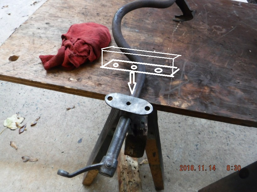

My handbrake pawl has never “grabbed” the teeth of the controller quadrant. I have lived w/o a locking handbrake for 5 years. Time to fix this! The teeth on the quad are excellent but the pawl is rounded and barely touches the teeth. I have read several forum threads on replacing the pawl and all seem to lead me to “remove the whole hand brake arm and cross shaft from the car to do the work”. Sounds easy enough, but I am not clear exactly how that is done? Anyone have some photos and steps by step to go through this? I do have Rocky Mtn Breaks that may add some issues… Appreciate any advice.

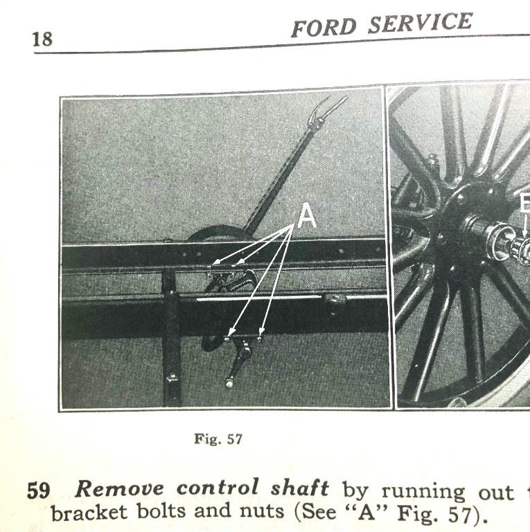

That entire handbrake shaft is easy to remove. Just two bolts on each frame, can't remember if there's anything else, per se, but the kit and caboodle will tell you once you start removing it. Obviously you'll disconnect the two brake rods first!! It's no problem.

Once the control shaft is removed don't forget to clean out and maintenance the oiler holes

The equalizer of the Rocky Mountain brakes hangs loosely from the shaft of the hand brake. If you just remove the two straps and remove the pins and the shaft, you should be able to re-install the shaft without making any other brake adjustments, unless you need to adjust the brakes anyway.
After you replace the pawl, when you apply the hand brake, squeeze the lever and pull back without the pawl contacting the quadrant until you get it back all the way, then just let go of the squeeze and pull it as far as you can. Usually just one click. That will extend the life of your new pawl.

You can refer easily to Ford Service, paragraph 59 to remove and paragraph 67 to install that control shaft.

Thanks all. Dan - I looked all over the darn manual for that page - One would think "handbrake" or Pawl or control quad etc would have pointed there! Anyway looks and sounds easy enough. Thanks!
