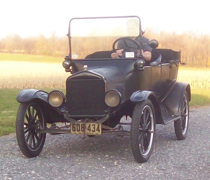

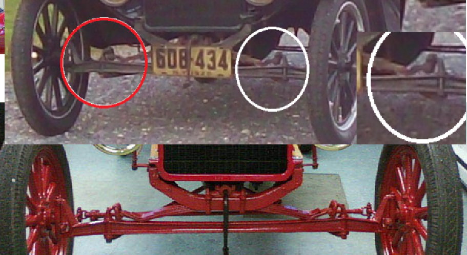

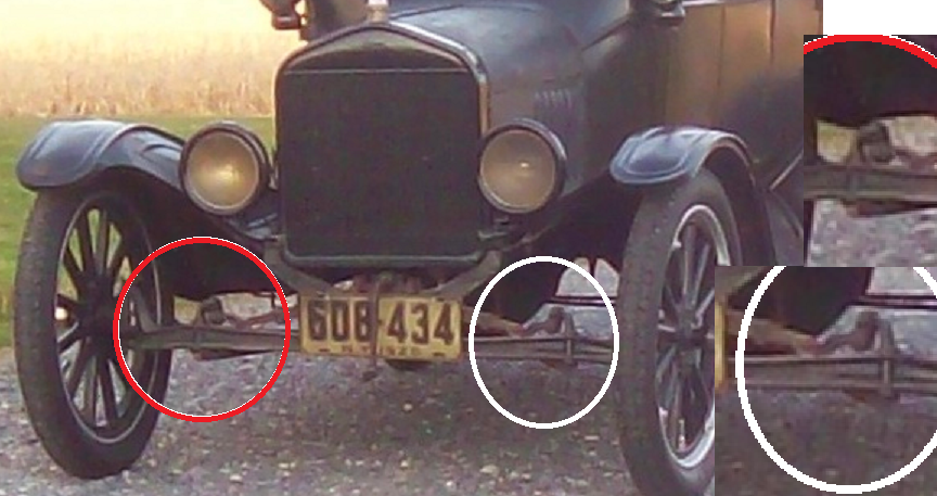

This has nothing to do with year, but I am just curious about what I see in the photo. Maybe just an illusion.

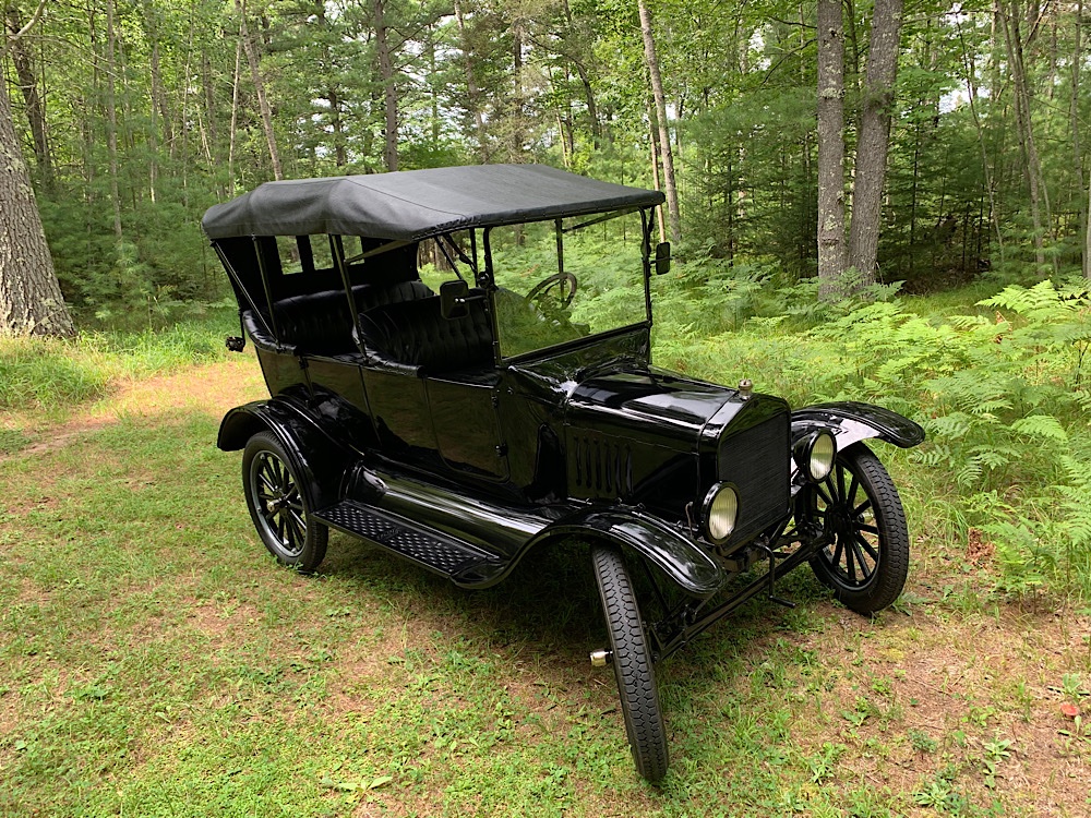

J Sundstrom wrote:
Wed Dec 01, 2021 10:05 am
From one August 1920 Touring to another!
Hey John! Very nice, the level I hope to have mine at someday-can you post some more pics of your car?

Original Smith wrote:
Wed Dec 01, 2021 12:26 pm
Another topic would be was your car originally a non starter model, and if so, was Ford putting in the standard battery carrier by then, or was an earlier design used? For awhile, Ford was riveting a starter switch plate to the frame prior the the standardization of that switch.
This car was starter equipped and had all the electrical equipment from day one as far as I can tell. One thing I did change was the windshield brackets so I could add the kerosene lamps. Just a personal preference and I wanted it to look like the one my grandfather had back then. Kept the original brackets though.
Interestingly, I don’t think it had the demountable rims originally as there was no spare tire carrier and the frame has rivets where the bolts would otherwise go for the carrier.
I picked one up years ago and intend to put it on. The demountables were something I wanted on a T and when I bought this car they were already on it with the later “Ford” rims, which I sold/horse traded for the correct wide lug Hayes rims.

20touring wrote:
Wed Dec 01, 2021 1:36 pm
TRDxB2 wrote:
Wed Dec 01, 2021 12:35 pm
Oh that! Lol...one of the previous owners did this front and rear-took a torch and heated the springs on the ends near the eye to drop the body because he didn’t like how high it was.
I...can’t logic that one out! May have been an idea born out of too many trips to the still? :lol:
I have the lower leaves necessary to return them to original ride height.
been done

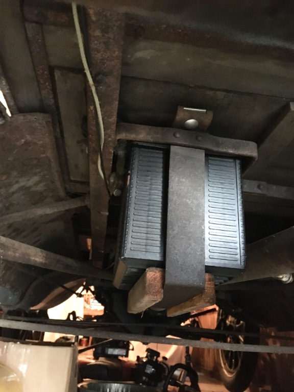

[/quote
Battery holder pic:

J Sundstrom
Posts: 61
Joined: Mon Jan 07, 2019 2:48 pm
Last Name: Sundstrom
* REQUIRED* Type and Year of Model Ts owned: 1920 Touring
Location: Vulcan, MI
Re: 1920/21 Touring dating question

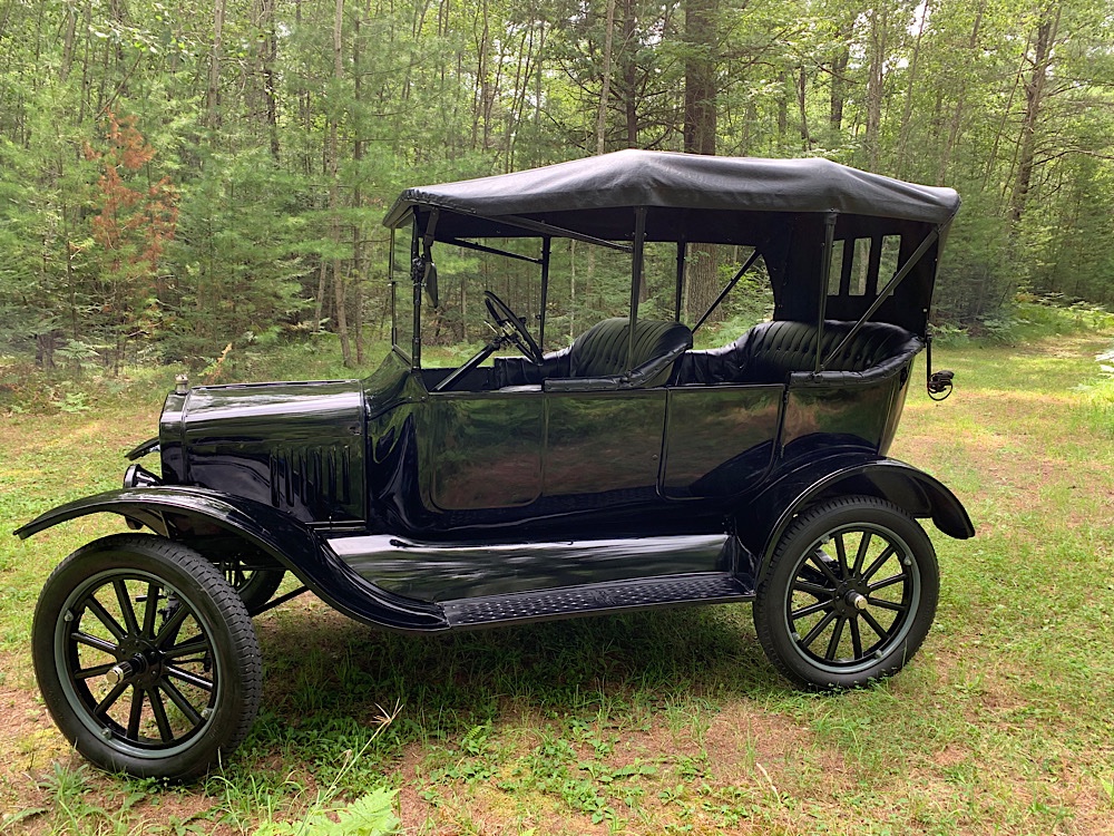

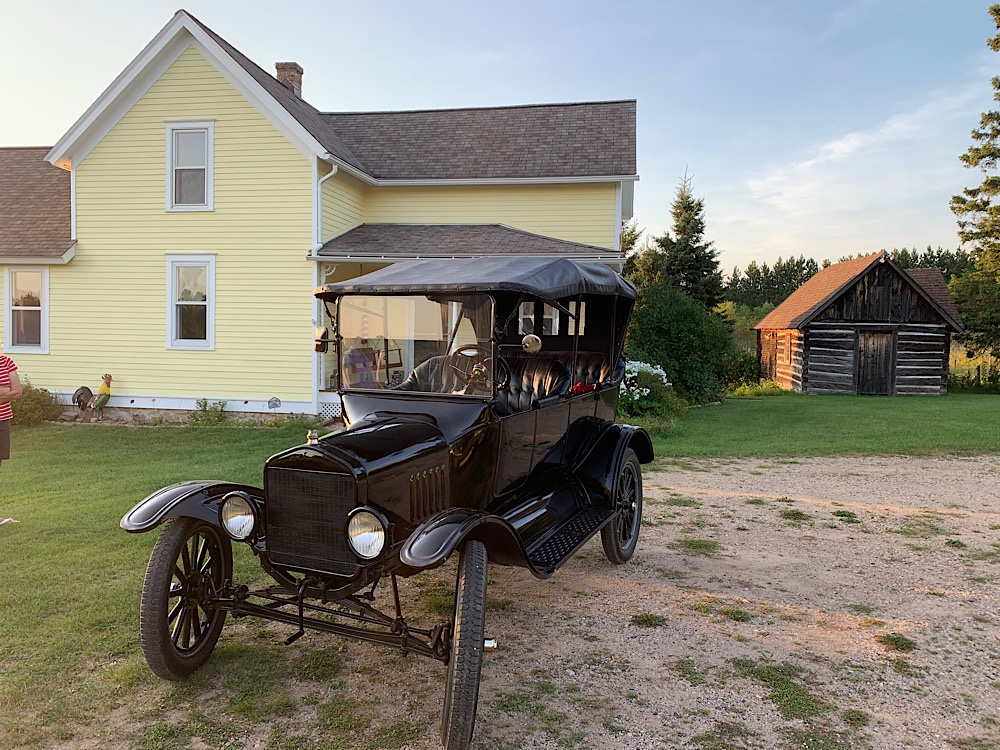

Post by J Sundstrom » Wed Dec 01, 2021 6:58 pm
Kevin, Here’s a few more pictures of my Touring. This one is August 20 engine number. Had to laugh as I had the same experience as you regarding the spare tire carrier. I bought one when I was working on car. Seeing that I would have to drill out crossmember rivets I decided to leave off. Mine is a starter car and had demountable rims on it. Has some earlier features like earlier style non stamped metal steering spider, and die cast/plated ignition switch, forged running brackets. My starter switch is just as yours with mtg base riveted to frame.
If you are ultra purist should have clear headlight lens and The heavy metal strip at the base of the rear curtain. (Classtique top & interior). Family owned since early 70’s so we owned 1/2 it’s life.
20touring
Posts: 95
Joined: Sat Sep 11, 2021 9:33 am
First Name: Kevin
Last Name: Mocyk
Location: Warners NY
Post by 20touring » Wed Dec 01, 2021 8:01 pm
Wow! She’s a beauty John!
My car too has the forged running board brackets & die cast Ignition switch.
The metal strip is there for the bottom of the rear curtain but it has some extra holes drilled in it that a previous owner had snaps mounting the old rear curtain top. I plan to fill those in with my MIG welder when I get rolling on the restoration. But if it doesn’t work out, thank you for the vendor recommendation-I guess those strips are difficult to find from what I’ve been told.
I have been on the lookout for a pair of clear lenses just to have them but no luck-any ideas?
