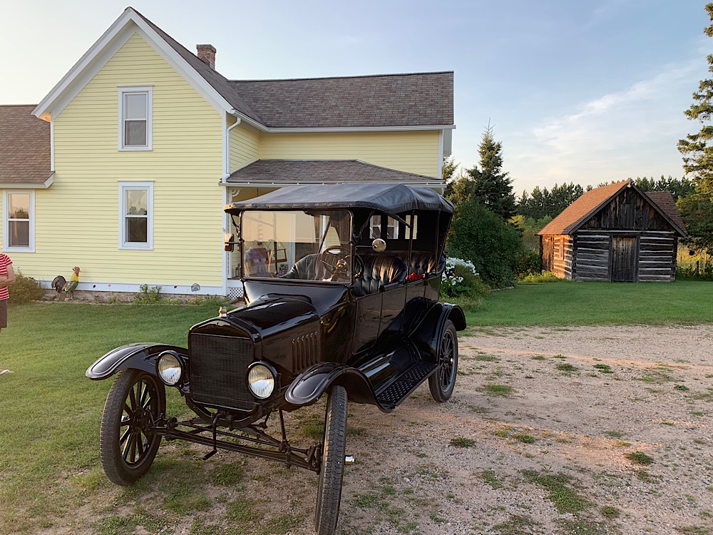

Question: My ‘20 Touring has the 5 piece back section and is an August 30,1920 build date. I have an old title from Illinois from 1948 stating it as a 1920.
But I have read that the new model year began August 1st and have wondered if my car actually is an early 1921.
Opinions?
Opinions?

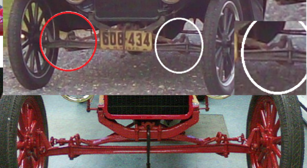

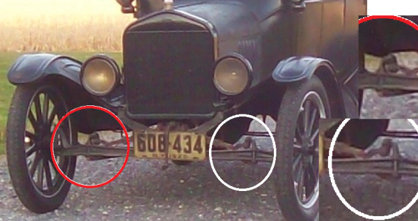

Here are some subtle some visual checks/changes . Its likely some of the other differences may have been replaced over time

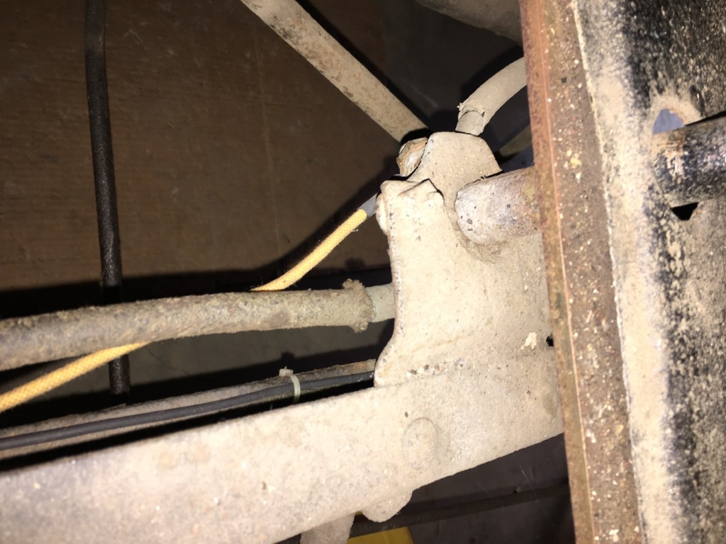

APR 1 Acc. 575, Box 14, #832, Ford Archives Oil holes in the frame rails for the brake lever shaft discontinued. Now if you have these then the frame is 1920 or other year

Interesting replies! I have read that the new “model year” began August 1st of the previous year, but also in the era of my touring a specific date went out the window, so to speak, and generally the month of August was used.
From a sales perspective to create “buzz” for the new models it seems logical that you would want to designate a start date for the new model year.
But with the high demand for the model T back then, that seems like it would be less important to the factories and more important to dealers in the field.
Although my Touring is what I would consider a low use survivor car (the original engine is gone-still looking!) it is all original sheet metal.
Given the information provided by members here, and the 1948 title, I am convinced that it is in fact a 1920.
Many thanks to all!

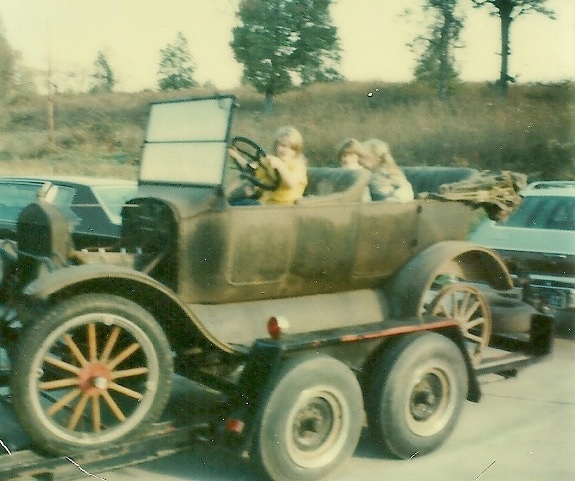

My 1924 or is it 1925 touring is in that boat. This T is all original find, never messed with and intact with parts from the branch factory assembly as far as I can determine.
Interesting is the engine serial is Aug 26, 1924 date of assembly. The body has the front door hinges of a '25, the upper wind shield frame with the holes for mirror and wiper, and seems a real '25. The engine however has the 3-dip pan, which is odd because the 4 dip pan first used July 18. The hogshead is the improved with the cast-in 'flipper' to sling oil on the bands, first used July 17. Lastly the front fenders are the ones with the narrow embossed bead that rides along side the splash shields, the wide bead fenders were noted by B. McCalley to be late 1924 , so obviously the late must have been after Aug. by several months. So not all '25 model year have these wide bead fenders!
Original title from TN stated 1924, which is what I used when acquired in 1977. But....I refer to it as a 1925

Dan, which hand brake quadrant does it have?

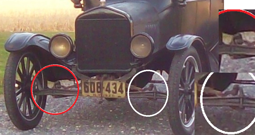

This has nothing to do with year, but I am just curious about what I see in the photo. Maybe just an illusion.

Oh that! Lol...one of the previous owners did this front and rear-took a torch and heated the springs on the ends near the eye to drop the body because he didn’t like how high it was.
I...can’t logic that one out! May have been an idea born out of too many trips to the still?
I have the lower leaves necessary to return them to original ride height.

This car was starter equipped and had all the electrical equipment from day one as far as I can tell. One thing I did change was the windshield brackets so I could add the kerosene lamps. Just a personal preference and I wanted it to look like the one my grandfather had back then. Kept the original brackets though.Original Smith wrote: ↑Wed Dec 01, 2021 12:26 pmAnother topic would be was your car originally a non starter model, and if so, was Ford putting in the standard battery carrier by then, or was an earlier design used? For awhile, Ford was riveting a starter switch plate to the frame prior the the standardization of that switch.
Interestingly, I don’t think it had the demountable rims originally as there was no spare tire carrier and the frame has rivets where the bolts would otherwise go for the carrier.
I picked one up years ago and intend to put it on. The demountables were something I wanted on a T and when I bought this car they were already on it with the later “Ford” rims, which I sold/horse traded for the correct wide lug Hayes rims.

been done20touring wrote: ↑Wed Dec 01, 2021 1:36 pmOh that! Lol...one of the previous owners did this front and rear-took a torch and heated the springs on the ends near the eye to drop the body because he didn’t like how high it was.
I...can’t logic that one out! May have been an idea born out of too many trips to the still?![]()

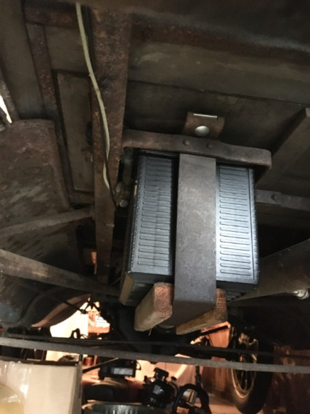

Re: 1920/21 Touring dating question
[/quote
Battery holder pic:

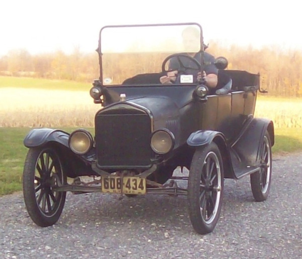

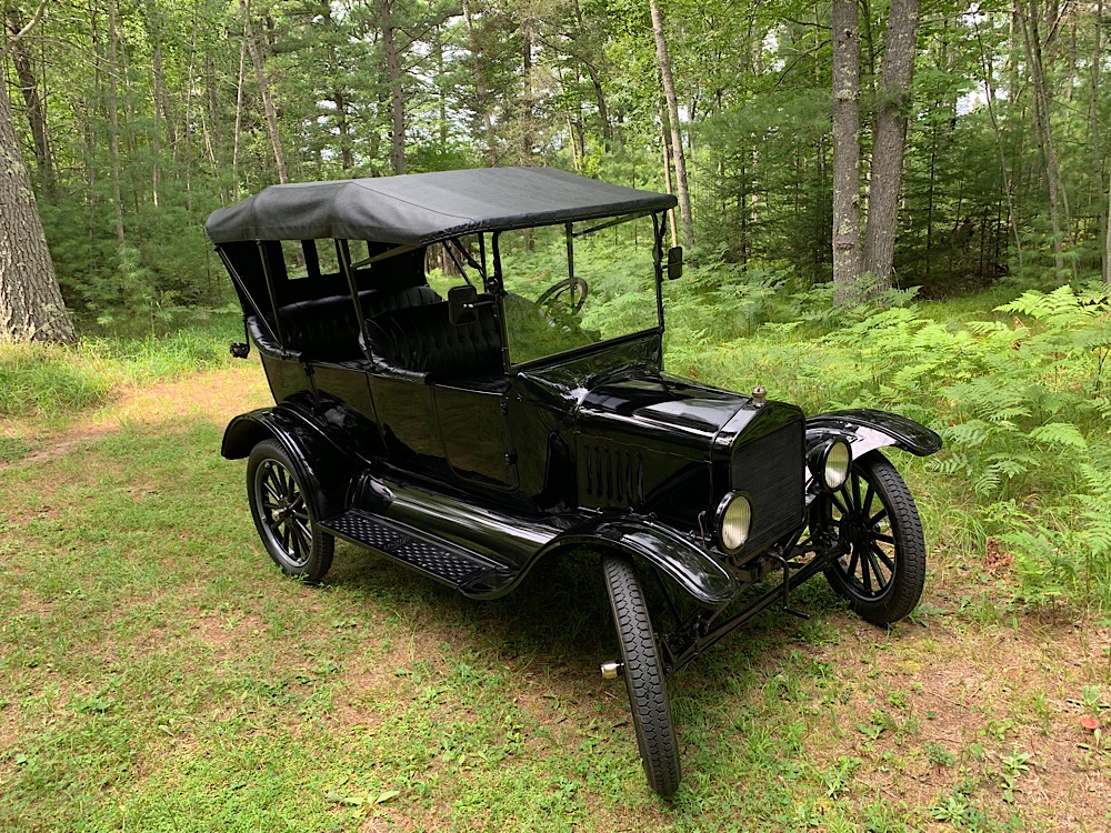

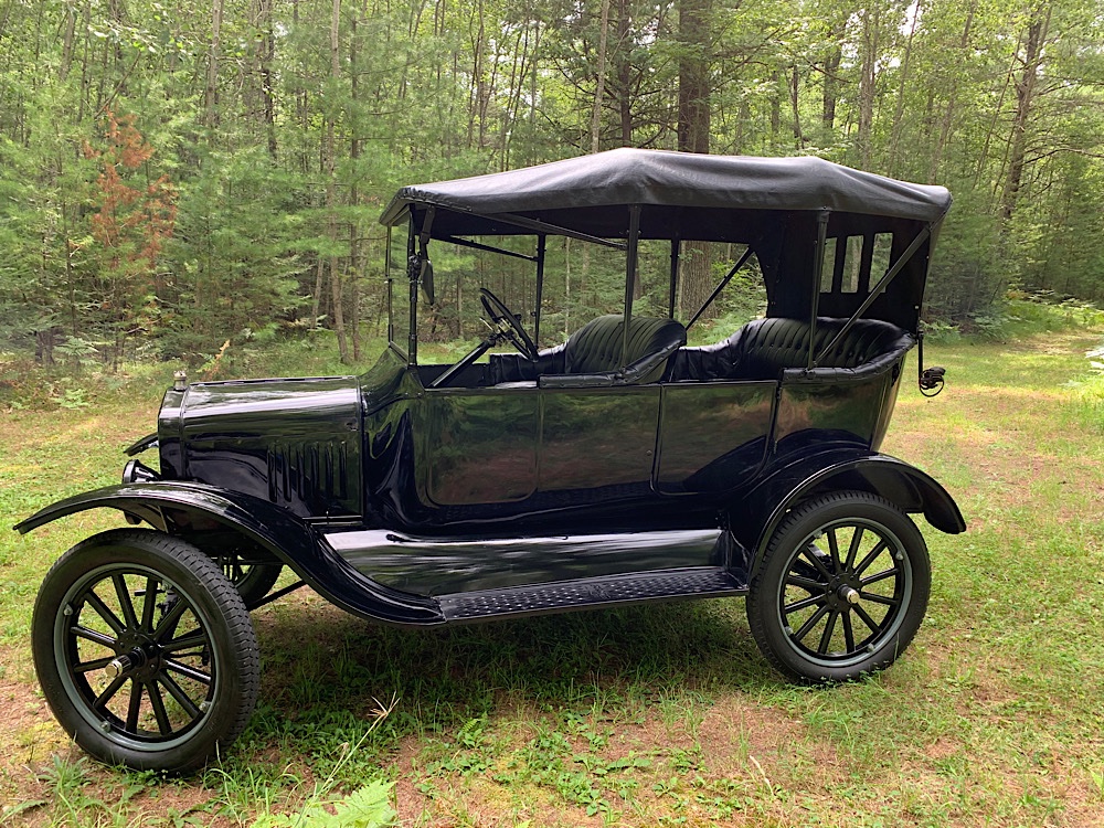

Kevin, Here’s a few more pictures of my Touring. This one is August 20 engine number. Had to laugh as I had the same experience as you regarding the spare tire carrier. I bought one when I was working on car. Seeing that I would have to drill out crossmember rivets I decided to leave off. Mine is a starter car and had demountable rims on it. Has some earlier features like earlier style non stamped metal steering spider, and die cast/plated ignition switch, forged running brackets. My starter switch is just as yours with mtg base riveted to frame.
If you are ultra purist should have clear headlight lens and The heavy metal strip at the base of the rear curtain. (Classtique top & interior). Family owned since early 70’s so we owned 1/2 it’s life.

Wow! She’s a beauty John!
My car too has the forged running board brackets & die cast Ignition switch.
The metal strip is there for the bottom of the rear curtain but it has some extra holes drilled in it that a previous owner had snaps mounting the old rear curtain top. I plan to fill those in with my MIG welder when I get rolling on the restoration. But if it doesn’t work out, thank you for the vendor recommendation-I guess those strips are difficult to find from what I’ve been told.
I have been on the lookout for a pair of clear lenses just to have them but no luck-any ideas?
