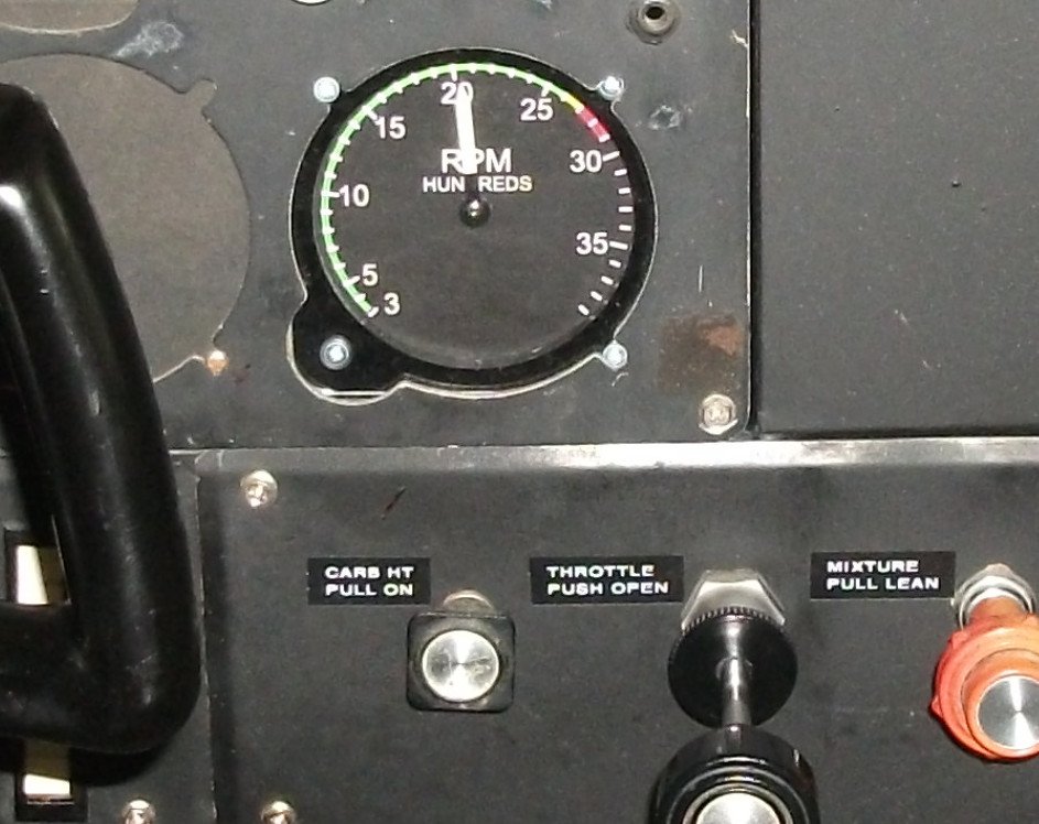

Finally, my preferred option to report the results was a servo controlled analogue gauge. This would give an 'old-school' look, and it's easy to make a suitable scale that would be appropriate for the vehicle. Here's a view of such a gauge I made years ago for a FTD (instrument flight trainer) I designed:
Alternatively you could output to a stepper motor that would then drive an original RPM gauge. In effect it would become an electronic drive cable that might otherwise be mechanically driven from the motor.
