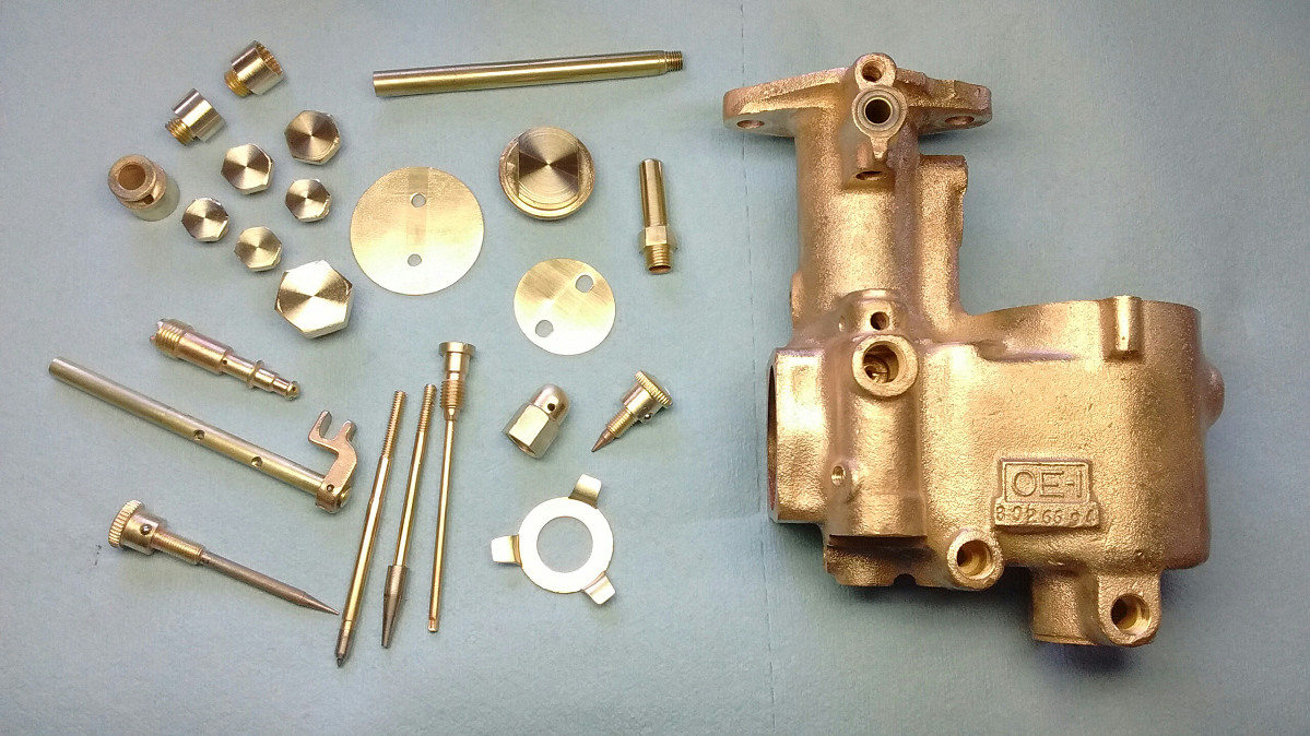

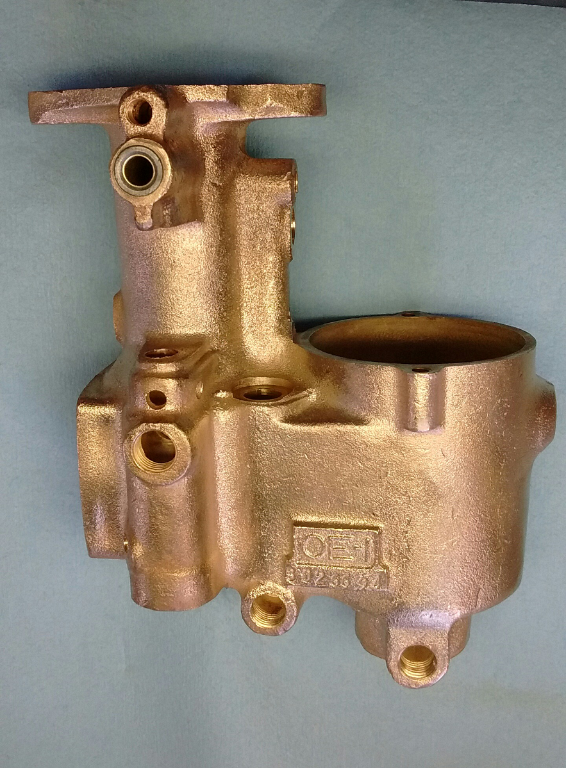

Not sure how I'm even going to test this when I'm done, since I don't have an engine that really can put it through its paces, but it sure is fun to figure out how the devil to get these things apart...and the OE-1 has a few chinese puzzle-box features to cypher out. Oddly enough, both ears on the float cover broke off when the rusty screws came out so there is some silver-solder work for tomorrow. In the mean time, here are the bulk of the bits, less the jets and springs and the new viton-tipped float valve that will go into it. Will make that tomorrow. It still takes a lot longer than I care to spend on a project, but some new equipment this spring should hopefully drop the cycle time into the "reasonable" range.
I'm pleased with how the various processes are maturing and coming together to make a presentable and functional product. The steel parts were really rusty and are now clean and am in the process of finding a good and reliable powder coater within a reasonable drive from me (which is why they are not pictured...they are boxed up waiting to go...well, somewhere...)
I will be winding some economizer springs in a couple of days so will have a few spares in the event that someone other than me is crazy enough to remanufacture one of these...

Tip of the day: if you find that the high-speed adjuster runs out of "richness" adjustment, then it is nearly certain that you have a version of the OE that has an optional gas reducing jet in the high-speed circuit. Some auto companies requested those to eliminate what they called "inexperienced drivers" from over-richening the carb.
That jet is located in the hole located below/left of the "OE-1" and S/N (if it was installed by the factory)
If it is installed, then the high-speed adjuster will have no effect when unscrewed to its fullest and will take a long time (a lot of screwing "in") for it to lean things out. This is because the optional jet is 2 sizes smaller than the largest adjustment that can be made by the needle...it really throttles down the fuel.
