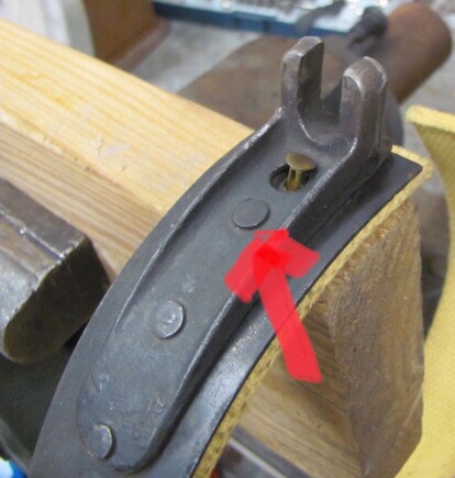

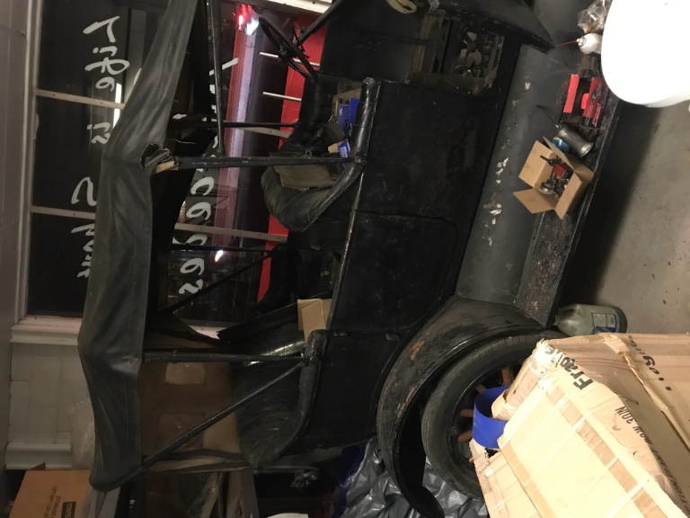

This is my first T, the engine has a April 1917 number, in looking at parts it seems 1917 is transitioning year, I am curious how correct it is ,mostly so that I can know enough to get parts that fit. It had no compression and turned over real stiff at first till I got oil worked into it ,when I drained the oil the piece of rivit was laying on the drain plug, it looks like it was rusty and rattling in something, does it look like a part of the engine/ transmission, or more likely something that fell in.
I hope to have it running before Christmas, even if it just for limited driving --- I can't let it progress into a restoration at this time, I am hoping my evaluation that will be "good enough " works out.

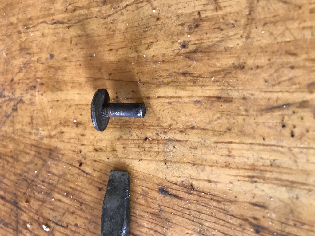

Looks like the rivit that holds the magneto field coil contact insulator in place.

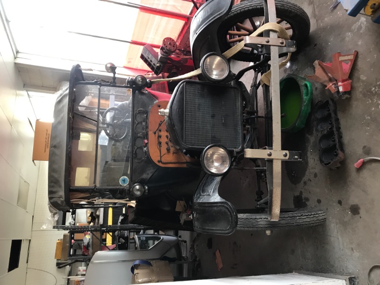

I have a 17 built in September of 16 and it has a number of 1916 parts. I would like to see closer views of some areas of your car to determine whether the parts are correct but it does look 17ish. The one glaring discrepancy is that 17's had clear glass headlight lenses....
Check whether the sockets for the top bows are oval or square. 1917 was the last year for the oval. I should also note that demountable wheels were not available in 1917 although many owners made the switch when they became available. My car has 30 x 3.5 demountables all around and I wouldn't have it any other way.... I have no interest in patching a tube by the side of the road. You will notice in the photo of my 1917 Touring that I have a spare mounted on the left running board - 1917's didn't come with spares so it is up to you whether you carry one and how you choose to mount it. Word of caution about wheels - give the spokes a good shake to determine if any are loose. If they are, I suggest it is time to think about re-spoking. You don't want your wheel to come apart on you when you're driving down the road.
I'm not sure about the rivet....however, anytime you find such an object in the oil pan it is cause for concern. You don't want something coming apart and causing catastrophic damage. Hopefully someone who knows more about engine & tranny internals will chime in.

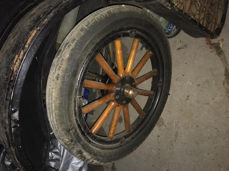

If we're looking for parts that are "wrong" for 1917, you can include the demountable wheels. Obviously they fit, but were first used on some Fords in 1919. It's not rare to see them used on earlier cars for convenience. Strictly original wheels for 1917 would be non-demountable with rounded wood felloes, round spokes, 30 x 3 front and 30 x 3½ rear, painted black. "Natural" spokes became an option in 1926.
If the mystery rivet is from the magneto contact insulator, I believe you can look into the hole with the mag post removed and see if it's missing from the insulator.

The head gasket on the cowl (like your pic) wasn’t OEM until 1923.........just kidding.....I think the windshield hinges were of equal length from ‘15-‘17 then changed in ‘18. If I’m wrong on this you can be sure someone will ‘correct’ me.

Could it be a rivet that holds the transmission band ears on? Can’t tell for sure on the size comparison by the screwdriver.
Also thinking it may a rivet that’s used for mounting the pan ears or ??

For now I would get your T running and driving like it is and then go from there. More than a few people use the later demountable rims as is used on your car. Ford was improving the T’s along the way and most but not all parts would fit. After a while people would figure out it was easier to change a flat that way then doing the old way of prying off the tire, patching the tube and replacing the tire which isn’t fun on a muddy road in the cold of winter. That was a big improvement for the T’s that still had the older style wheels.

Just looked, it has removable ear bands now, perhaps it's from previous bands, but yes that does look like what I found

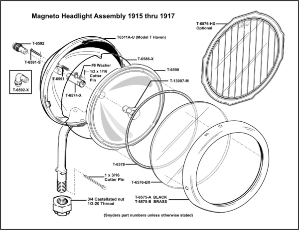

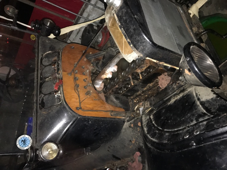

The fluted headlight lens were not introduced until 1922 so say past discussions http://www.mtfca.com/discus/messages/331880/375833.html
(vowel art shows plain glass for 1915-17). The headlight buckets might be incorrect as a result. They should have the focus screw above the bulb, 12 o'clock as opposed to at 9 o'clock.

It sure does look like it’s a band ear rivet. When you have the transmission cover off and if you take off the pan cover you could check for anything else that looks suspicious. It would be interesting to see if there is anything else in the dips in the pan bottom cover.
Removable ear bands are only removable on one end. I'd check out your bands...

The windshield hinges were changed along about mid 1917 model year. Early 1917s had the even fold, late 1917s had the offset hinges.
The 1917 model year model Ts were a bit different. They crossed over from the brass era into the black era, and had several minor details that were used for only a short while. Very few 1917s are properly restored with all the proper unique features (like the fan shroud used for only about half the year!).
Don't get too hung up on what isn't right on your car yet. Get it running, get a feel for driving it. Then, later, decide how many things you want to change. If you choose later to make it "really right"? Then you can decide what month it appears to be from and find out all those little details and timelines. If you choose to keep it more how it is and enjoy it this way? That is fine also. Model Ts have been running and used and maintained for over a hundred years now! A car wearing all its badges (changes necessitated by maintenance) is a part of its history!
Steve J (one of our finest!) covered the wheels quite well. And the windshield hinge has been mentioned. Another obvious change is the back curtain of the top. Early 1917s had the "tombstone" window/light like was used throughout most of the brass era. Mid/late 1917s used the three tall narrow window/lights used from mid 1917 into the early 1920s. The two almost square window/lights came out about 1923 and was used for only a couple years. If I recall correctly? I think 1925 used a one year only single window/light on the rear curtain. I don't know what the 1926/'27 used (too modern for me?), I think it was also single window, however the entire top is slightly different than the earlier ones.

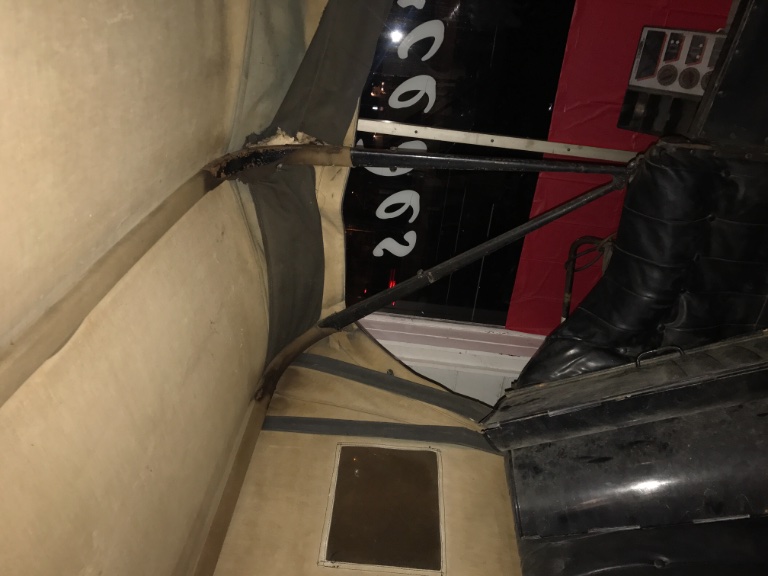

A lot of replacement tops used the two nearly square window/lights on earlier tops. A good photo of the side of the car showing the top would help to determine if the top is a correct two-man variety. A 1917 should have oval top sockets. The square top sockets came about 1918/'19.
I am curious to see a couple side views of the car.

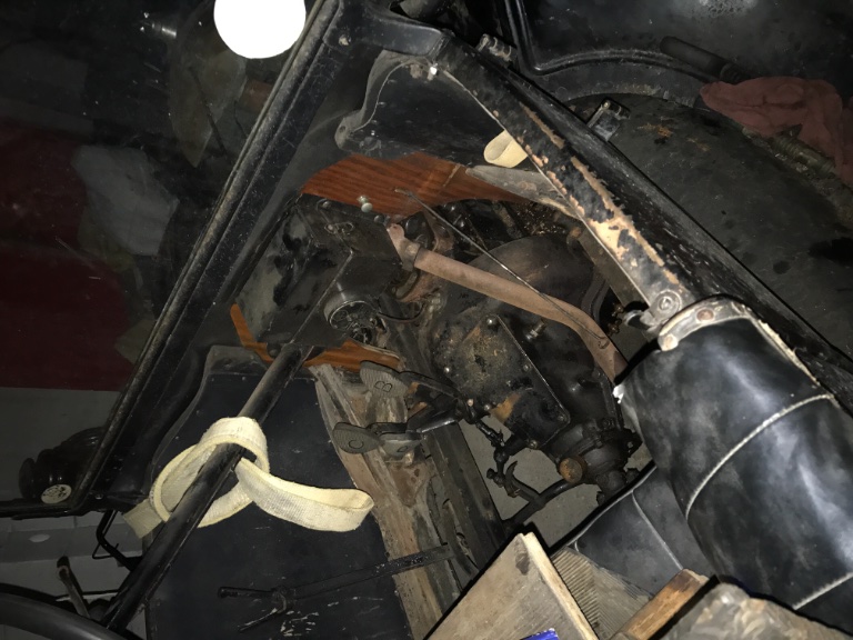

Looking again at your car it looks like it still has the engine pans still on it. Over time owners would take them off so they could a little better access when working in the engine area. Also the wooden dash may have been replaced with a replacement but that’s still original for your 17.
Hopefully since its a non starter car and the magneto ring is still OK and the flywheel magnets (Magneto) still have enough charge still in them to run your car. Does it have the Hot Shot battery in the car somewhere? That would help get non starter cars a boost.
Non starter T owners can add more about that than me. The 3 T’s that I have are a little later than yours is and have starters. Ford added Starters around 1919 for another improvement.
I thought that was just for 1915, but the MTFCI guidelines show it through 1918.

I am mostly curious about how much is original,not going for a points car, I know about the wheels, and scrounging a spare and bracket is added to my searches, it's complete enough that I can make it drive, at this point just local is ok, I am going through the steering and brakes, greasing everything, it's a new challenge, and I will get to use tools I haven't used before.---- and I don't know enough about posting photos to correct the rotation

Before asking others to pick over your car, I suggest providing the motor casting date and serial number and the body date. The body date should be on the passenger side front floor riser - either stamped directly into the wood or stamped on a metal plate.

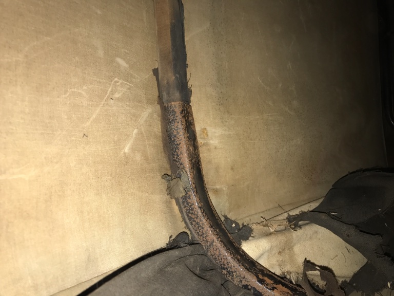

Your top irons are 1918-1922 model year. The top material has been replaced - it may have been replaced during the 1920/30s during the period of the car's original use. The top pads appear to be original, especially since you can see the white canvas duct inside one the pads.

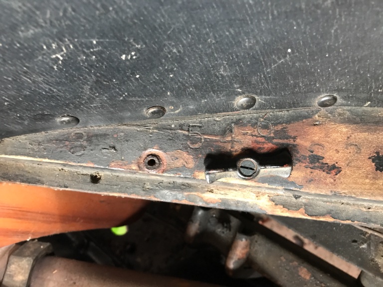

I found the data, 3-17. 546. 22

I see someone put a screen/storm window bowtie clip on the riser to hold down the floorboard.

What you show indicates a March 1917 body date and the other numbers would be the body serial number.
Note: the month and year are usually separated by a dot and then there is another dot followed by the body serial number. If you do see a dash, that most likely is a nick or gouge that occurred at later date.
In any event, because the body is March of 1917 and the motor serial number is April 1917, that is a good indication that the body and motor are original to each other and your car is not a "put-together."
