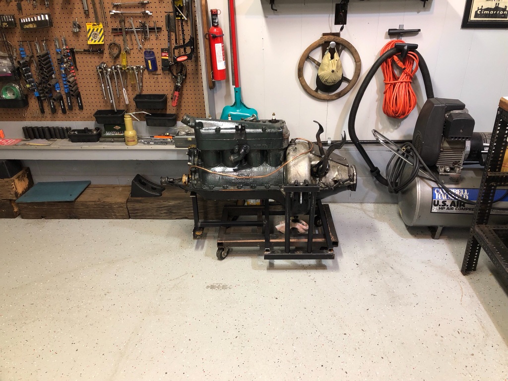

Freshly rebuilt engine set in the frame all that remains to do is everything else......

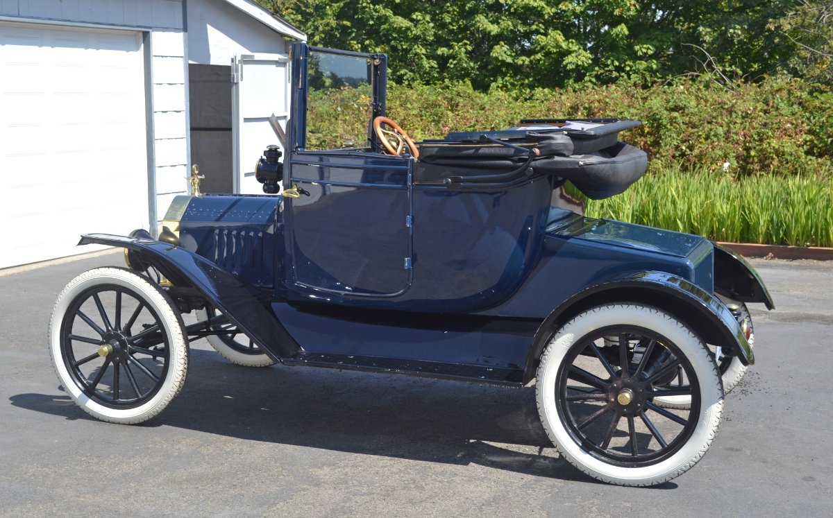

I removed the 1909 sized steering wheel from my 1916 coupelet and installed a correct one, which was given to me by a friend in the Tacoma Model T Club. I then moved the coupelet ahead in the garage, put Stabil in the gas tank, and put the car up on jackstands for the winter. I then drove my 1936 Packard convertible sedan in behind the T. I just painted the Packard body and now have room for painting all the Packard parts that are off the car.

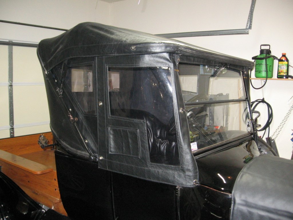

I pulled the side curtains, winter front, and hood blanket out of storage and installed them on Betsy, my 1924 cut-off touring today. :)

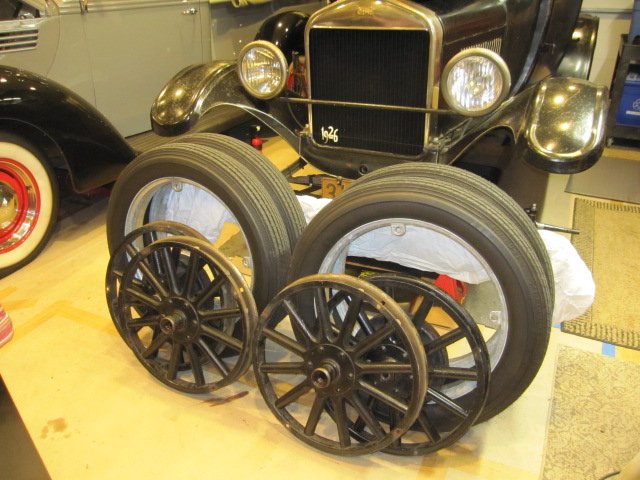

After a nice little 40 miler to end the season, while draining the oil I pulled the tires/hub assemblies getting them ready for paint and then off to Calimer's wheel shop for some new wood.

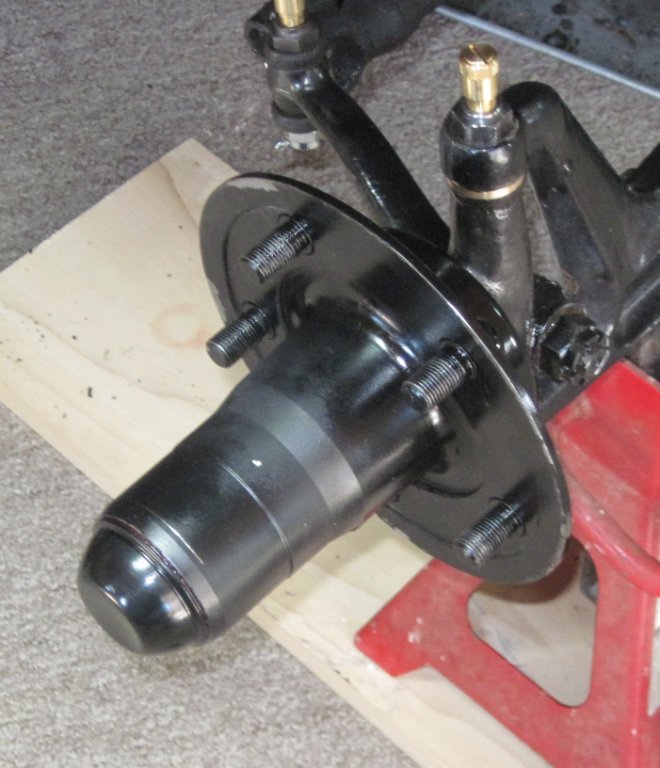

The Model T parts vendors that I called were out of front inner wheel bearings. I dug deep into the bowels of Google and found a bearing supplier in south Florida. The Timken 14120 was listed on their website but they were also out of stock. I called them on Monday and the manager said he would look for one for me. He sent me a text on Wednesday with a photo of the bearing and mailing label with my name on it. He asked if I still wanted it. DUH! It arrived on Friday. I finished assembling my new front axle and I will install it next weekend. The supplier was

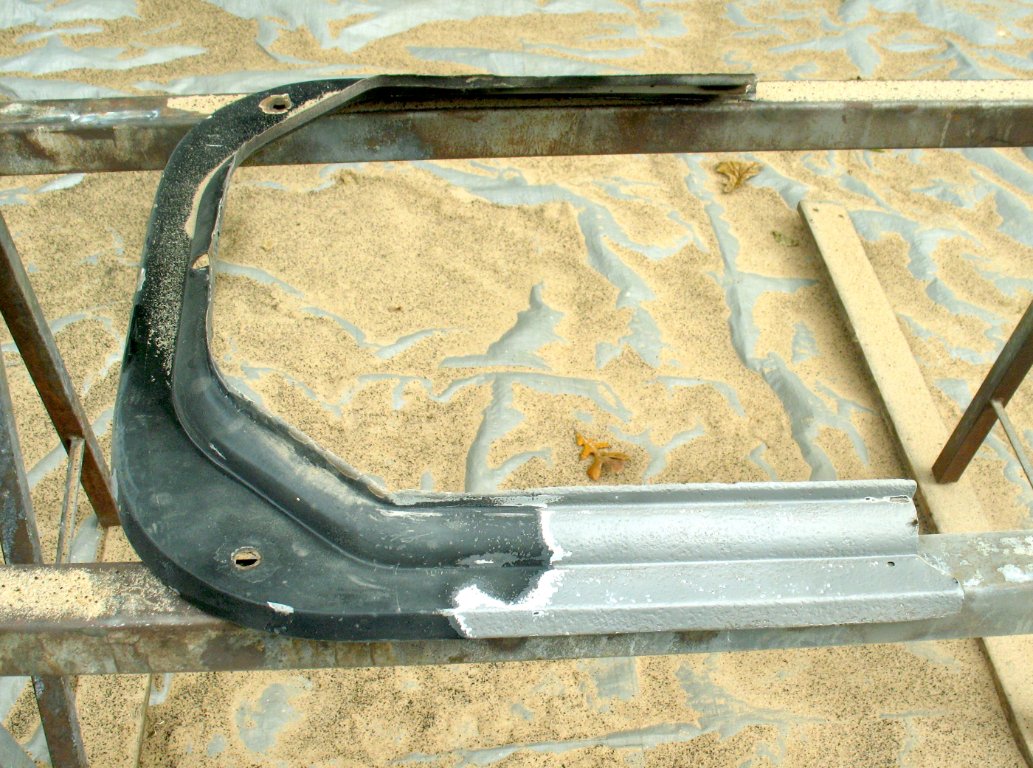

Post by Steve Jelf » Wed Nov 10, 2021 1:31 am
Got started on blasting my hood former. The paint was easy, but the Bondo under it was mighty slow going. I finished about two thirds of the front, and should be done with blasting tomorrow, weather permitting.

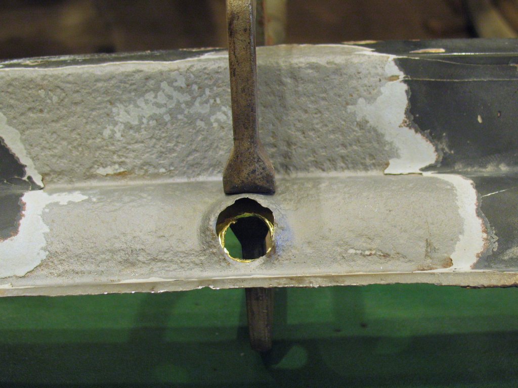

Post by Steve Jelf » Fri Nov 12, 2021 11:37 pm

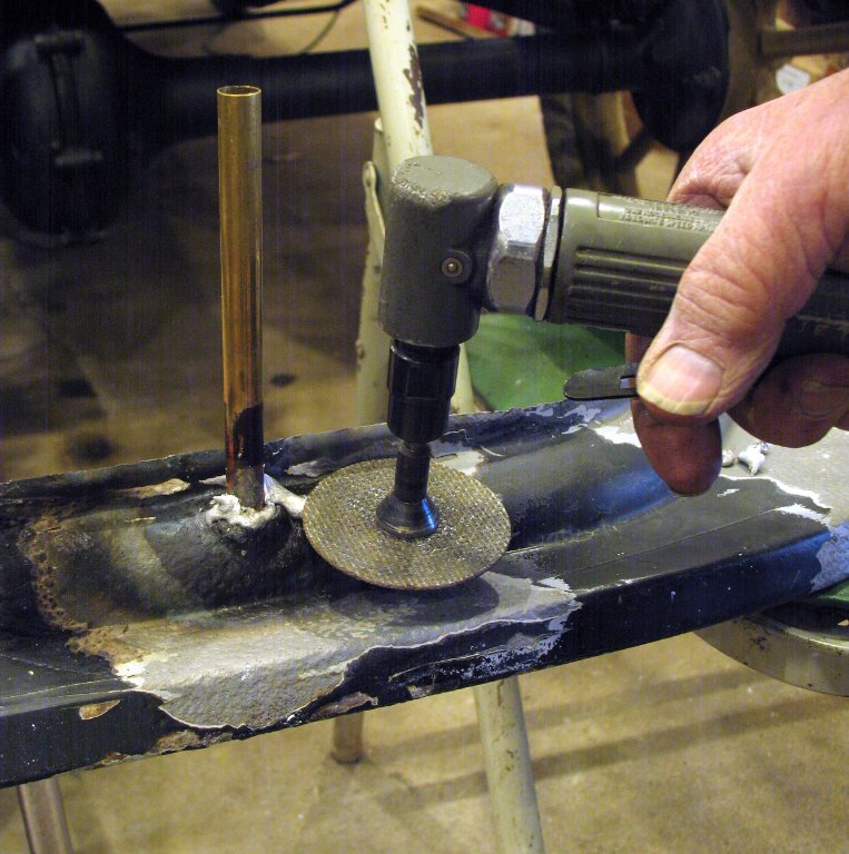

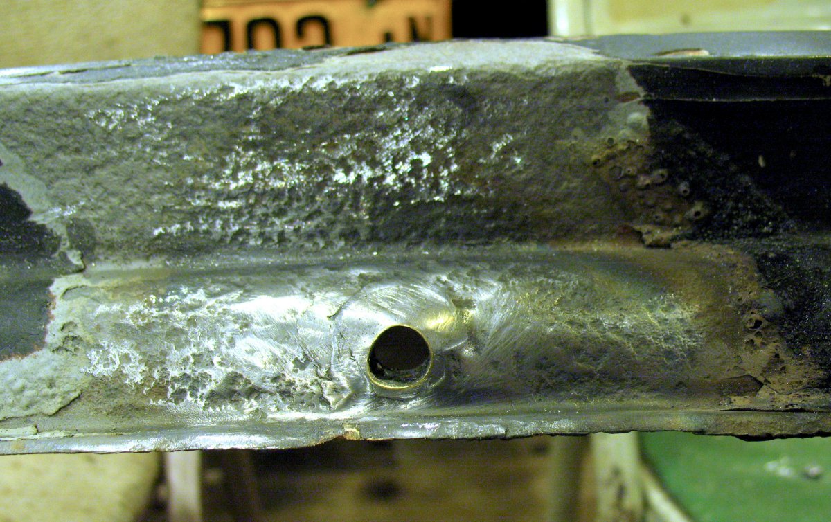

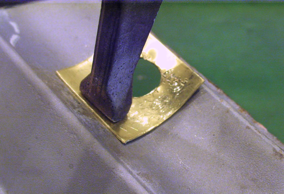

Well, I didn't get all the blasting done on that hood former, but I did finish the top center around the hole for the hood rod. It seems that originally it was just a hole in the sheet metal without any reinforcement, so eventually it got wallowed out through use. I hope I've stopped that from happening again on this one.
The repair starts with a small sheet of brass with a hole in the center clamped on the back side.
You can see considerable space between the brass and the wallowed-out steel of the hood former. That was formerly filled with Bondo.

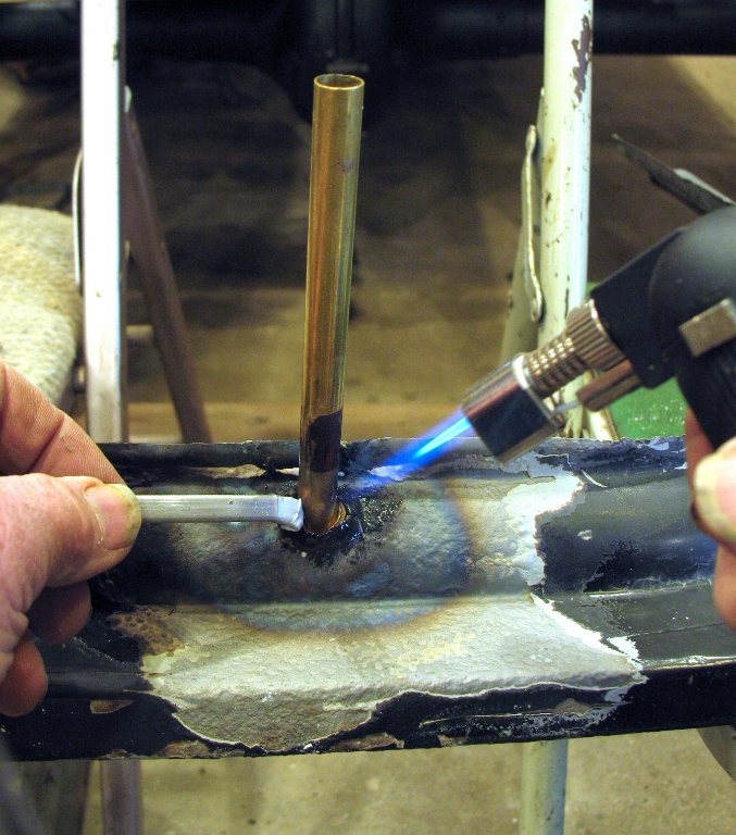

It ain't pretty, but it's in a place that will be out of sight. I''m pretty sure it won't some loose.
The hole is formed by brazing in a piece of tubing and filling in the space around it with body solder.
The next step is cutting off the tube, leaving the hole surrounded by solder.
Posts: 7369
Re: What have you done with your T in November
Post by Steve Jelf » Fri Nov 12, 2021 11:41 pm

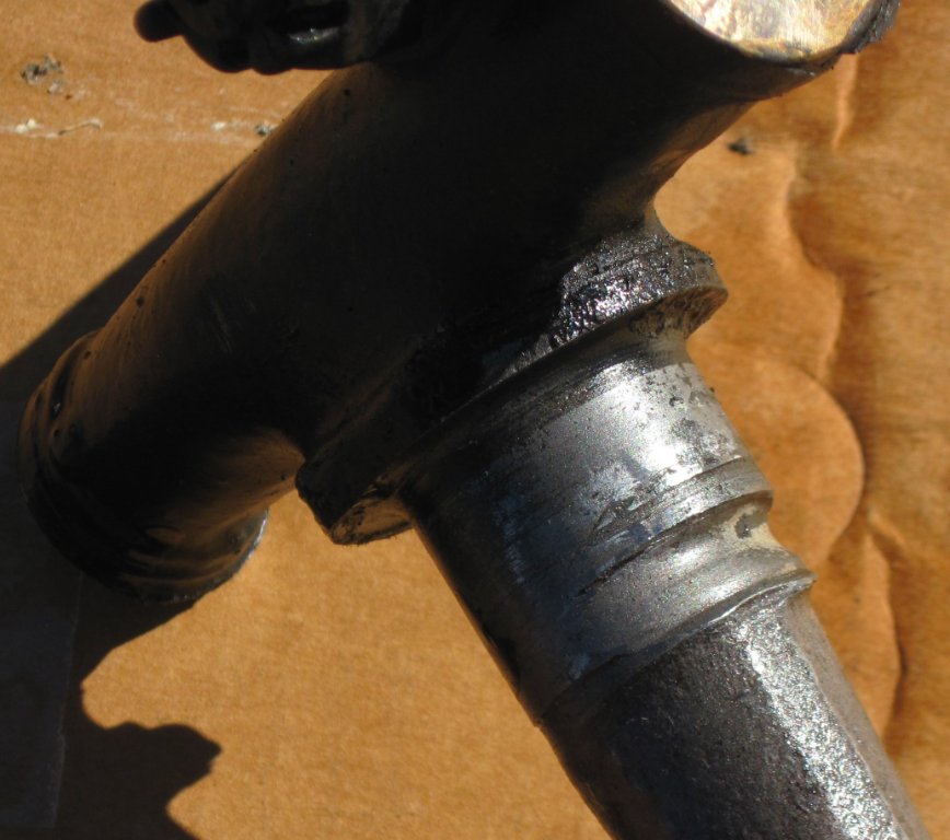

Here it is after grinding and buffing. This poor old thing is beyond orange peel. It's the pits.

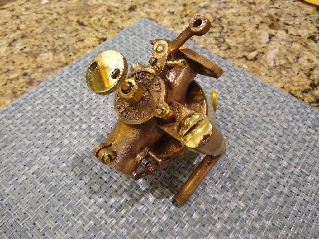

I guess my post should be what did Corey Walker do with my Model T in November. He did a beautiful job of rebuilding the two screw Holley H1 carburetor for our 1911 T restoration project. Here is a before and after picture:

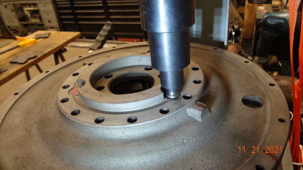

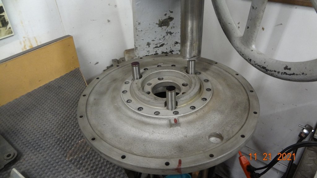

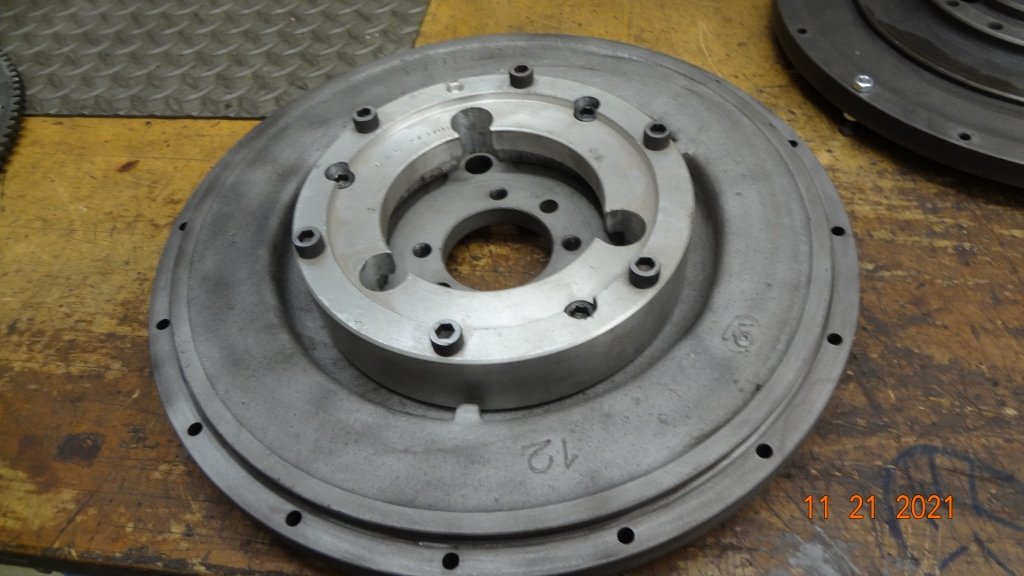

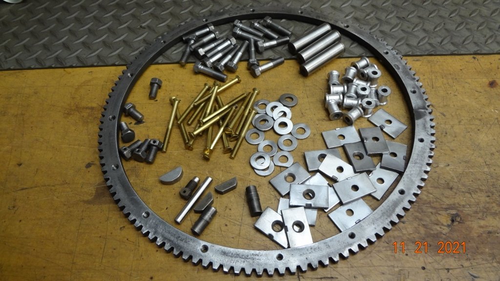

A "T" transmission for a friend.
Picture 1 shows some of the small parts to the transmission puzzle.
Picture 2 is an adapter I made in 2000 to support the flywheel during removal and installation of triple gear pins.
Picture 3 is the pilot wheel arbor press I used to install new pin part way.
Picture 4 I am using a hyd. press to finish the install, making sure the pins are below the surface where the magnets rest.

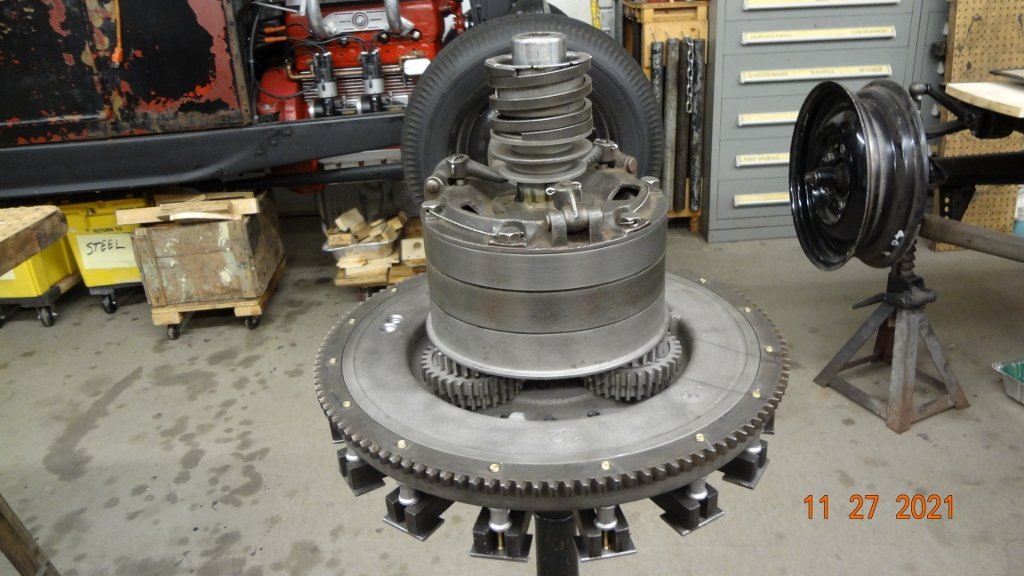

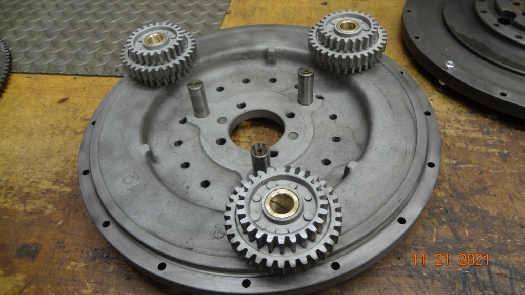

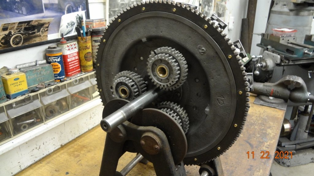

More T transmission for a friend.
Picture 5, new pins installed ready for triple gears. Triple gears with new bushings fitted on the lathe.

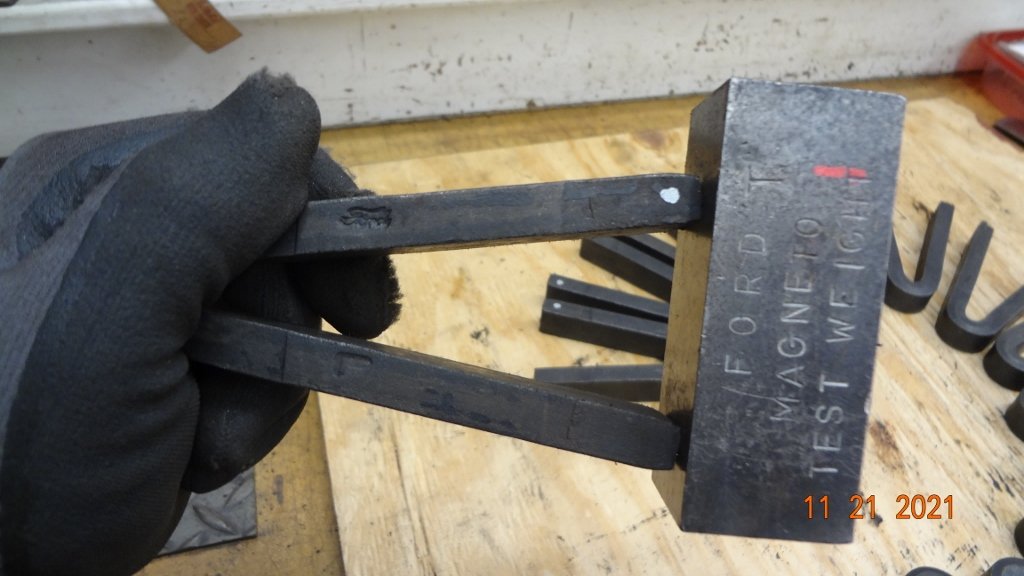

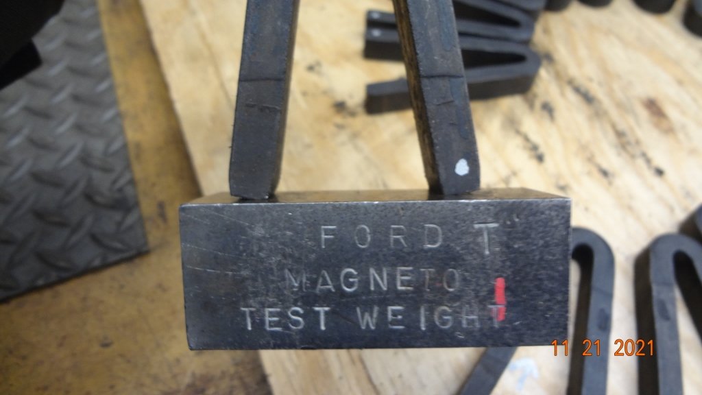

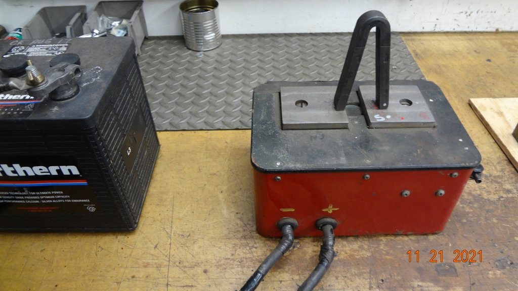

Picture 6 is of an Allen 6 volt magnet charger.
Picture 7 is of the test weight.
Picture 8 is of the final test, this magnet is good to go.

Magnets installed and checked with KRW guage. Also static balance.

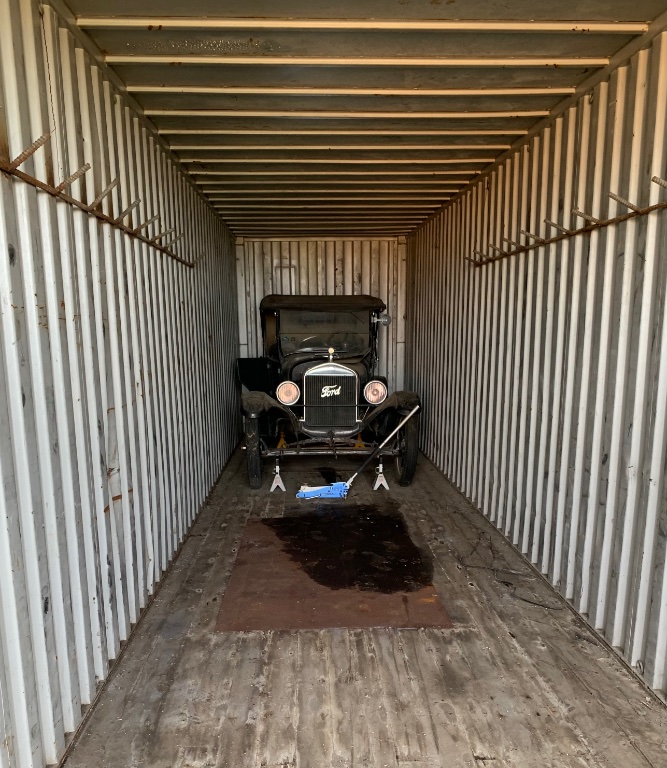

Post by 130nav » Mon Nov 22, 2021 4:46 pm
Pulled it out of a shipping container and brought it home. I also broke the sediment bulb, and drained the gas and oil that had been sitting in it for who knows how long.

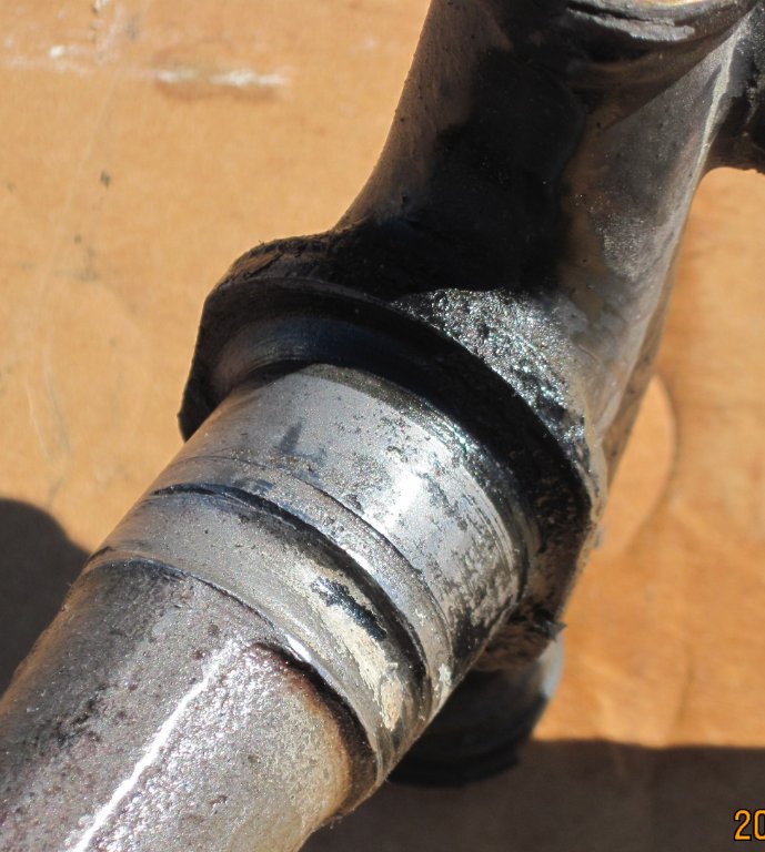

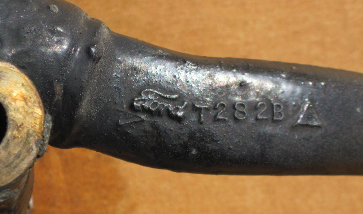

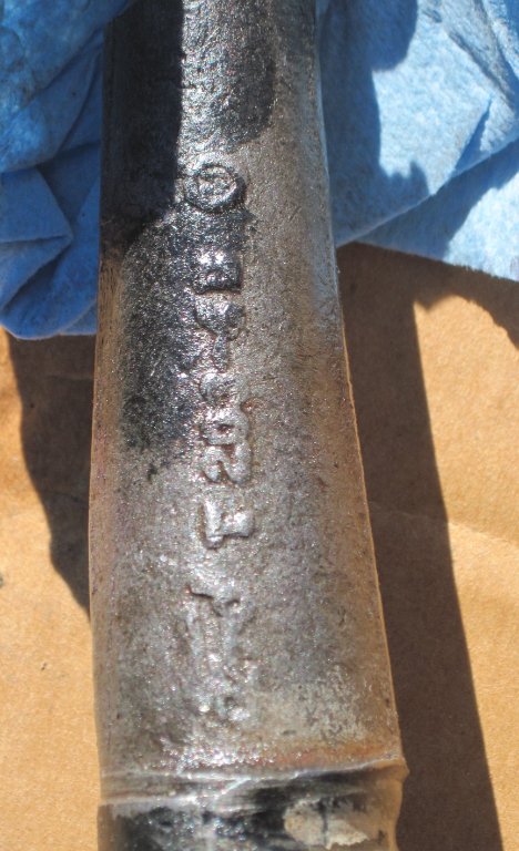

Post by Caswell » Tue Nov 23, 2021 5:48 pm
Started changing front wheel bearings and changing to wire wheel hubs, was all set , cones, check, bearings inner and outer, check. With thanks to a forum member for selling me the inner bearing that have dried up. Passenger side old bearing feel apart when I removed the wheel but was only showing minimum movement until I backed off the hub nut (bearing was old Timken), driver side was solid and bearing is Ford script. Anyway the surprise was the collapsed inner bearing, spindle (pictures below) now in the pile for scrap, other side is good. replaced king pin and bushings on right side, tomorrow I will do the other side king pin and bushings. Did the rear bearings, liners, seals and hubs with small drums a couple of days ago.
Take away from this, if you are told " I did them a few years ago", CHECK for yourself.
Caswell
Posts: 444
Joined: Tue Apr 27, 2021 9:45 am
First Name: Dean
Last Name: Brevit
Location: East coast
Post by Caswell » Tue Nov 23, 2021 5:56 pm
Looks good now

Post by Gary_in_MN » Sat Nov 27, 2021 2:58 pm
Finished. Gary in MN.

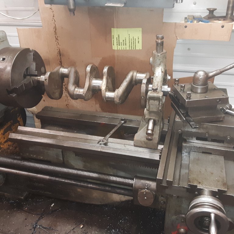

Post by got10carz » Sat Nov 27, 2021 6:03 pm
Shortening B crank to fit a T

Post by KBurket » Mon Nov 29, 2021 7:56 pm
Assembled an L4 carburetor from parts I recently got from Hank Lee thru the classifieds and other parts I’ve had, then went for a test drive. Reinstalled the original L4 then went for another test drive. :)

Post by TonyB » Sun Dec 05, 2021 10:26 pm
Some of wood spokes on my 1924 Coupe were on the car when I bought it in 1976, some 45 years ago and have done many hard miles. One rear wheel I particular is getting very tired. So I made the decision to respoke the wheel. I could have bought spokes from one of our valued supplies but I decided to do them from scratch.
I purchased a chunk of hickory and cut it into twelve pieces.
Twelve bits of wood
Twelve bits of wood

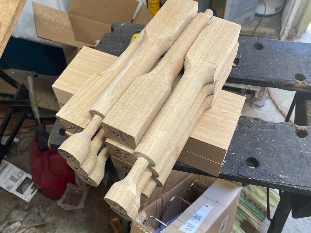

Next was the slow, sometimes boring part of cutting the necessary shape. I made simple wood tooling to get the shape similar on each spoke. I had cut the wood into 12” lengths, so I could make the 8” for 4.5” tires or 9” for the 3.5” tires, so there was a little more waste than I wanted. Never mind, it’s only money. Each spoke took about 45 minutes to cut and smooth out.
Spokes off the lathe

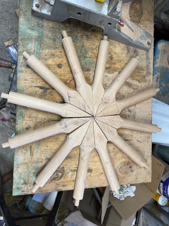

Next was cutting the 15 degree angle at the center of the wheel. Fortunately I found my simple wood fixture that I made when I had the barn in Ramona, it didn’t get thrown out during downsizing. So all I had to do was to adjust the length as it had been built for 9” spokes. Now the twelve spokes should complete a circle.
Spokes in a circle
Spokes in a circle

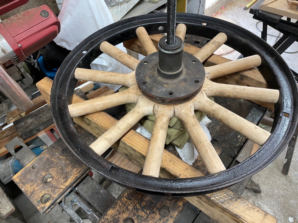

The final step is to press them into the feloe. For this I use a simplified version of the Regan Press, just a few 2x4 and a 1/2” threaded rod. Initially the spokes wouldn’t press in as they were fractionally too long so I trimmed off about 1/16” from the part that touches the hub. The second time they went in with a nice “click”.
Wheel with spokes and hub
Now I have to find a Rocky Mountain brake drum and do a little painting. I’ll probably use the existing drum from the car so the switch over will have to wait until the Christmas tours are completed.
Making spokes almost free hand is very, very time consuming, so I have abut 15 hours in that wheel. However it feels much better than sitting in front of the tv😊
