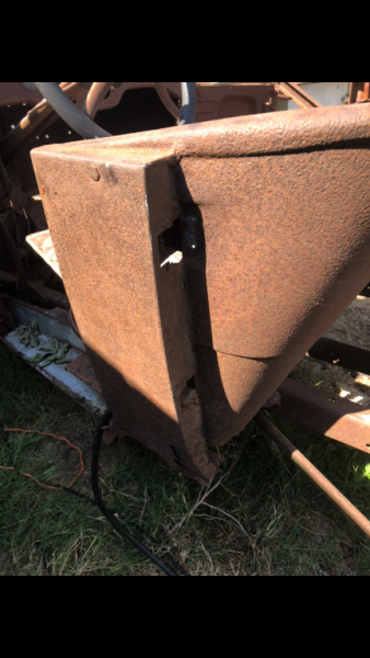

Re: Is a cut touring worth buying ?
The remainings of WWII era cut off touring. Pulled out of north woods near me. Sheet metal was pretty far gone. Decided to make into a cut down Santa sleigh. Didn’t want to scrap so found this as a good alternative and it’s history lives on in another form.
I like cut off tourings and that each one has their own uniqueness.
Enjoy your new Model T truck.

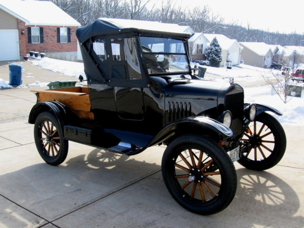

All I know is that I sure like mine...

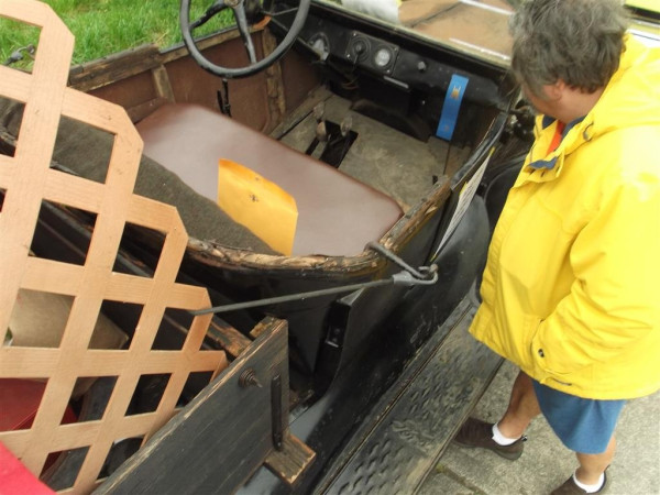

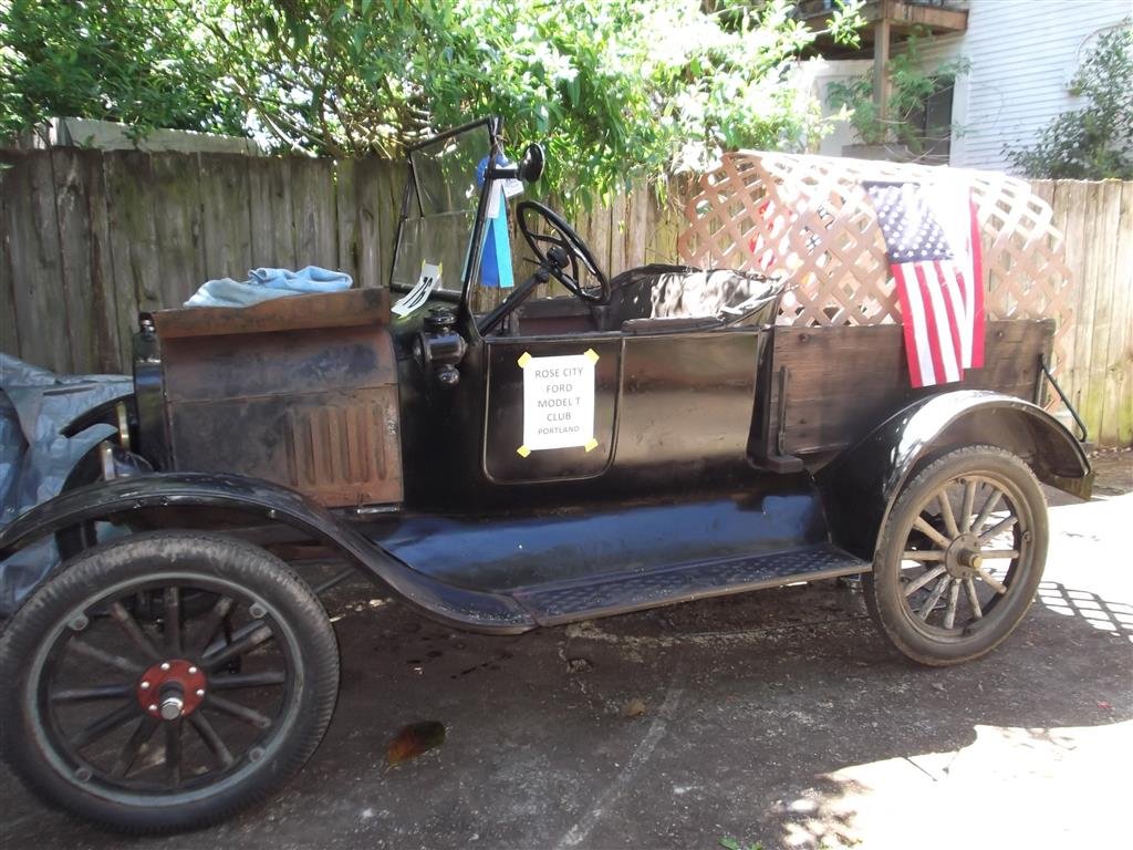

Cut-off always sounds hinky and negative, as the owner of a modified/converted touring truck I say go for it and let it keep it's converted touring look.
The kits back when the cars were new (ish) most times listed them as conversion kits (as apposed to cut off kits).
Also the use of period accessories would not be out of place and limit some negative comments about staying correct (like speedsters).

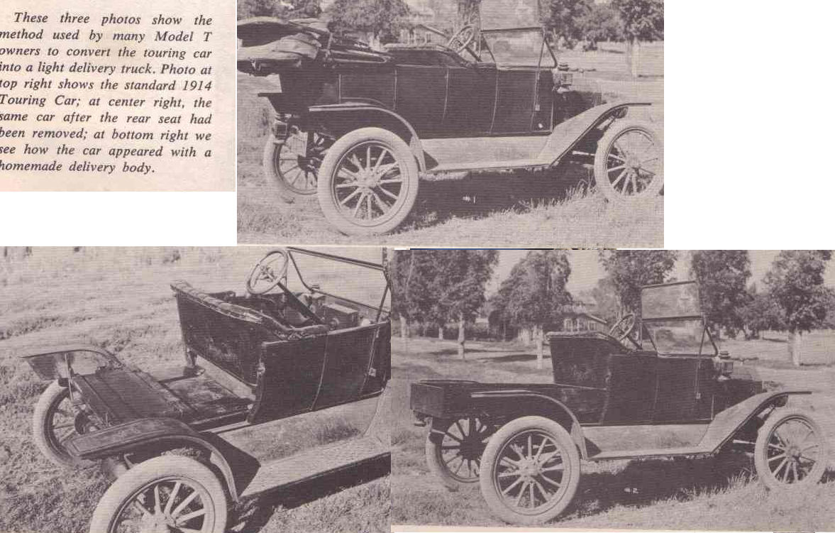

How some did it back then http://www.mtfca.com/discus/messages/80 ... 1241302391
- Posts: 4675
Wow that’s neat to find out that the aftermarket folks were selling kits to do this! I’m fairly knowledgeable about Model T’s but certainly not as much as some and didn’t know about it. I would think a lot of purists might not approve of this!
In a way this makes it sort of officially ‘correct’ .
Which makes me wonder if any of those T’s are around that have these aftermarket kits on them.

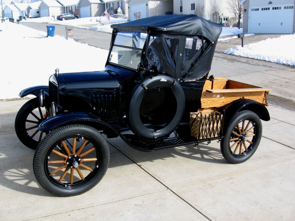

Still working on it, converted touring, for looks I should have kept wood wheels , may sell or trade wires out.

I look very closely at more original era photographs than almost anybody. And I have seen enough photos taken in the 1910s and 1920s to know that quite a lot of touring cars were cut down into pickup trucks in those days. the practice continued for a variety of reasons to beyond WW2.
I have also seen more recent attempts to try to make touring bodies look like roadster bodies. That almost never looks good. And they certainly didn't suffer that indignity back in the days. Cutoff touring car bodies were left to look like cutoff touring car bodies. Once in awhile the sides of the box would be worked into the shape left behind of the touring car? Often it was just left there with a practical box behind it.
The one thing that I have seen, and would recommend, is to move the body to top irons in the body to roadster configuration. Mostly, it is just moving the body irons from by the back of the seat to near the front of the seat. This move is necessary to make the top sockets and bows position properly for a roadster top to fit and function properly. I have seen this in era photos, so it was done that way back in the day. The top makes the vehicle more practical for different weather, and a properly fitting roadster top will look better than a badly fitting butchered touring car top.
CudaMan's photos show how great a cutoff touring car with a roadster top can really look!
Some people think that I am a purist. But I do not think I am. At least, not to the extent that I would think everything needs to be returned to absolute factory specifications. I do think that antique automobiles should be maintained or restored to some era correct status. Whether speedsters, custom delivery trucks, or simple cutdown pickups. I like them to appear as they would have at some historic point in their existence. And a lot of model Ts were turned into pickups when they were only a couple years old, simply because a light duty truck was needed. And that is as much a part of model T history as the most flawlessly restored model T ever. No, the cutdown pickup in its "work clothes" is a bigger part of the model T's history than almost any show car. The car was only brand new for a day. It was a workhorse for a decade.

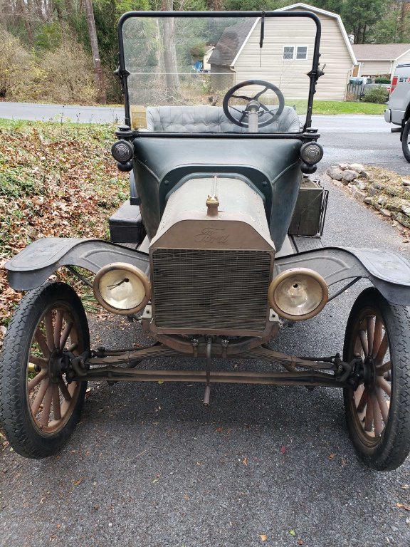

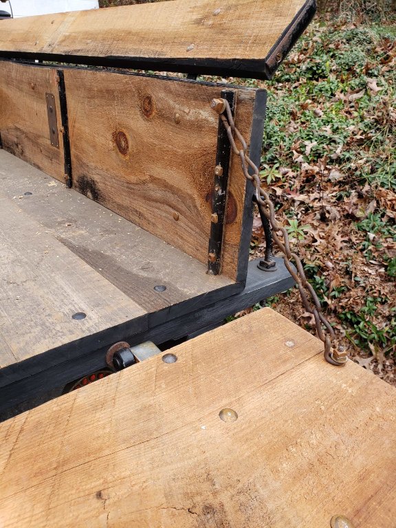

Dad and I worked over the last 2.5 years to turn my 1915 cut-off touring body into a nice 'farmers special'. In the process I've gleaned hundreds of photos from here and elsewhere of folks who did the same thing. Lots of precedent out there when you look. Some done with craft. Some thrown together out of necessity.. We really are pleased with how this one turned out, but if course are biased since it was our project. I'm taking it for a spin this morning. As Dallas said, these little RPUs are a blast to drive!
Here's a compilation of my build posts for reference.

when you first posted your plans, and what you were starting with, I was skeptical as to what would come out of the effort. With that preface, I've mentioned before and will mention again: you and your dad did a superb job in putting your car together. Before seeing your final result, I would never have believed that I could be envious of a "put-together", but I am. Bravo, sir!

Haha. Thank you Scott! Dad is a great craftsman and I learned alot from him. We also poured over the photos i collected and decided what we liked and what we didn't like and tried to use that to guide us as we worked. I'm very happy with it too. Looks old without (much) fake patina. Just trying to show an example of what can be done with a cut down if you take your time. Makes me proud of our work that you get a kick out of it!Scott_Conger wrote: ↑Sun Dec 19, 2021 10:13 amDan Blayton

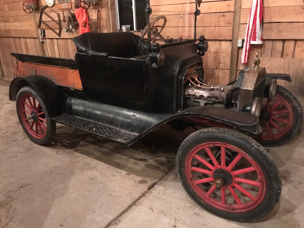

This is my barn find 1915 pick up. The minute I came across her I fell in love! It’s like a speedster, some correct some not. Way cool and fun.
Delightful indeed! A '15 has some of my favorite things on it. That has to be a lot of fun.

That's a great car! I know the feeling.Brent Teltow wrote: ↑Sun Dec 19, 2021 7:03 pm4157386B-2225-44A9-A4FF-597F4D850CDE.jpeg
