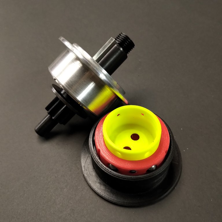

We are working on something kinda neat. Not period correct but very convenient. (click on the GIF image and it should play kinda like a video.)

New product coming to market? Interested, More details.

Designed and machined for our own use. As a stealthy alternative to a fat-man wheel.

Could you add a "safety pin" in the collar to prevent the accidental removal of the wheel. I think that might change its definition ever so slightly from "quick release" to "easily removable" How is the release collar connected to the steering shaft?Flivver wrote: ↑Sat Dec 11, 2021 11:13 pmQuite right! I designed this specifically to Not move the wheel closer to the driver; it's very close already. I also wanted something that used the original steering wheel unaltered, and was stealthy and hardly noticeable.Craig Leach wrote: ↑Sat Dec 11, 2021 9:32 pmit dosnt seem to move the wheel adversely closer to the driver like the FatMan adapter does.

Interesting idea! I'll give that a think....

How about sharing the prints, if you are not going to produce them?

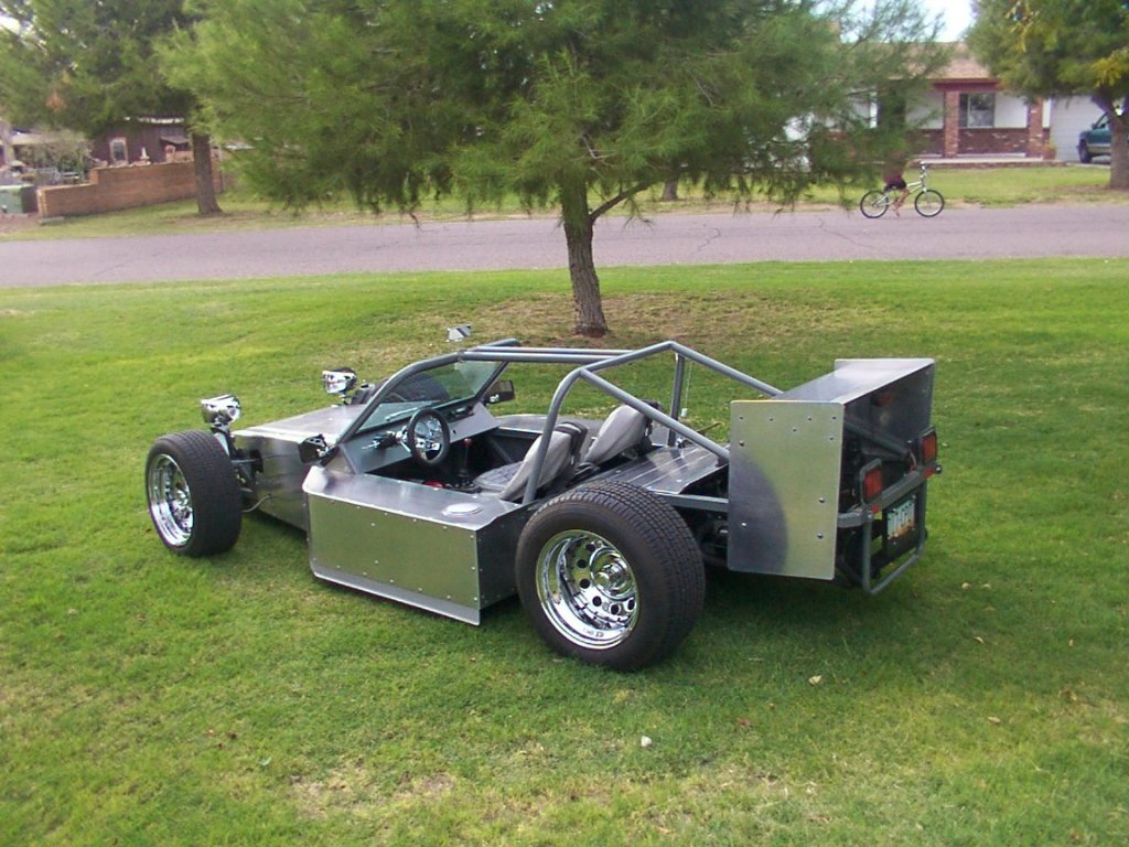

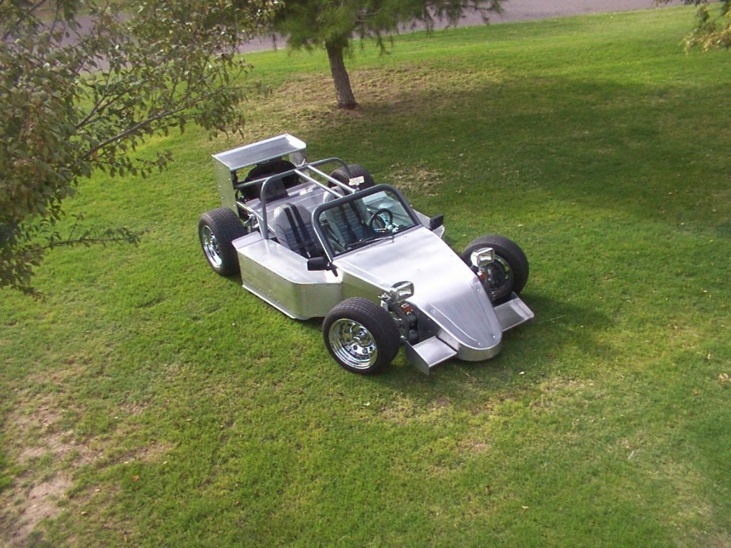

In 1998 I built a sports car with a ramovable steering wheel because you did not get in the car you put it on. The car has changed hands many times and last I talked to a owner the steering wheel was never a problem. You do get a real big reaction from a unhappy passanger when your say if you dont like the way i drive you do it and hand them the steering wheel! I have thought of it many times but I'm not as creative as some. My hat is off to Steve.

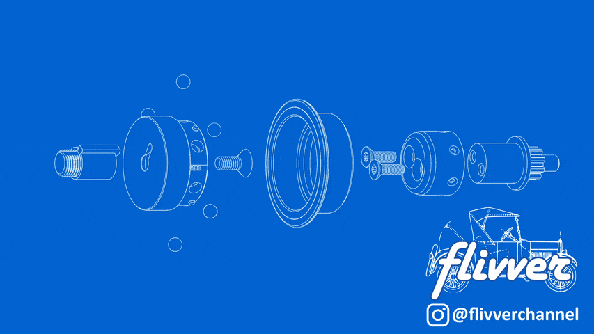

Here is a little more info on the Removable Steering wheel design. (click on GIF for animation)

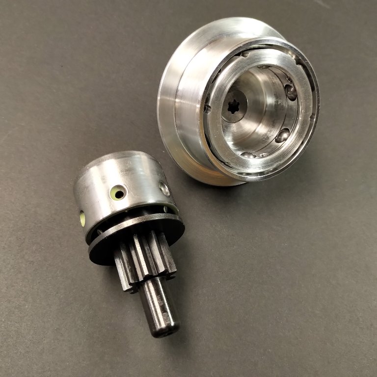

Topic author - Posts: 210
- First Name: Steven
- Last Name: Park
- Location: Paris
Re: Removable Steering Wheel
Raw, unanodized parts for trials, with the working prototype 3D-printed predecessor prototype.
