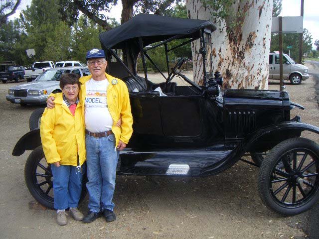

It looks to me like the correct year, however, looks like the rear two bows of a touring. The Roadster center bow would have two circular notches for the front bow. The upper one for using when the top is up and the lower one for hooking the top bow when it is folded down. You can see the bottom notch on the driver's side.

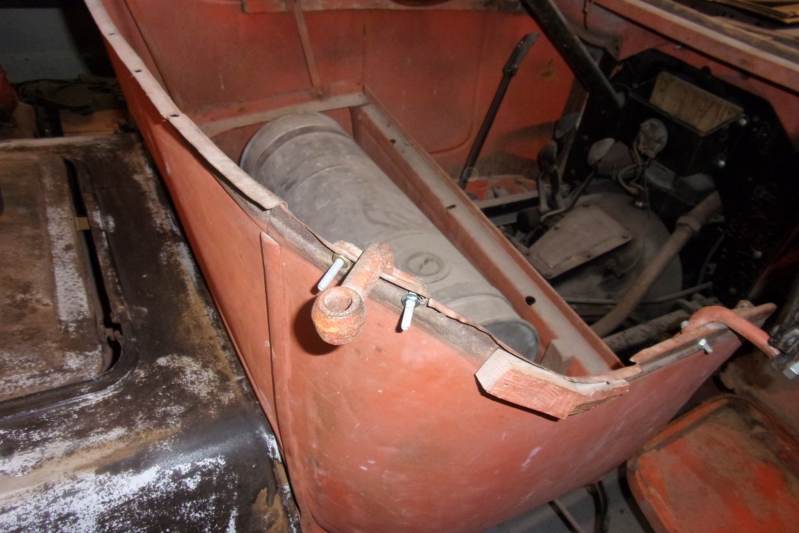

On the back of your body, right where the seat is to be tacked, you will see a bracket with a hole in it. There should be a bent rod with a nut on one end, which the rod goes through that bracket with the nut on top and the rod at right angle to the body. The saddle then slips onto the rod. The bow just lays on that saddle when it is down.

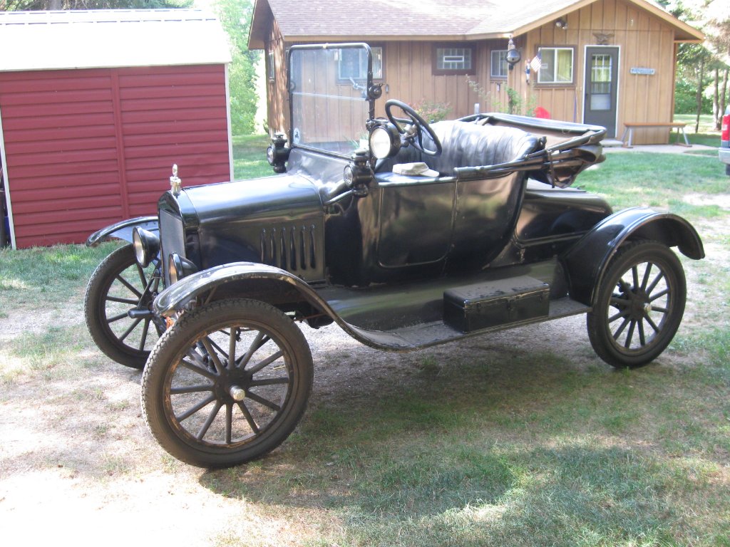

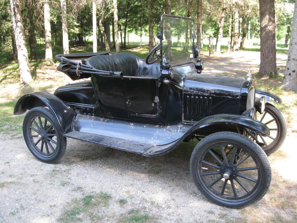

These are the only photos on hand of my 1920 Runabout that would show the top bows;
