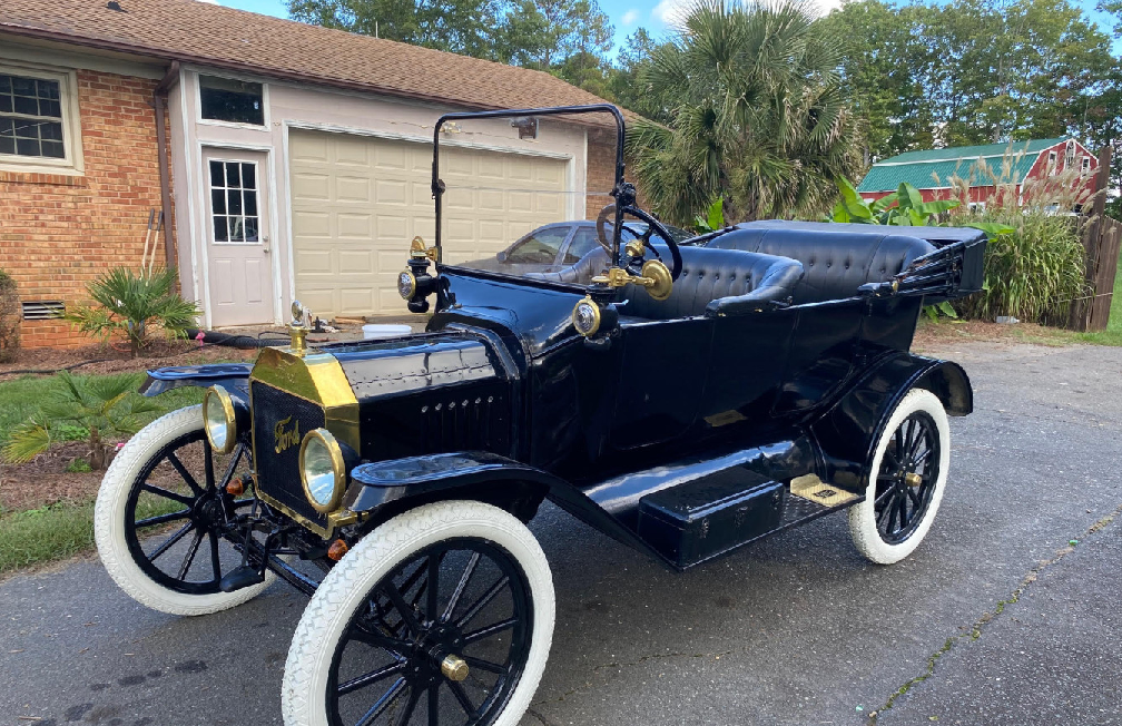

I decided to try painting some old black tires with white rubberized paint just see how it would hold up. Has anyone done this in the past? I am not sure why the photo shows up so small but if you click on it it will open up. Thoughts and opinions welcome

Thanks Wayne
The photo is a few weeks old taken just after I got the wheels back on my 1915 Touring. I expected the threads to turn black leaving the low spots white and they did after about 50 miles but in my opinion it just looks like I drove through fresh black top. I will try to get a photo of what it looks like now when it warms up a little in the afternoon. Flaking is a concern but I used Plasti-Dip rubberized paint after giving the tires a quick sanding. After the Plasti-Dip dried I gave them a coat of Krylon mat white as Plasti-dip would quickly turn yellow with UV exposure. From what I researched the Plasti-Dip should help with the flexing/flaking problem but time will tell.
I had good thread on the tires but they are old and had sidewall cracking so I decided I had nothing to loose with trying the white paint. That said I am sure I will replace them if the rubber starts to deteriorate. If the paint holds up I plan on buying some Black Ward Riversides and painting them White as well. I like the White look but they are asking almost twice as much and people say the white tires do not last as long.

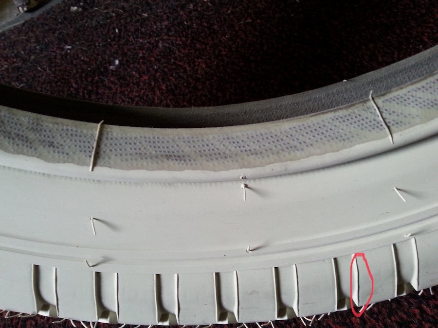

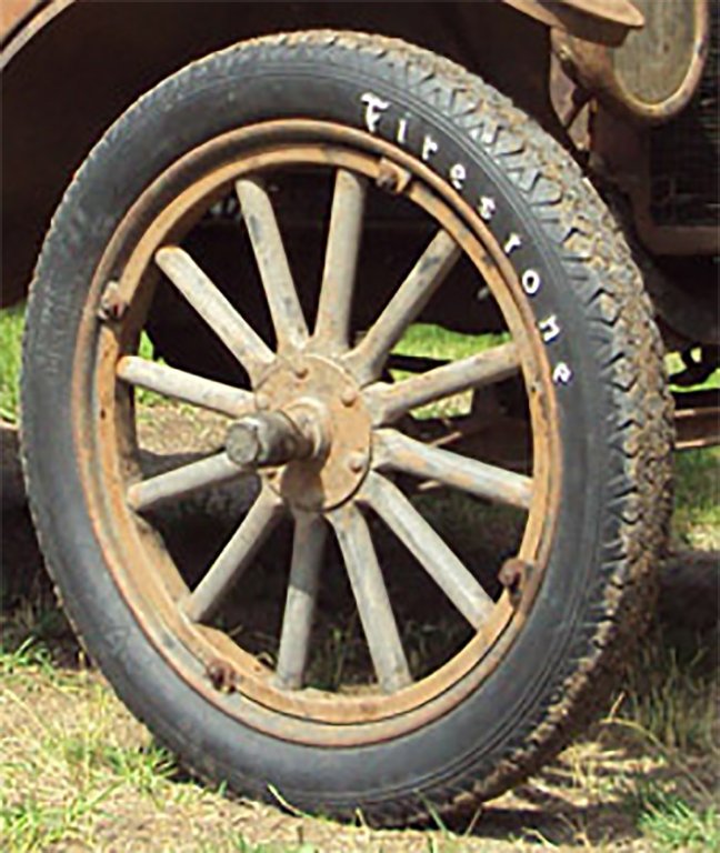

Might as well get back on my white tire soap box again...take a close look at the bead on this picture...this was from a set two years ago, and my latest set this year look the same, even though a different production date on the sidewall. Now, I swear this so-called "white" is PAINTED on somehow. Its a different white from the rest of the casing. Even the jagged edge to me is tell-tale. Unless someone can prove otherwise, I'm sticking to my story!

Ron, keep us posted with pics and comments. I will get one more season on my '13 whites, then I have to decide. So far, no white tires are in existence. I used to say I wouldn't put white tires on her, but then I weakened and saw how nice the car looks. But tired of the cleaning, and the subsequent yellowing despite special tubes and low life, and of course the price!! I've thought of painting too, but never thought of Plasti-Dip first. Sounds like a good idea.

I first decided to paint my tires white when the tube in the right rear tire went bad and I had the tire off the rim. I can tell you from experience do not paint the tires off the rim as they will crack and flake off when inflated and I needed to redo the right rear.
The remaining three were painted on the rim and inflated to 65psi. I sanded the tires by hand and made sure I had a good surface to paint. I then put about three coats of Plasti-Dip. It might have been 4 but I used one can per tire and did not put it on heavy as I did not want it to run. The tires did not look white after the first coat so just give it time, put on light coats, and allow it dry between coats. My tires are old and cracked so they just sucked up the paint....I would expect to use far less paint on new tires. I then put two coats of Krylon mat white paint. I am sure any brand would be fine but make sure its rated as fabric paint with UV protection. Fabric paint is more flexible than standard paint.
The Plasti-Dip is designed to be removed and people use it to paint modern car rims with......When sealed with Krylon the Plasti-Dip will not yellow and it is no longer removable as originally intended.
People have been using this method to paint on white walls for some time now and they hold up rather well. When painting 100% of a tire just be ready to see black quickly return on the treads. I view this as "Poor Man's white Model T tires" lol :lol:

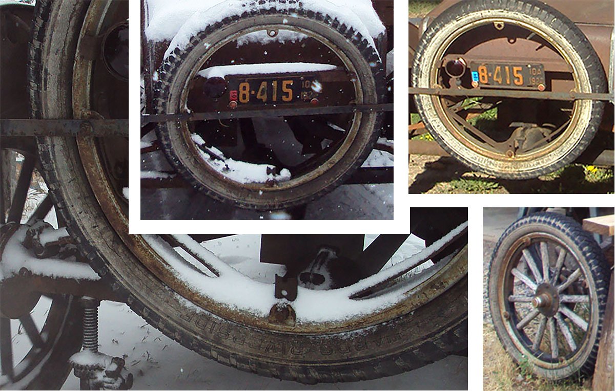

Below is what my tires look like after 60 miles of driving. As expected you can see the black on the treads but I still think they look much better painted. If they continue to hold up I will paint a new black set when the time comes to get tires.
1967
1966
Posts: 3743
Last Name: Wrenn
Re: Anyone Make White Tires at home?
Post by TWrenn » Fri Nov 05, 2021 8:04 pm
Holy cow! They look great! Who gives a crap if the treads are black? The rest look great, and like I said earlier, the black
tread is testimony to a guy who enjoys DRIVING his car, not letting it just sit and look at! Good for you! I'll try your technique.
Thanks for sharing.

Thanks for your comments but remember it's only been a few weeks and 60 miles. If you have an old set of black tires by all means go and try just be sure they are mounted and inflated. As for trying this on new tires I would recommend holding off till I get more time and miles on them. Remember I had nothing to lose as my tires are very old and have sidewall cracks. If you expand my photos you can see the cracks but I assure you so far the paint has not cracked at all. I would be happy to send updates if you like. My plan was to see how they do every 100 miles till at least 500 before I would call this a success.

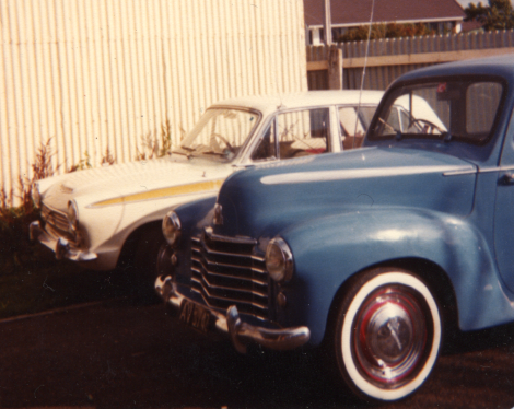

Apologies it's not a Model T, but here's a near 40 year old photo showing my Series L Vauxhall shortly after I painted the rims and 'whitewalled' the tyres with standard acrylic house paint.
It worked surprisingly well, and as I recall did not require a lot of touching up over the time I had the vehicle. I rather think I was trying to impress a young lady at the time (oh those red rims!), but it was hardly a 'chick magnet'. That said the young lady still talks to me occasionally, albeit an island removed, but the whitewalls have never been a feature of the conversation so YMMV :mrgreen:
Oh, for those in the U.S., at least the car behind the LIP is a Ford - a 1965 Mk1 Cortina 1500, of which one could tell a lot of stories...
